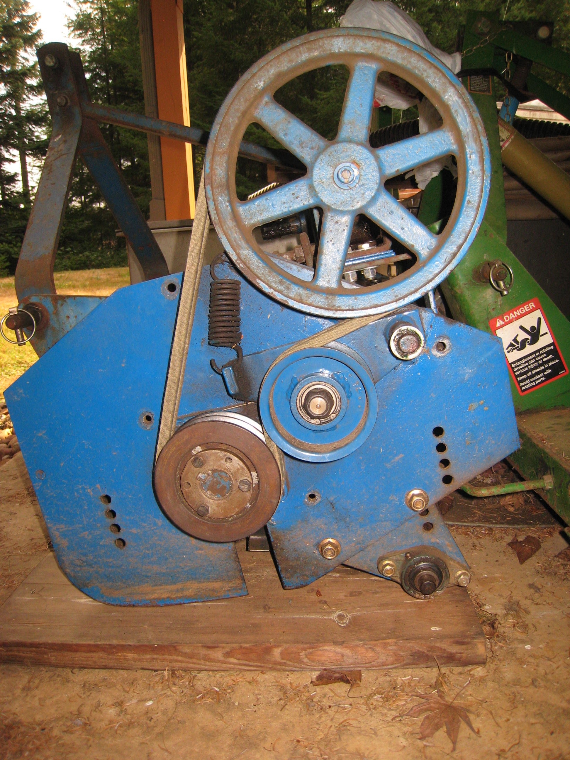

Sounds like this model mowers do not have belt idler, like for example the old ford 917L Special does?
It does add to cost of building a mower, but it sure helps to maintain belt tension.
Too bad Ford got out of the tractor business, but I think most of us can figure out the reasons why...

Yes! An idler increases the belt wrap both driver and driven sheaves see. In addition, a 'sprung' idler maintains the minimum tension required for hookup regardless of load so is easier on bearings than a fixed/adjustable idler.
The drive above (with large diameter sheaves, sprung idler, etc) is textbook for long life.

I wish my Ford 917’s idler pulley was spring controlled like yours is!
