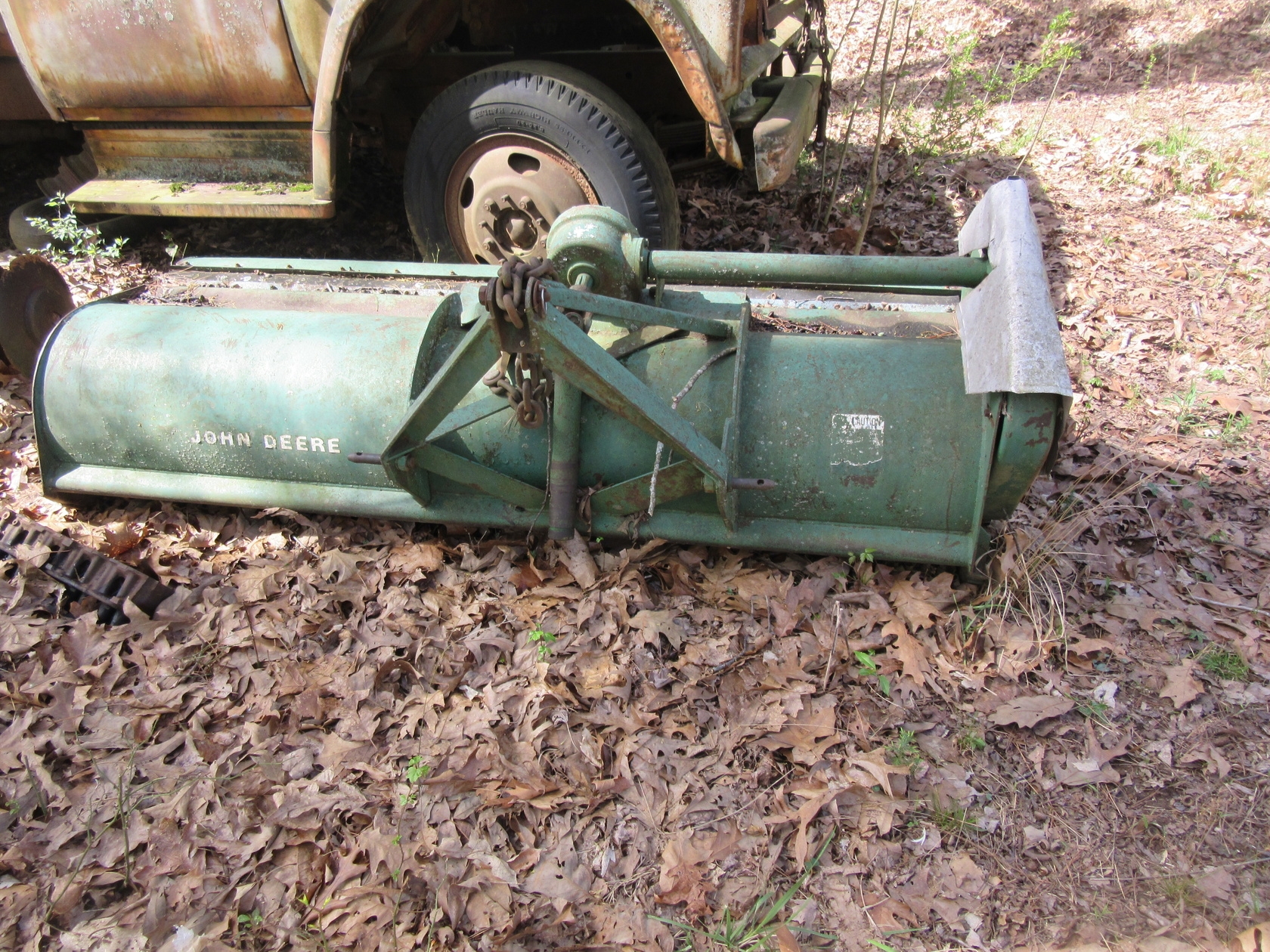

Hey y'all, looks I just joined the flail mower Nation. Just bought this at auction on a whim. It looks to be in ok shape, but I won't know until I get it home just what needs work.
Can anyone identify it from this pic?
Thanks for any info.

Hello Johnnyvol,
If it is the model I think it is, it is a John Deere 7 foot cut model 25A flail mower.
Parts like V belts and knives and bearings are still available so no worries there.

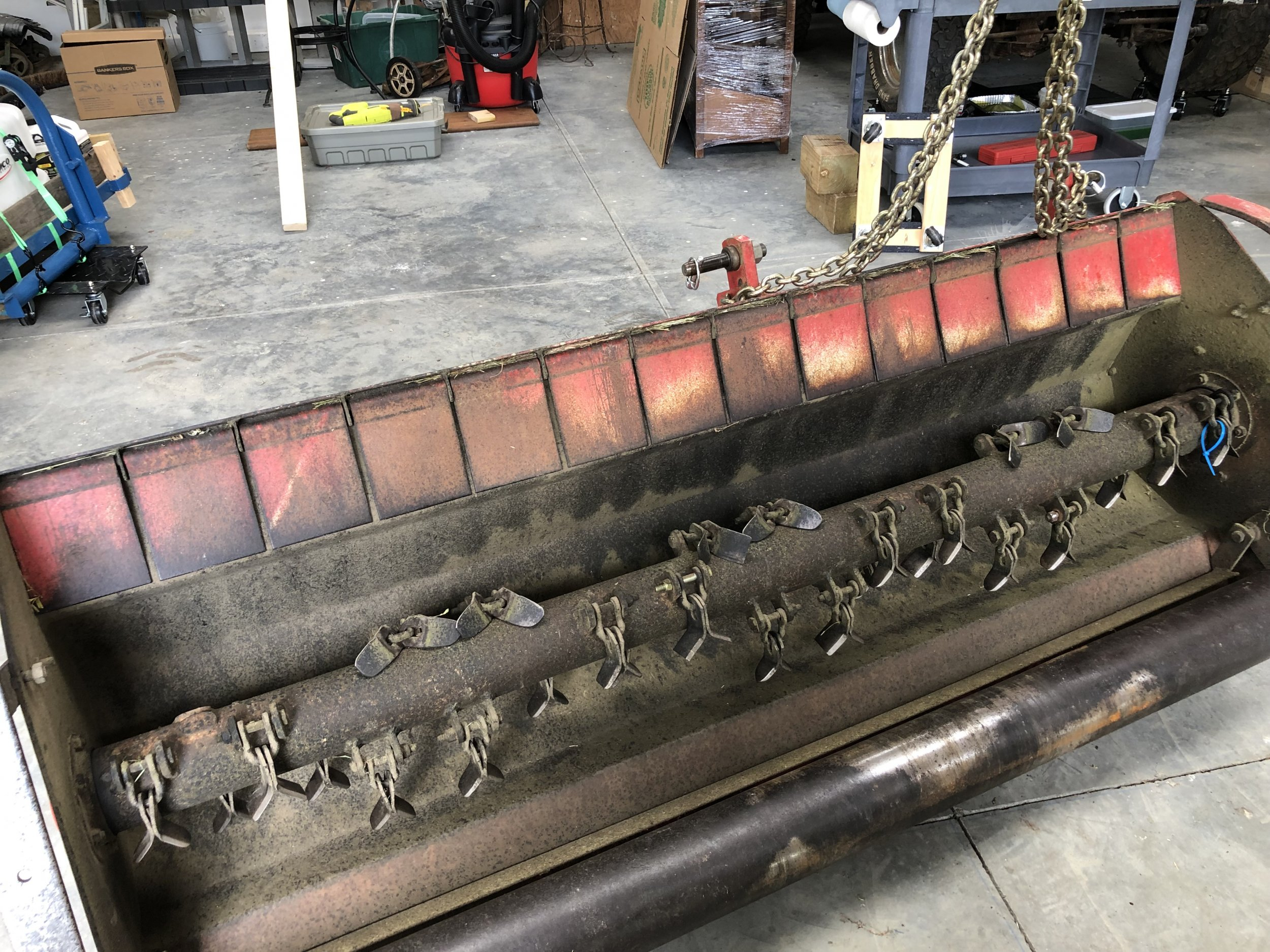

Time to sharpen all the hammers on my mower - Going to figure out an easy way to do this with lying on the ground. Initially thinking of lifting it with the bucket and a chain.
Hate to repeat a post i just made, but the Land Pride FM2560 (of which i ain't bought one yet) manual says, don't sharpen the blades. Also, don't replace a single blade if you break it, for fear of unbalancing the rotor, buy a whole new set. Sounds like they want to sell some blades!

I have big 3 inch wide hammers. I replaced the whole set after the first year. Now I'm just sharpening them. 2 or 3 times so far. The result is no noticeable vibration. Just improved cutting.
