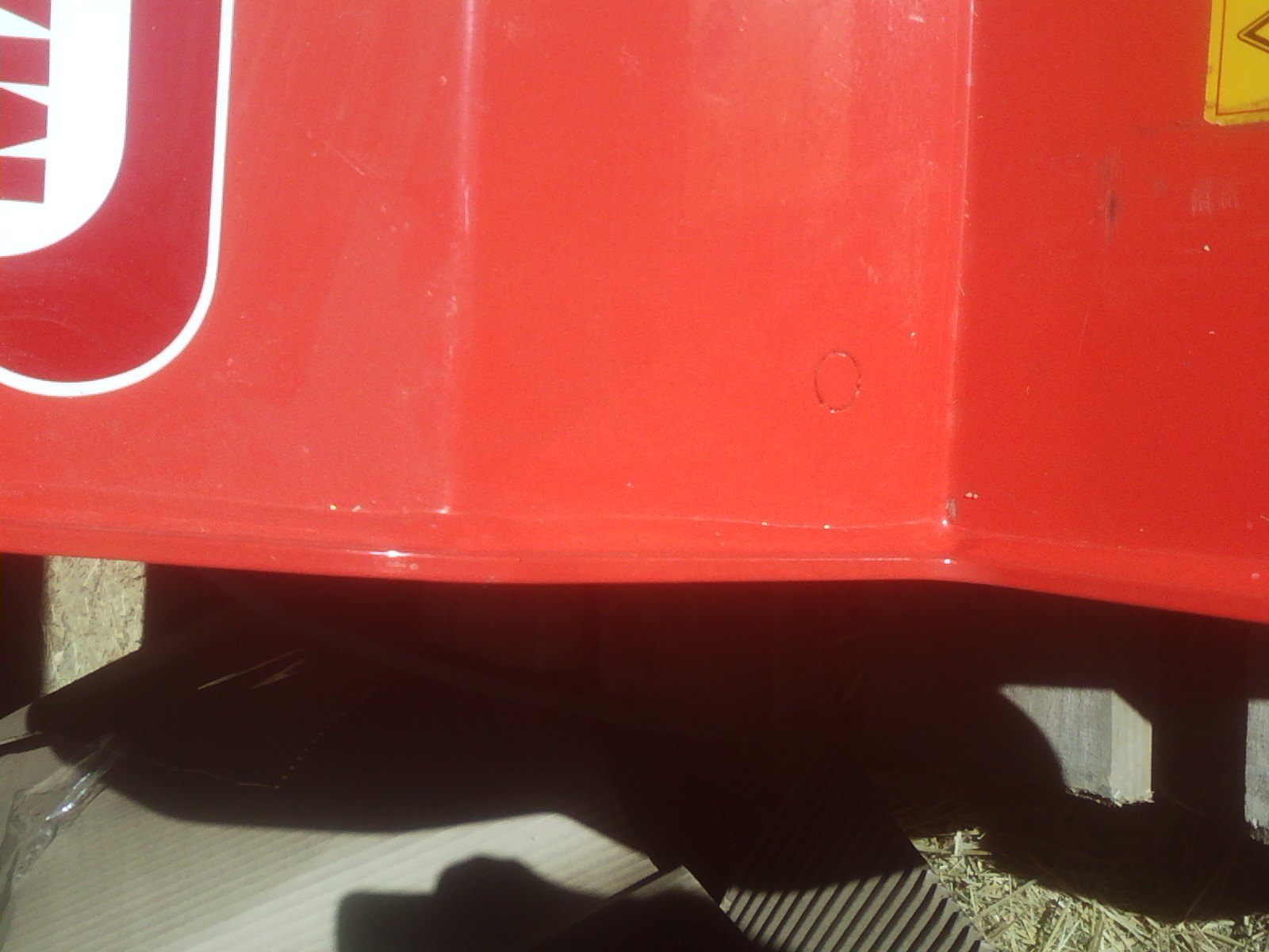

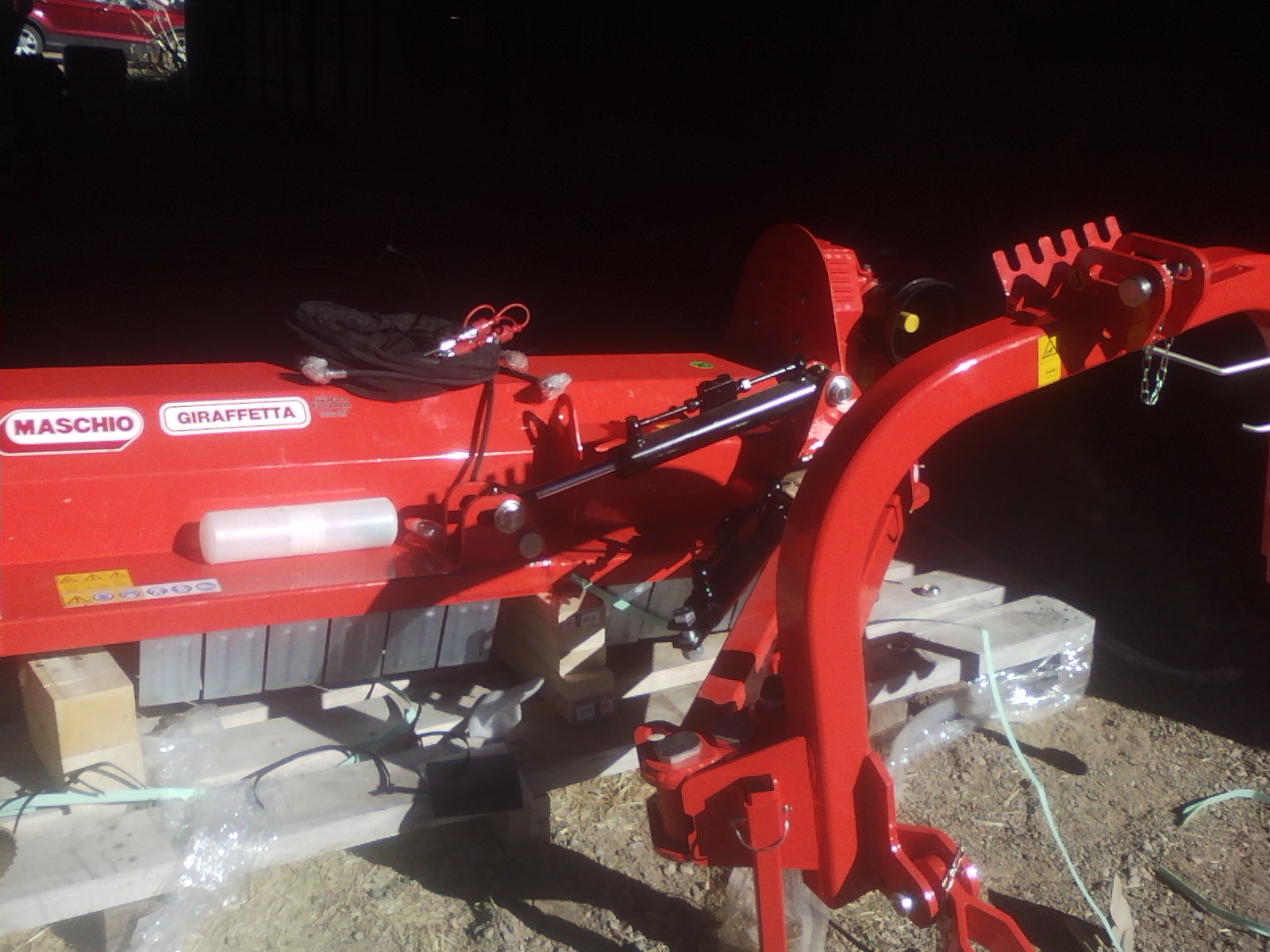

I jut bought a Ironcraft FL-165 to cut about 7 acres of overgrown pasture. It has been so wet this summer in Maine, haven't been able to cut with my bush hog. Bogs down the tractor. Flail came with hammers installed but also came with Y blades. Should I change blades for first cut or just go with the hammers? The grass is about 5-6 ft tall and very green.

You bought a 6ft ditch bank mower but don't say the tractor HP you have. Y blades are best for grass IMO - they leave a clean cut going thru grass like butter! You may get some stems showing pending the type of grass you have and if like mine having lots of weeds I get some but not many unless I wait to long to mow. The wheels flatten down the weeds but the mower sucks them back up for the most part before cutting. Nice looking mower BYW-

I believe that your mower will not be able to handle growth of that size. It looks to be a light duty unit.
From another mowers manual "
The cu􀆫ng height can be set for longer grass by simply raising the hydraulic li􀅌 arms on
your tractor or/and by adjus􀆟ng the rear roller and skids on the machine to increase or
decrease the blade clearance as required [ see sec􀆟on on adjus􀆟ng the cu􀆫ng height].
The working speed of the machine should always be at a walking pace, depending on
the working condi􀆟ons. Overgrown grass and weeds should be cut at a much slower
pace for the best cut and to avoid any damage to the mower"
Some of the more heavy duty mowers have recutters that can be raised and or hear hatches that
can be opened to allow material to exit the mower faster.
Good luck.

LouNY makes good points, I think it remains to be seen pending your type of grass pasture, the size of the tractor, and how you set up the mower. Were you able to discuss your situation before buying the mower, did the dealer help you make the choice? I have cut grass taller than my tractor hood but have to mow slower than normal. Once cut though it became very easy the next time when much shorter.
Kubota L3901, 36hp at PTO
