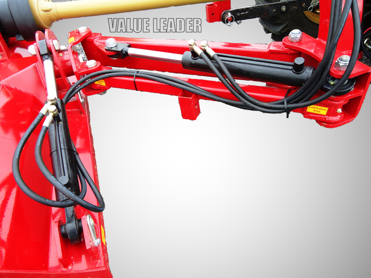

The Caroni flails with the hydraulic offset available from Agrisupply would be a good fit for you and your Kubota. Hammers will tackle light brush much better than the grass"Y" knives and the hammers will leave your pasture in good shape similar to a good rotary cutter.
Flails also won't eject missiles like a rotary cutter will so, you are less apt to put a hole in a barn or take a windshield from a vehicle.
Lastly, the hydraulic offset is awesome for mowing ditch banks and around ponds!

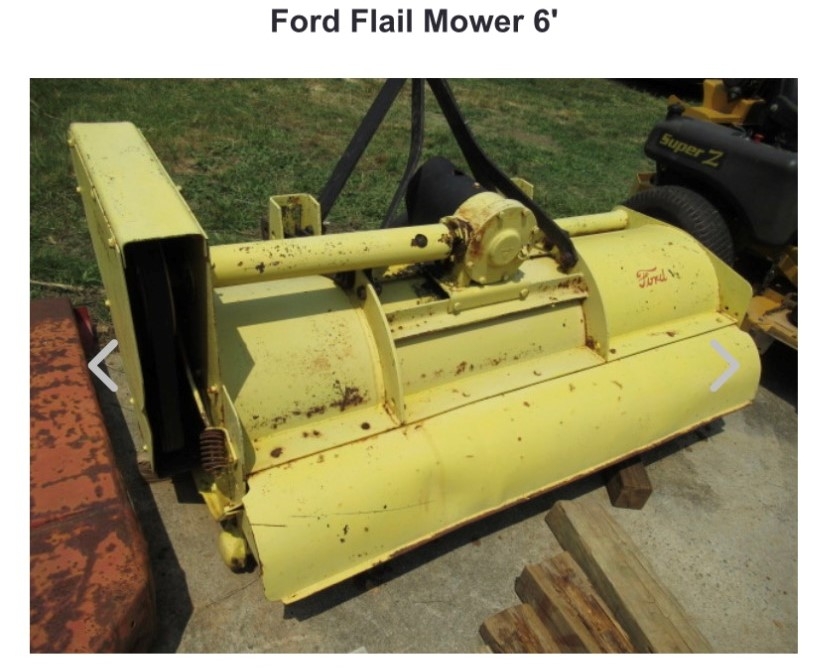

Hey guys, any information you can give for this Ford Flail mower? Its at an auction this weekend and I'm interested but I believe its to big for my tractor. What's the HP specs for these?
/ Let's talk flail mowers #7,852
Looks like a 5’ Ford 917.
I have a 74” (actual cutting width not overall) and I have a TC45DA and it works great.
I ran a 7' one behind my L3200, 32hp, 2,500lbs orvso. Had to go slow, but it did decent.
I paid $100 for the beat to hell flail 8-9 years ago. Have maybe $500 into it now with a PTO shaft, belts, new knives & some bearings. It's survived 5+ years as my main mower for my side hustle. My new flail is currently down due to roller bearings. So I've been using the Ford this year & haven't gotten to fixing my main Peruzzo. It's still beat to hell with a cracked hood & lots of other issues. But it's still working at probably 20+ years old.
/ Let's talk flail mowers #7,854
Yeah wasn't sure if my Branson would be enough, with 25HP and PTO estimated at 18. Also I cant seem to find a picture of any other Ford flail with red lettering "FORD" on it.
