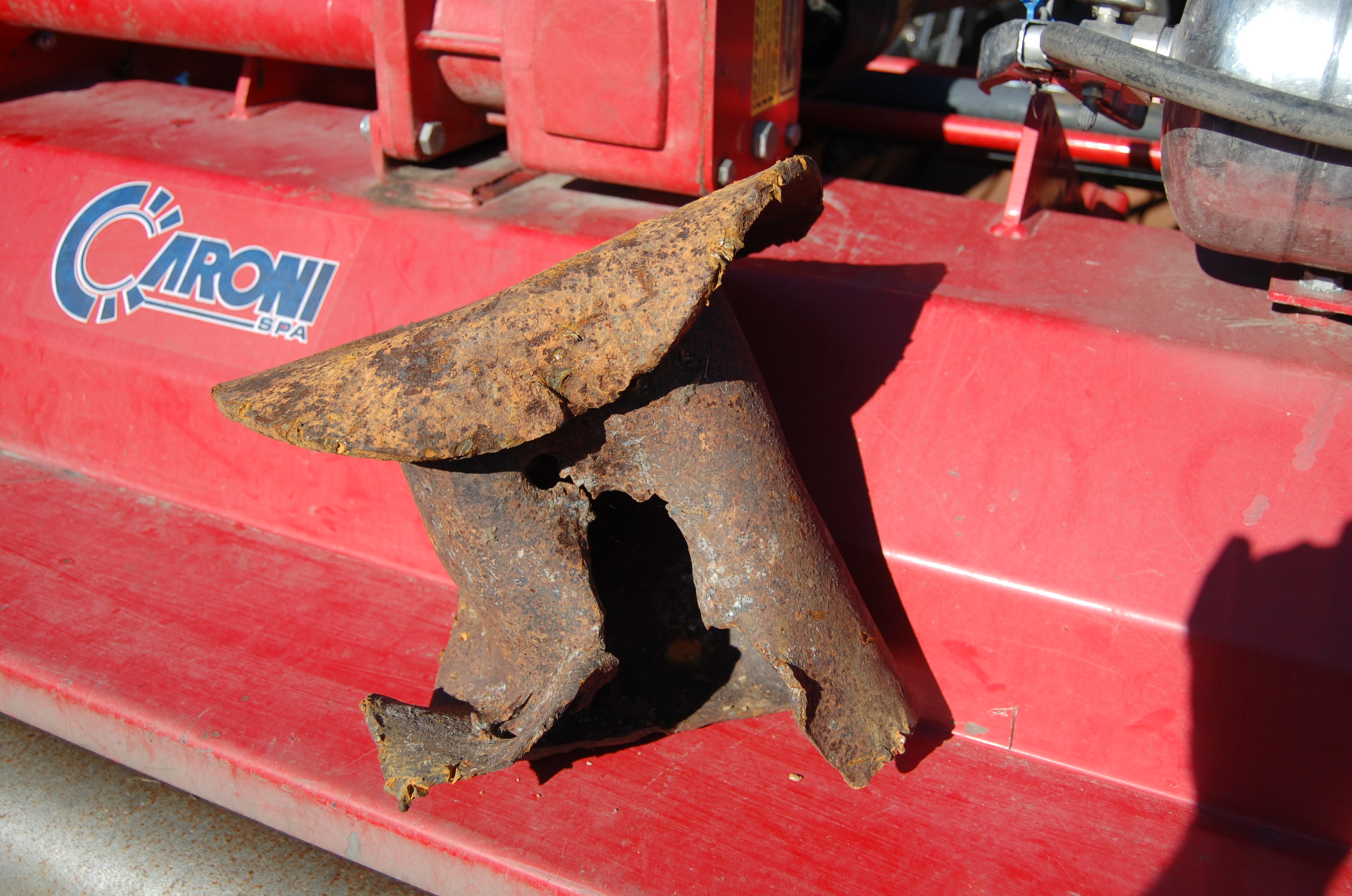

After using my new to me JD 25A this week I'm thinking new knives and rings may be in order. The rings are about the same price everywhere but the scoop knives or hammers are all over the place price wise.
This is the type of knife that's on there now. They look OK and could be sharpened but the D-rings are wearing a bit and should be replaced.
$1.70 per knife for these but then I see some that say "hardened" or "Super Koat" like these for almost three times as much.
Anyone have experience enough to know the difference and if one is worth that much more than the other? Flailmaster.com quoted me $5.50 for the knives but I do not know if they are hardened or specially coated or just the same as the $1.70 model above. I'll reach out to them to find out but would like to hear from others with knowledge as well.
Thanks
/ Let's talk flail mowers #7,816
To be hardened they have to be heat treated or have a carbide coating
applied to them.
If a cup knife/spoon knife is less expensive they are not heat treated.
You have to decide how much you wish to spend on them as you can
purchase a great number of regular knives to do a great deal of mowing
and not spend that much money on them per unit.
The only time a ring knife hanger/ring needs to be changed is when they
are broken or gone entirely along with the knife as the anchor strap is
also damaged and you want to use nylock nuts and washers or blue loctite
on regular fine threaded nuts and bolts for the hanger straps.
