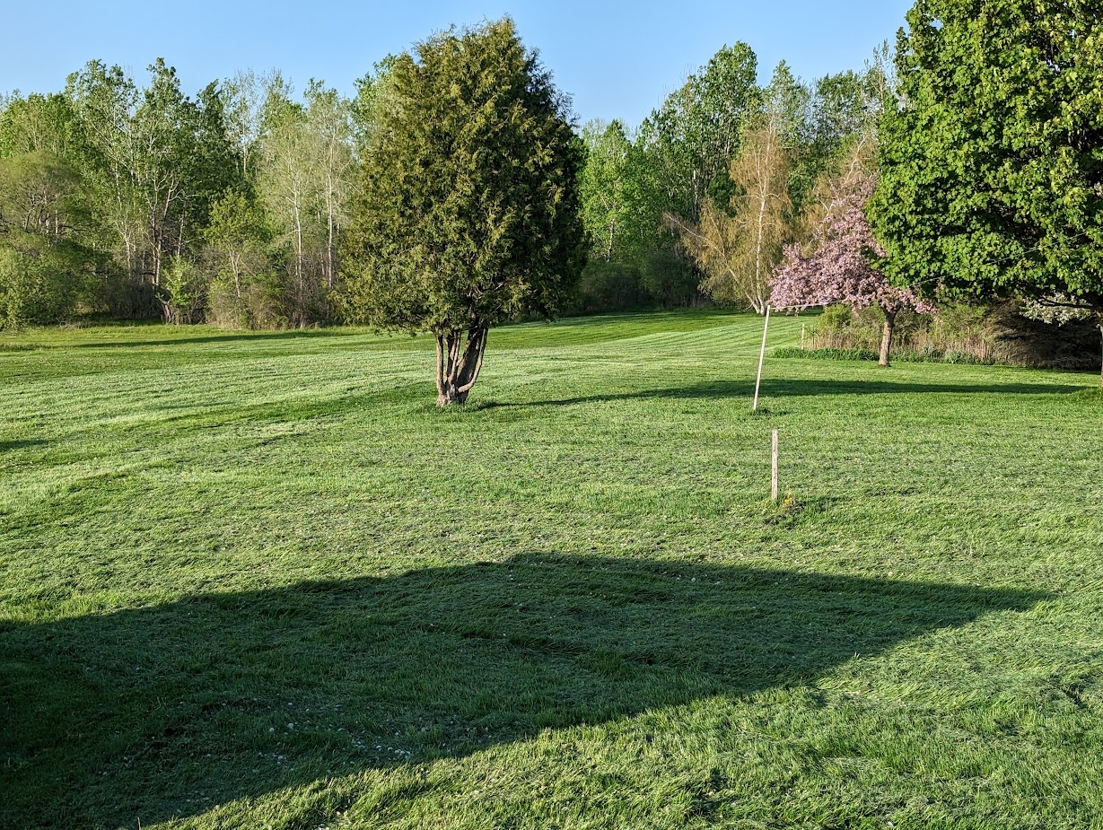

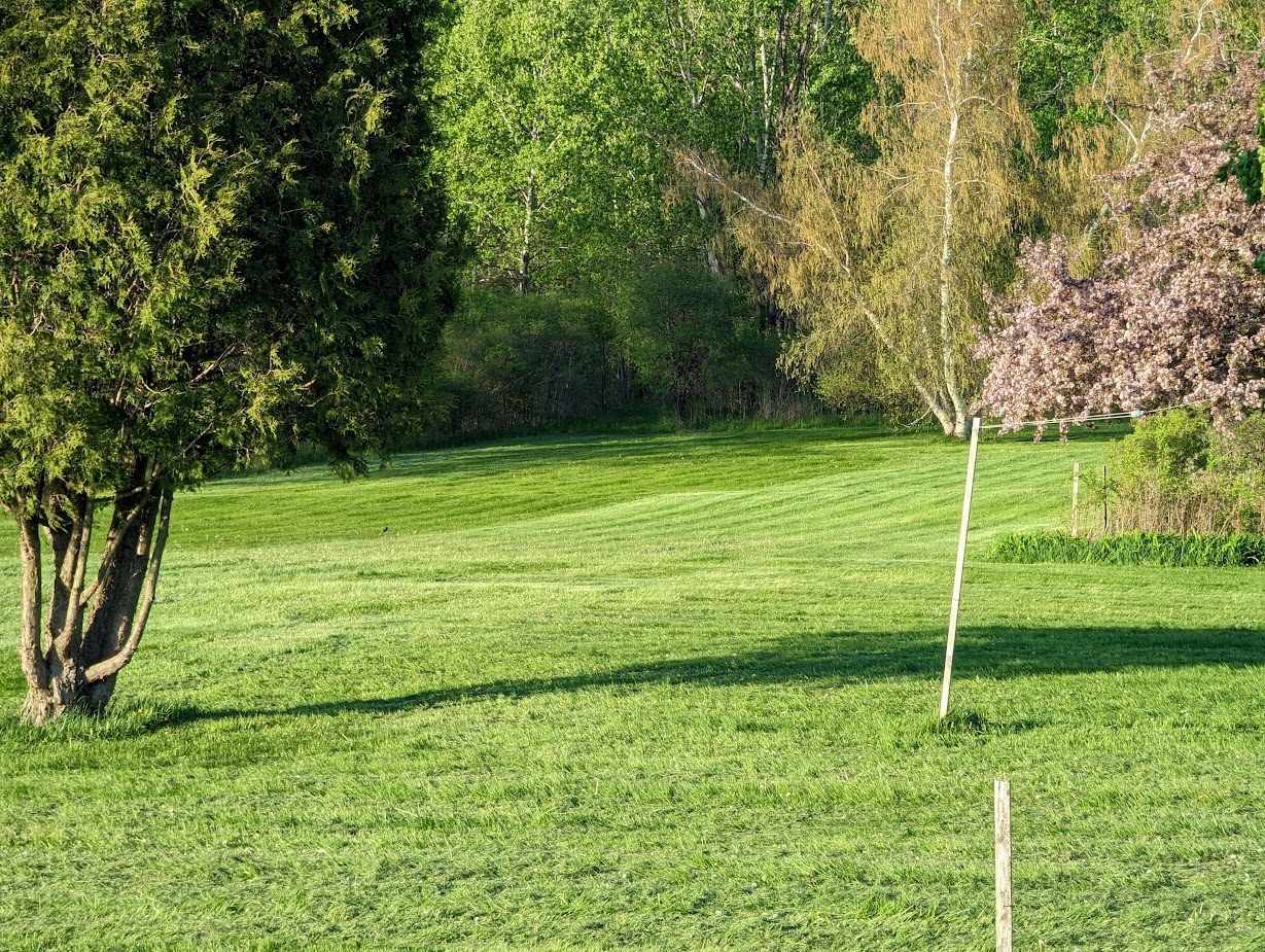

Ran the Woodmaxx FM-62 62" flail mower with Y grass knives on my overgrown lawn today. Grasses were 6-9" in length. Ran on my BX2200.
The striping and cut this flail mower does is unbelievable on fresh springtime grass.
Debated on using the MMM or the flail, and I'm glad I used the flail. Otherwise it would've been clumpy and disgusting looking windrows.
View attachment 800367View attachment 800366
I kinda wanna go roll in that like a dog
