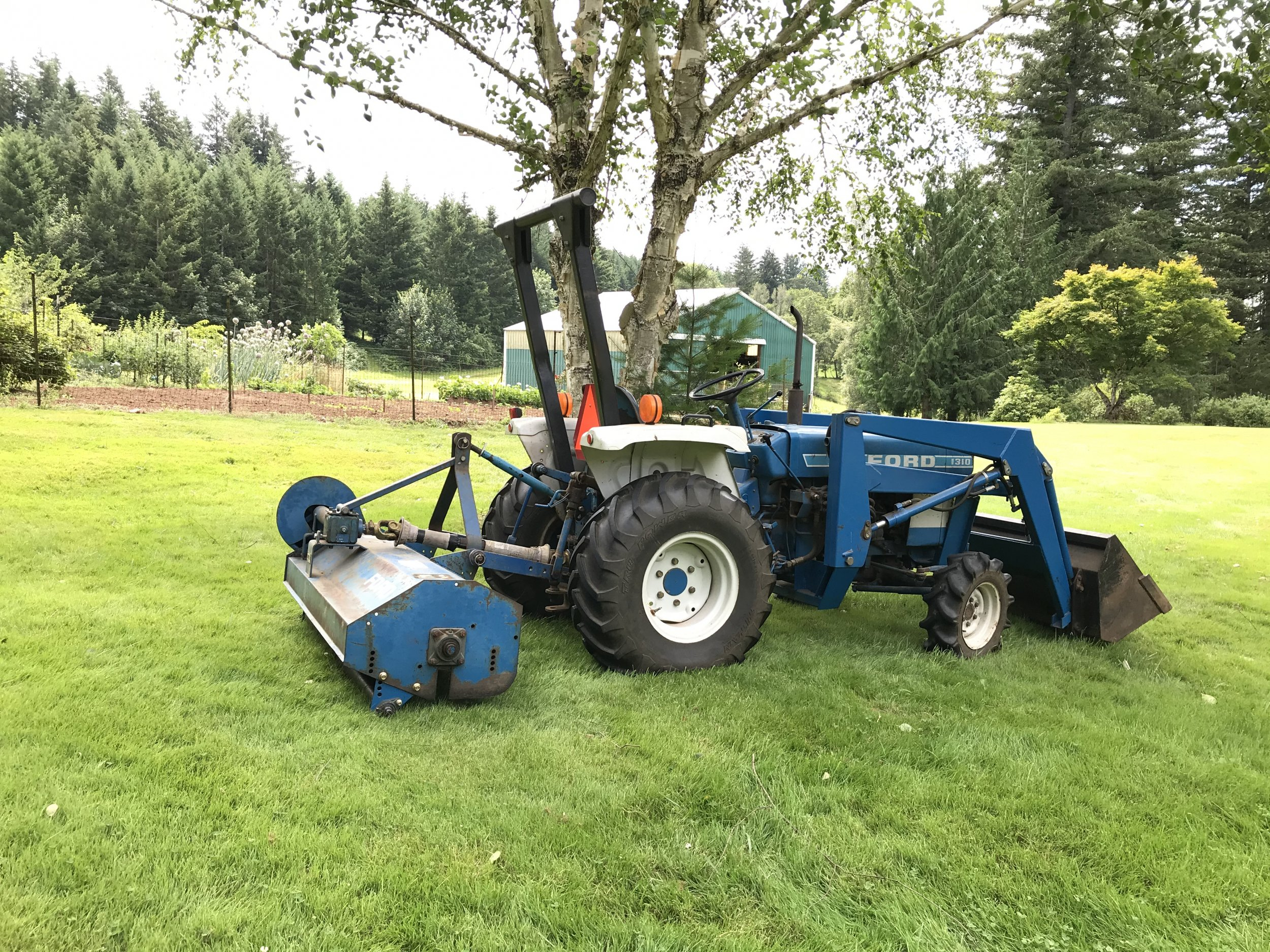

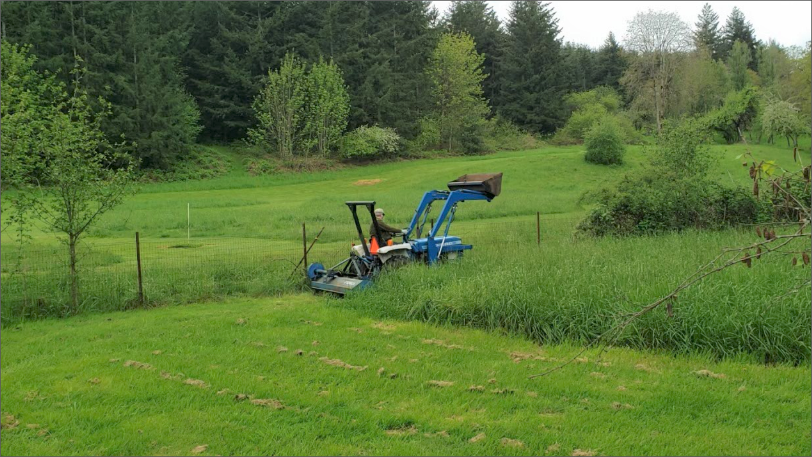

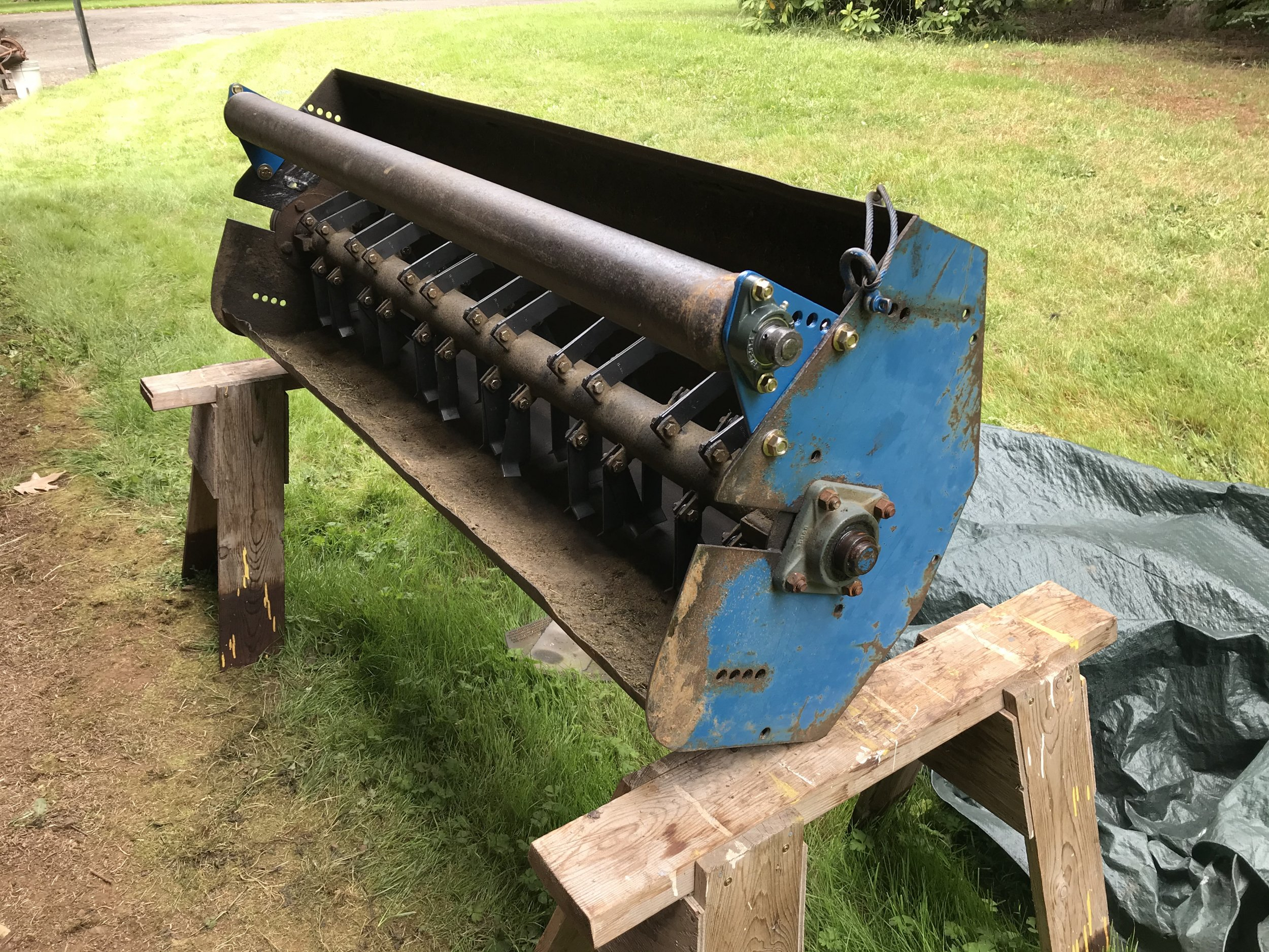

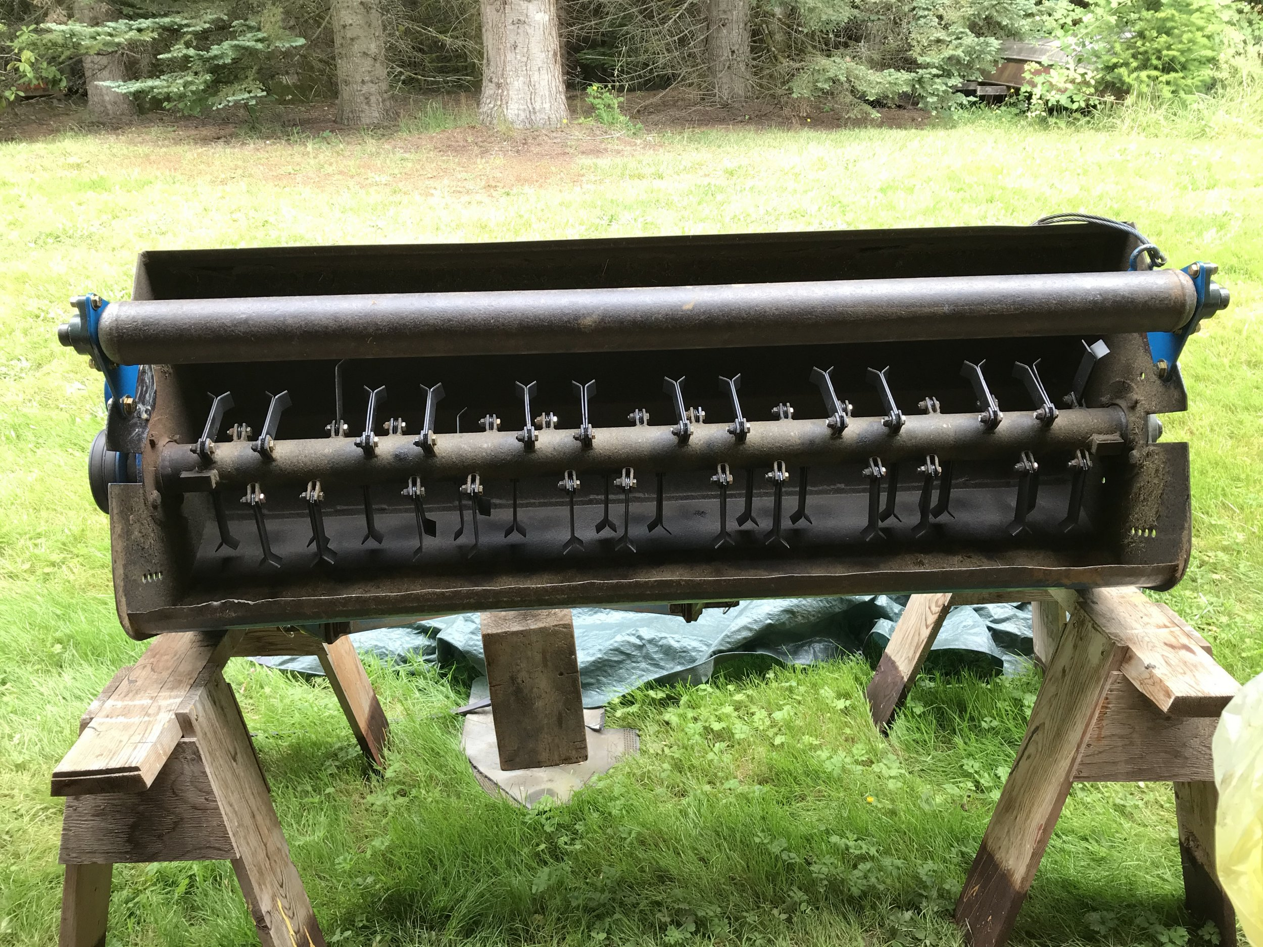

Yup, as always it depends. Reclaiming overgrown stuff or tall green grass is the hardest and requires more HP, or smaller bites and slower speed. But if you are maintaining, you can run as big a flail as the tractor will lift. It is all about how much material you have to move through it.Maybe, maybe not - depends on type of flails, I think hammer VS. side slicer quite a different power usage.
Ford 1310 has 19 hp engine and is very capable running 5 ft Ford 917L flail mower with the 96 x side slicer flails it was designed for.
This mower was designed as a light duty model, to be used with side slicers only and it works well as intended.
May 2021 - pretty tall stuff due to wet spring.
Obviously need to mow more often for sure, but the ground had been way too wet previously.
View attachment 790732View attachment 790734View attachment 790735View attachment 790736
Cheers
My thinking as a side business it's hard to control what and when you cut and that little extra to power thru makes a difference.Maybe, maybe not - depends on type of flails, I think hammer VS. side slicer quite a different power usage.
Cheers

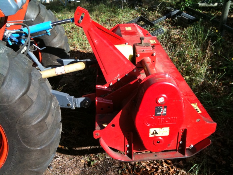

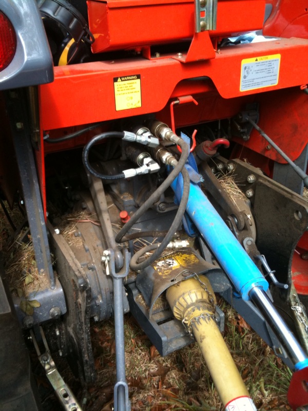

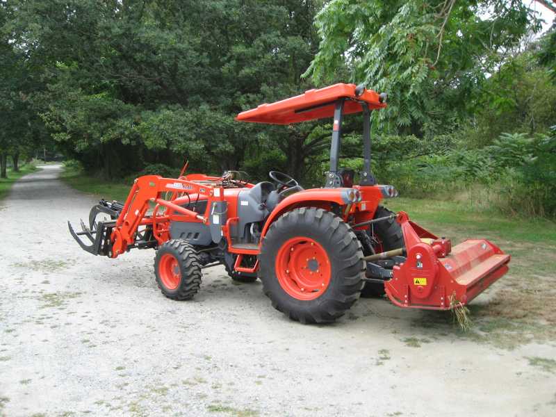

My setup and observations are identical. The flail just loudly hums along except for the annoying rattling of the scraper blade. Rarely use the RC.I use a Caroni TM1900BSC with my Kubota L4600. I haven't used my 6' rotary cutter since I got this years ago. Power wise I can't even tell that that the flail is running. I use it in my orchards, paths and mowing down cover crops. Great machine. My only complaint is that there is always a scraggly row leftover from the tire in higher weeds (although if I go slower it's very minor).
