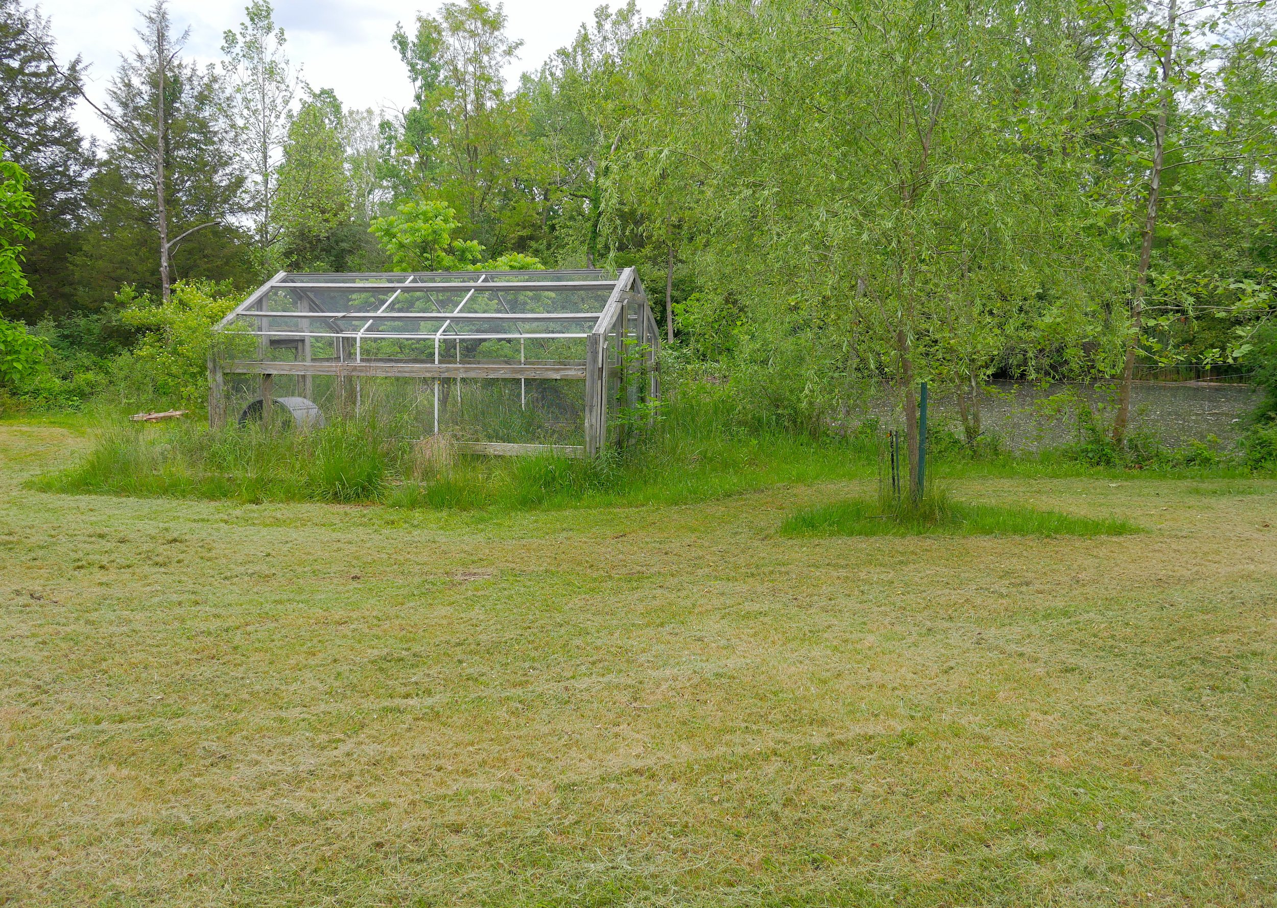

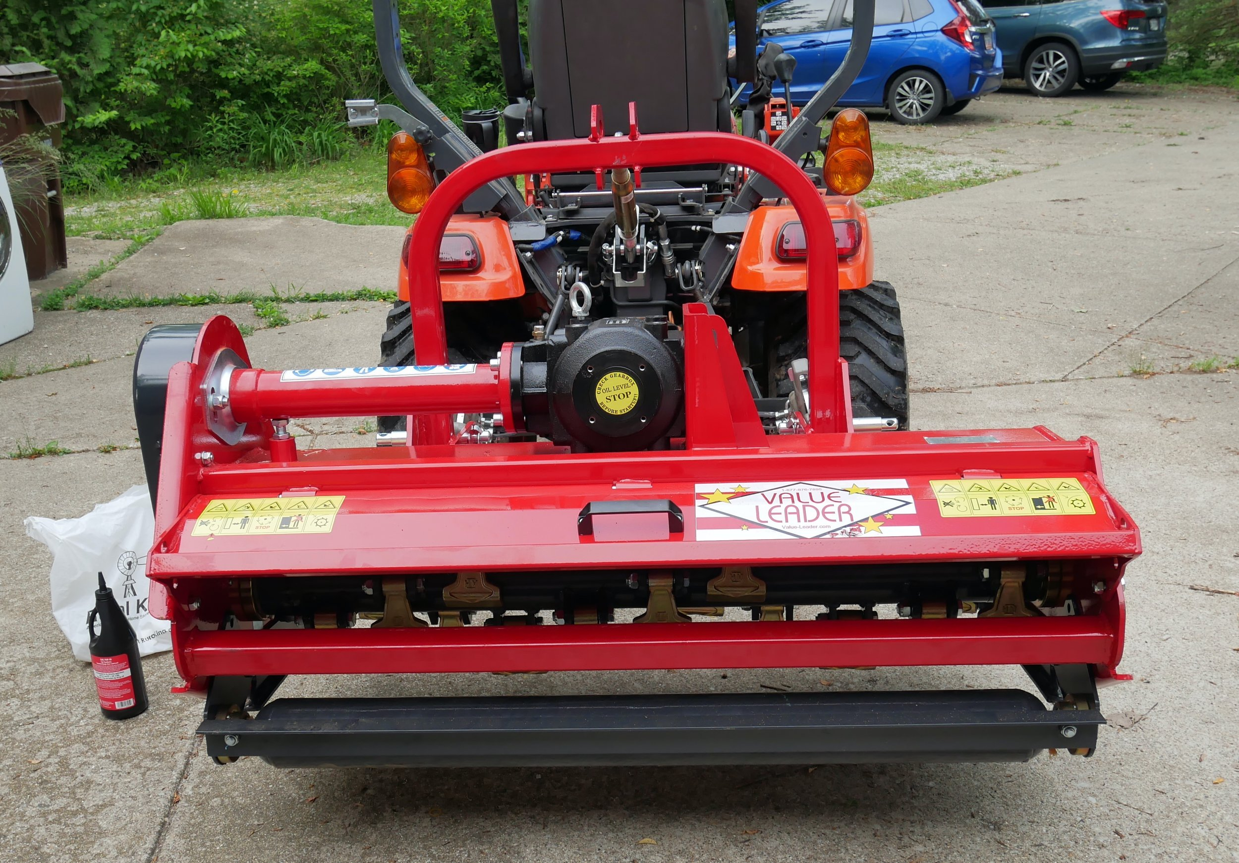

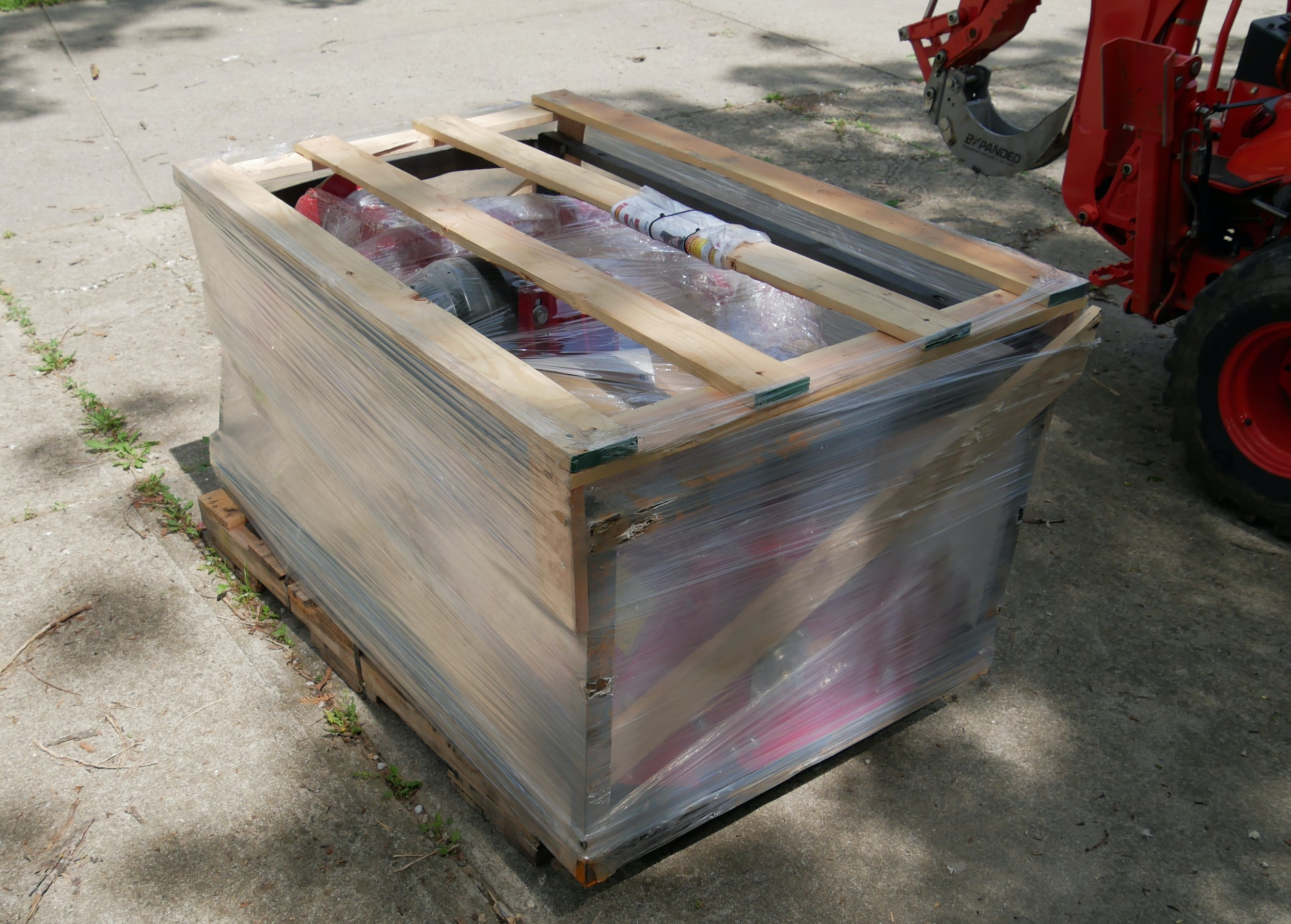

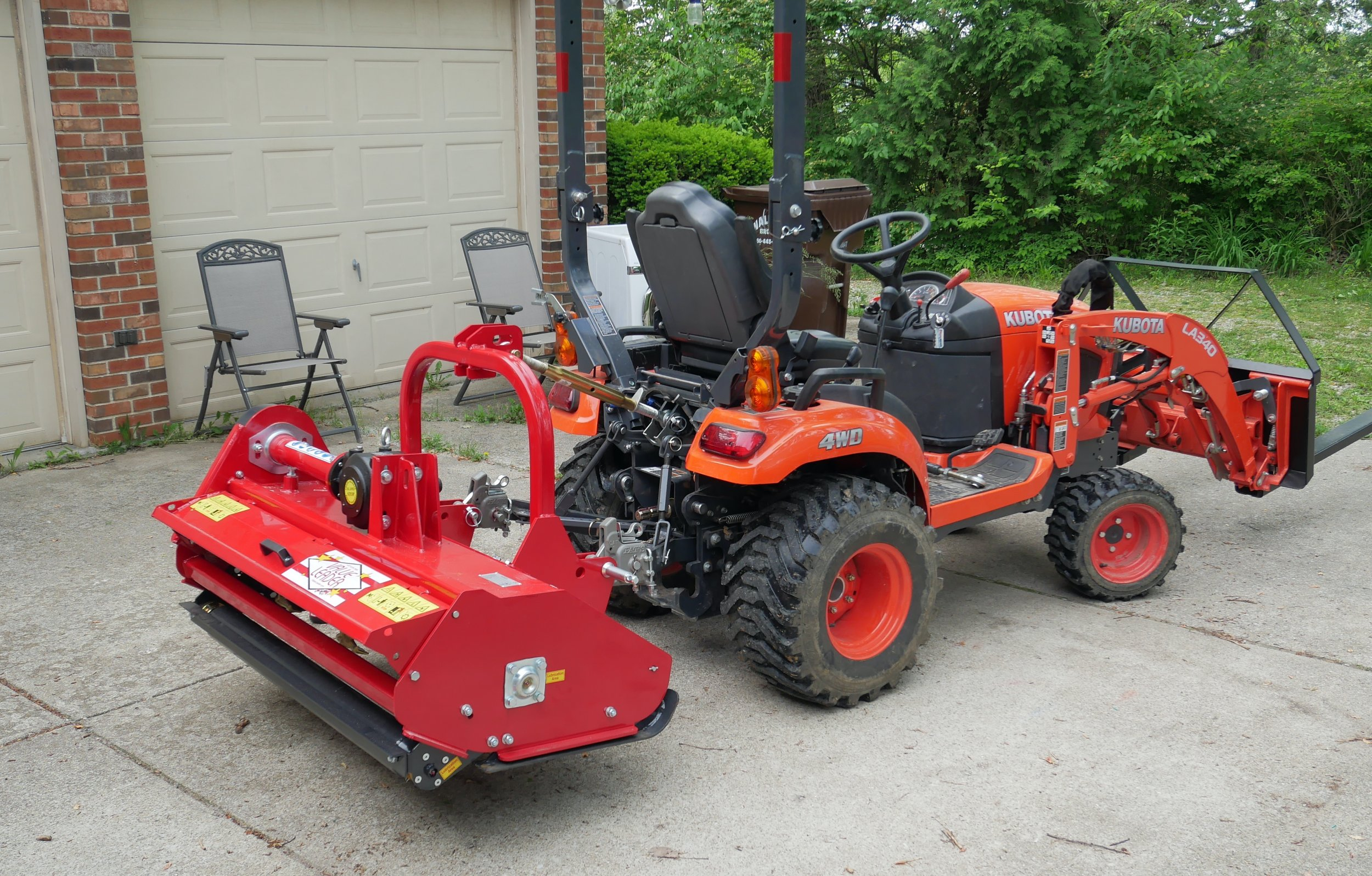

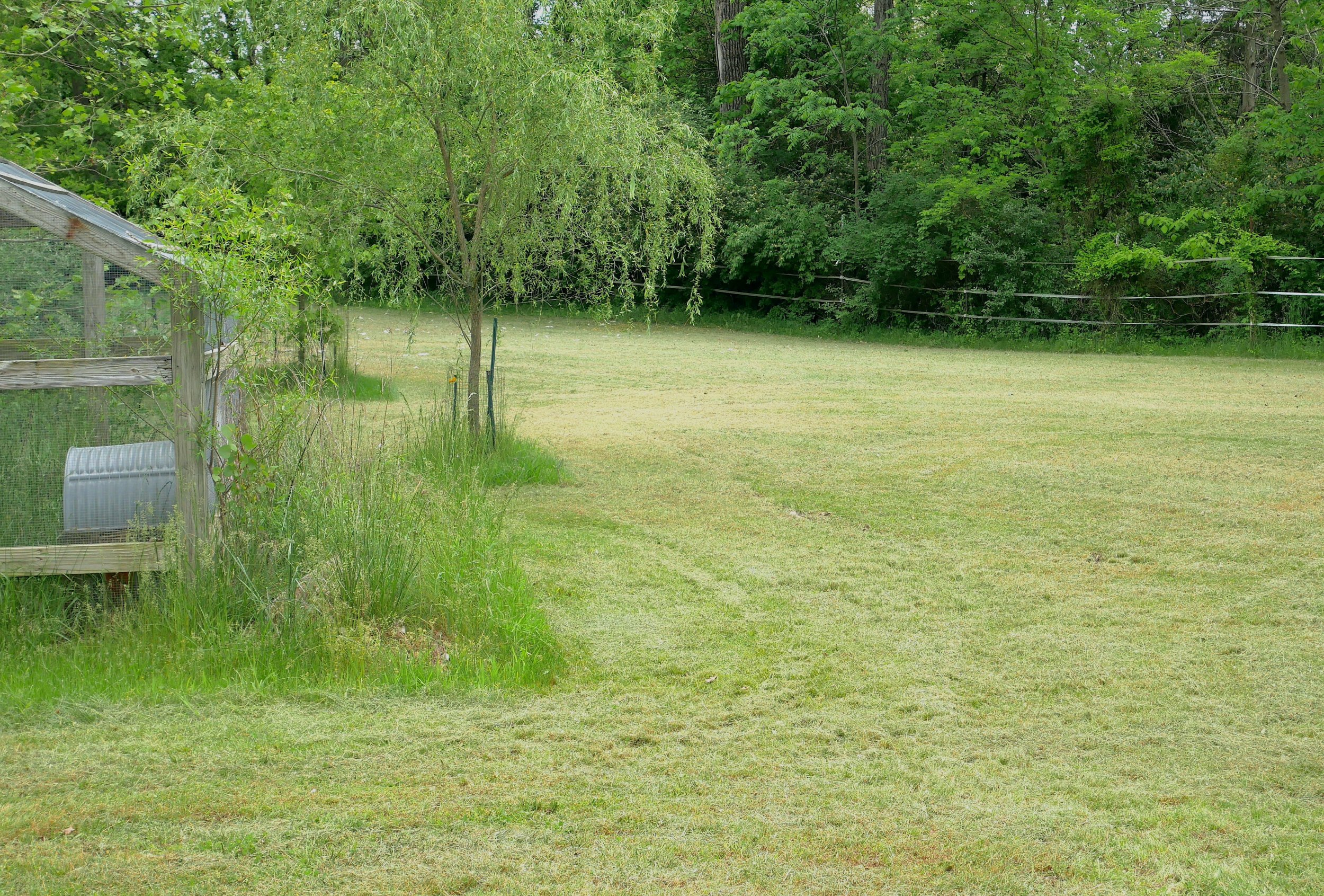

Just received and ran my commercial grade Betstco 48" flail. Took a bit to get it assembled, only because the components weight so much. Man, this thing is built like a tank. Once assembled, I had to cut the PTO shaft by 4" to fit. I also had to get a longer Top link to allow for the Pats quick hitch. First run was nothing short of perfect. 1.5 acres cut in 40 minutes. Cut as good as my Grasshopper, and left no clumps. The grass was about a foot tall, which normally would cause clumping issues with the Grasshopper. Nowhere near as maneuverable as the Grasshopper, but great for getting the majority of the area cut. This mower was listed as requiring 22HP, but my BX23s handled it well. As far as unloading goes, I was able to take it off the truck with the BX, but I couldn't lift it more than 6" off the ground. Not too bad for a 650 lb load extended 4 feet out past the pins. So far, extremely satisfied.
