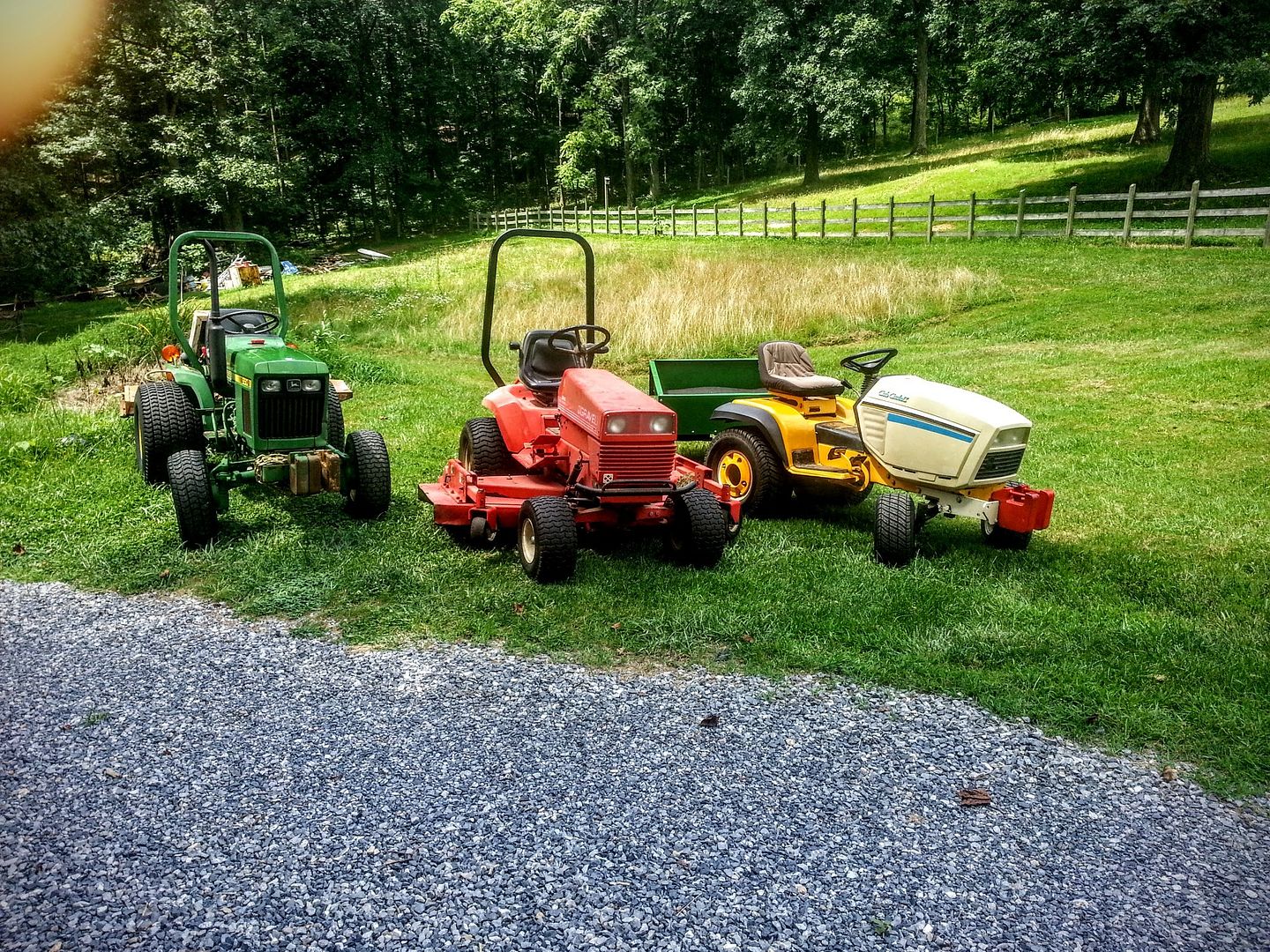

Posted this in the "TODAY'S SEAT TIME" thread and then figured that it should be here as well.
Was out for a second mowing with the MXZ220 and decided to try out the flail in some really tall stuff just to see what would happen. About 7' tall, first mowing of the year (it's a dead-end short stretch which I was figuring I was going to mow with my 6' bush hog). Contrary to the manufacturer's warning to avoid mowing really tall grass, I didn't experience any issues (no sense of grass wrapping up in the flail- I'm going to open it up and take a look, but after mowing this section I went on to mow a lot more more normal height grass and the flail operated as expected). Was actually impressed on the cut. SLOW going, but the same would be the case with my 6' bush hog.

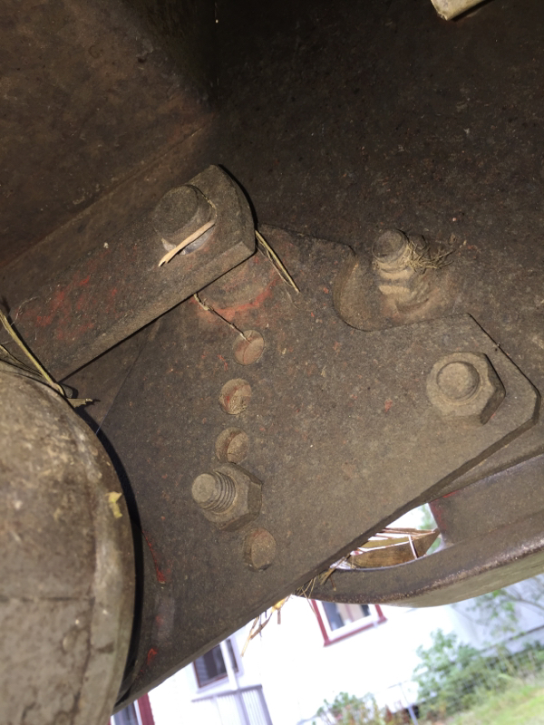

I am posting after using this site quite a bit to research tractor/ implements that I have purchased. Thanks to everyone that has contributed as there is a wealth of knowledge available here. I have my dad’s old flail mower, which my best guess it’s an old Mott but no tags or numbers I can find. While researching to find new knifes for this I discovered the ditch bank flail mower which is exactly what I need to mow the creek that divides my property. Then I priced them out north of 7k and thought this wasn’t going to happen soon. More reading and I found the imports not from Italy. Seems like for the most part everyone was happy with them. I decided to purchase a nova tractor BCRM 175 mostly because they had in stock. It arrived in 6 days and took a couple of hours to assemble. I used it for a short time and was initially very impressed with what it can do. I would recommend adjusting roller to highest cut on the first try as I destroyed a few rocks on my first cut, it dinged up a few of the hammers but they still seem to cut pretty well. Itching to get back on it in a couple weeks and see what else this thing can do. I included some photos of both and maybe someone can tell me more about the old one as I will be repairing it and putting it back in operation. Thanks to all for their input and opinions as it has been very helpful for me.

Greetings,

Greetings,
Hello bigalege32,
I thinkk it is a Mott flail mower, either way you can get parts for it and help from the Flail Mower Nations resident members.
