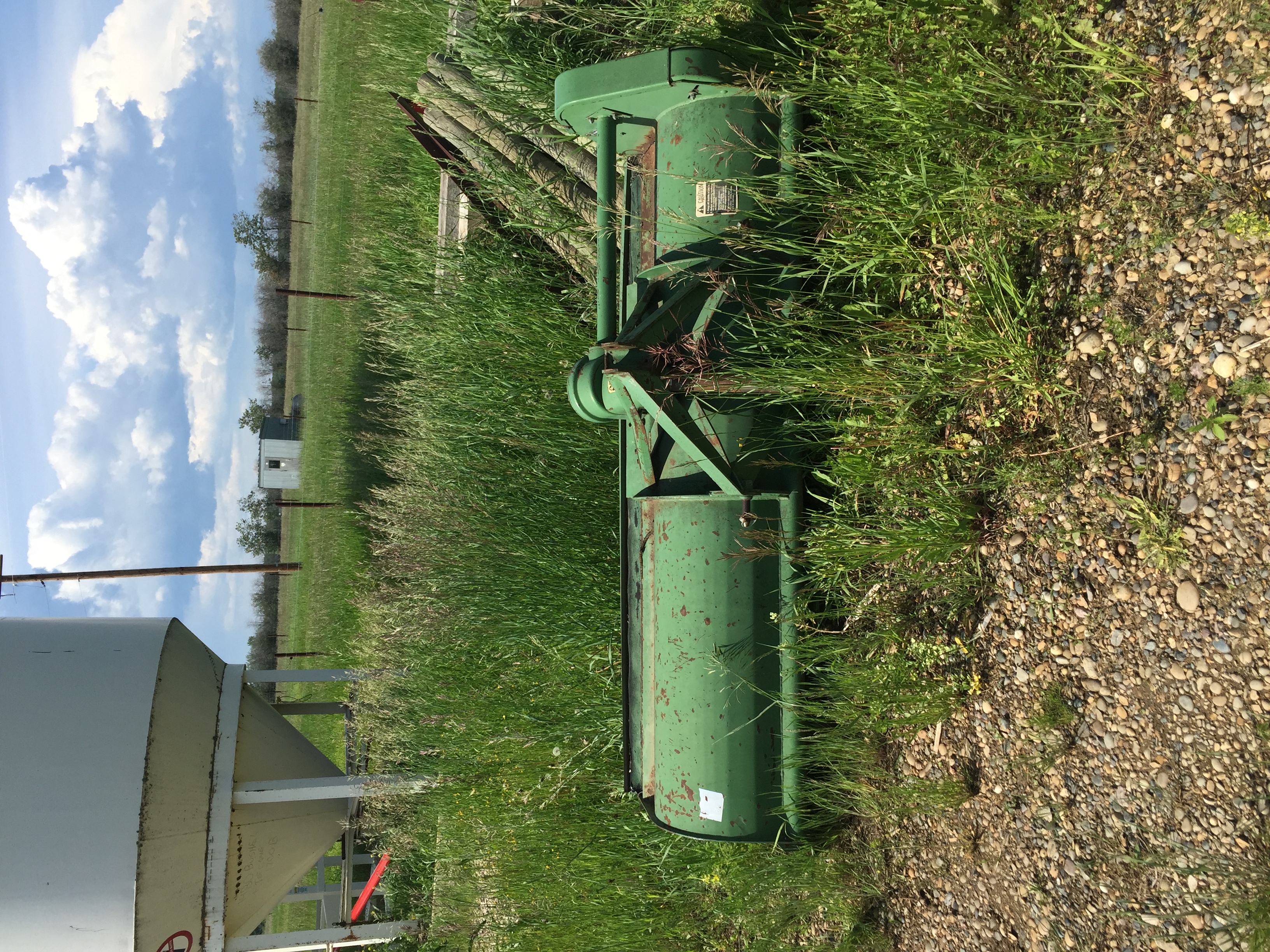

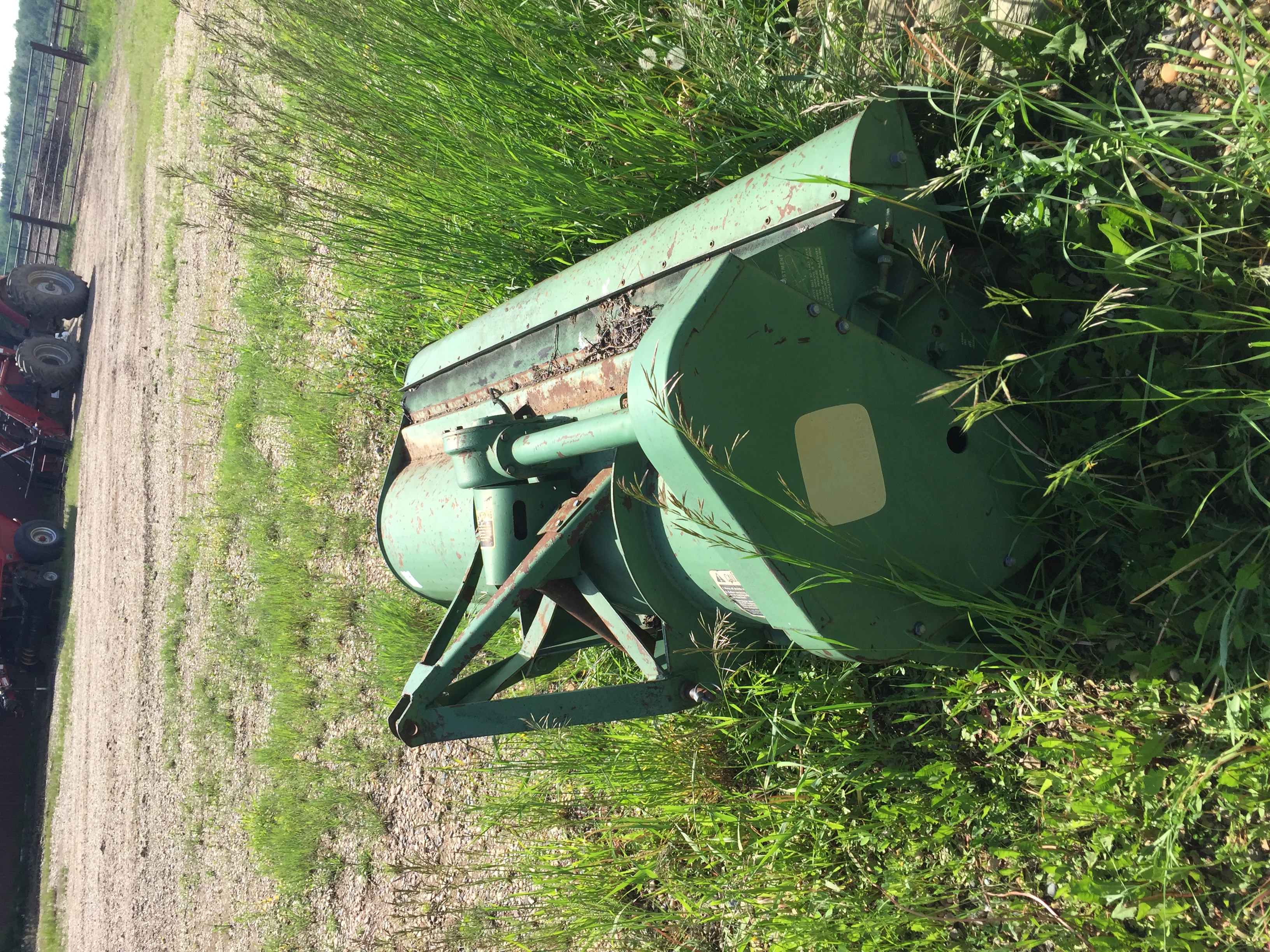

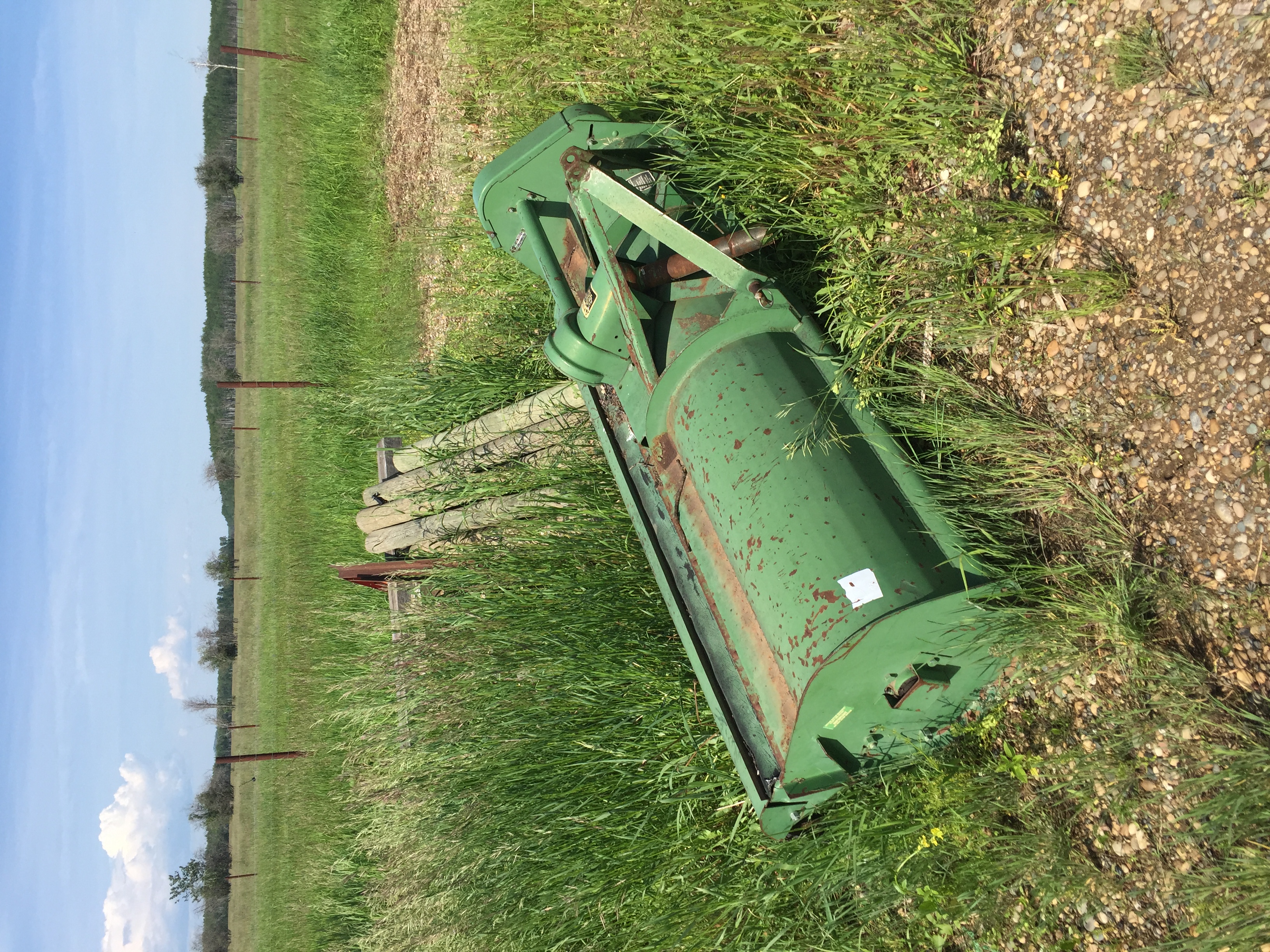

This is the only one even remotely near me. It looks really rough though.

Ouch... That one is ROUGH. I would avoid it. Seeing that the housing is disappearing it will not last much longer.
Patients is needed in finding a used flail mower.

You can tell that one was driven over a lot of rocks and the flail mower rotor shroud is paper thin form impact damage.
