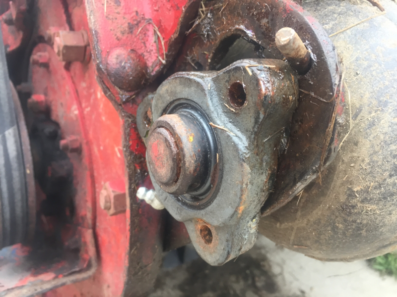

Can you adjust one end of your roller w/o disturbing the other end? For my education only?
/ Let's talk flail mowers #4,771
Nope, that is the quickest way to ruin a set of rear roller bearings and break the stub shaft of the rear roller at the same time.
/ Let's talk flail mowers #4,772
Ok, so both ends at same time?
/ Let's talk flail mowers #4,773
Yes, it is better to do it that way wherein you are not stressing the inner race of either bearing.
AS Roy mentioned a floor jack works wonders and using a floor jack or bottle jack with a short 2 by 6 under the rear roller to keep the roller even as you raise or lower it as long as the ground is solid under the floor jack or bottle jack.
In saying that a piece of thick plywood or two pieces of plywood or a pair of short planks will work well as a solid floor of sorts for a floor jack as well.
It is easy to do as long as you have the mower stable and supported with jack stands at their lowest point.
Rolling the mower on its back takes more time and work so using the jack stands and a floor jack or bottle jack to lift it will be fine.
What ever you do DO NOT let your self put your legs under the elevated flail mower UNLESS it is fully supported with thick wooden cribbing.

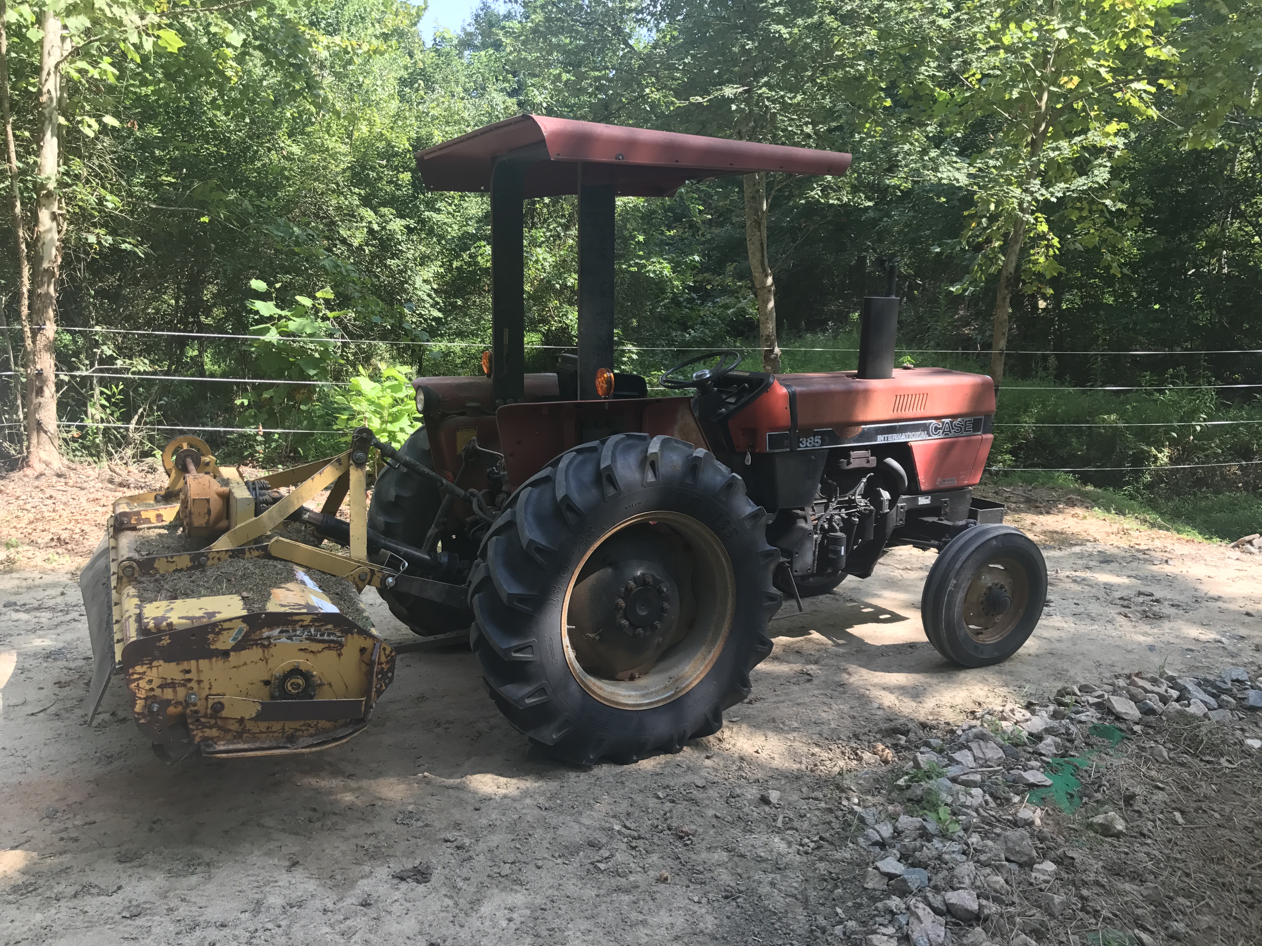

IMG_1131.JPGIMG_1132.JPGPicked up the Alamo flail I referenced earlier. Its an SH 74 in great shape. Owner used it on a road crew alongside 11 other Alamo Flails, said it had not run in 3-4 years.
Got it home, changed the gear oil (although what was in it was clear and perfect looking), greased up the joints (although 2 zerks were stuck), and freed up the PTO shaft and collar. Belt actually looks great. Rear roller has a very slight curve in it, it varies maybe 1/4". Coarse Cut knives look rough, some were new, some have been beat up pretty bad. Will have to get some new ones on order. Used the Alamo manual to see what height it was currently set at (4 holes down from the top), I'm a little confused on this one. It references an "A" and "B" mount hole in the chart. I want a 4" cut height.
Hooked it up to my Case IH 385 (39 PTO HP). Ran a few sections of field, seemed to cut pretty well. A little more clanging debris than I expected, but I was running over land that had some limbs and stuff on the ground. Noticed allot more dust flying around vs the finish mower.
Overall I'm pretty happy with the purchase, seems like it will do what I need it to do on my horse property.

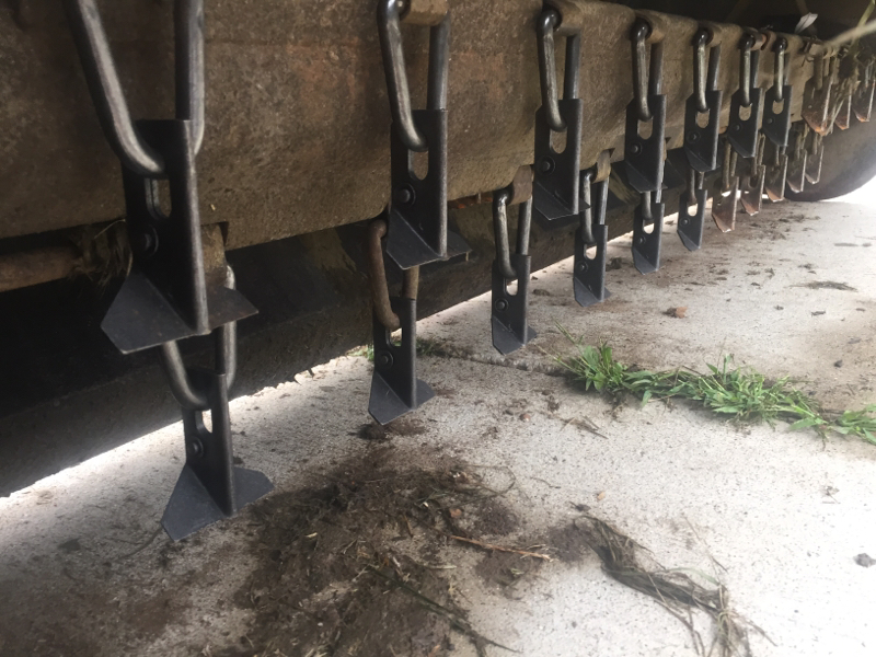

I also just bought a new "Titan" flail mower...72", made in China. I also have a 1990 Vrismo MightyMax so I can compare quality. I considered an Italian Peruzzo Fox, but this was half the price.
The welds look good. The mower housing seems to be as thick or just about as thick as the MightyMax...I'll caliper it later. The Titan mower is a near clone of the Value Leader, Betsco, etc. flail. It has the duck-foot style flails...they seem very heavy duty. Complaints? The grease fittings are in horrible locations. The drum bearings are greased from the inside and outside (2 small bearings, perhaps?). Greasing the inside zerks is not going to be that easy. The grease fittings for the roller are pointed downward, and are basically at ground level where they look like they'll easily be damaged. The rear roller is much smaller than the Vrismo roller, in terms on diameter. It does have a scraper bar and interestingly has two angled "chopper" bars inside the housing that would likely assist with the mulching effect. I'm also pleased that it has a little jack foot on the front so the flail can be set down in a position easy to take the tractor hitch arms off.
The top components look to be good quality. Cast iron gear box, 8.8 grade bolts, nice drive shaft, oil-bath belt shaft. The belt cover does not come off without tools like the Vrismo does, but that's OK. I have yet to look inside and see the belt / tensioner arrangement.
The drum itself is small, much smaller than the Vrismo drum. My biggest concern is how well this thing will hold up to hitting rocks, etc. Basically, there are two abutments with a bolt through them welded to the drum...the flail hangs from the bolt. I'm guessing its possible the 'abutments' could break off...can these be replaced and re-welded?
Last observation is the weight. The serial plate is a cheap sticker so I photographed it in case it comes off, but it lists the weight as 640lbs. UPS freight weighed it at 810lbs. Granted, that included a standard wood pallet and the iron-angle 'crate' (4 sides) that it comes with. The pallet probably weighs 40lbs and the 'crate' might weigh another 40...so I'd say the mower is a little heavier than it claims.
