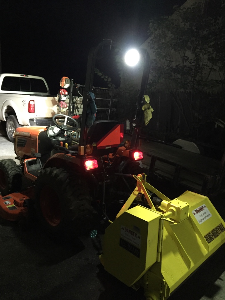

Here's a picture of my old 4-foot Vrismo Mighty Max. Very heavy for its size but it has mowed a huge amount of tall grass behind my small B2920, and I've even used it behind my larger L4310.

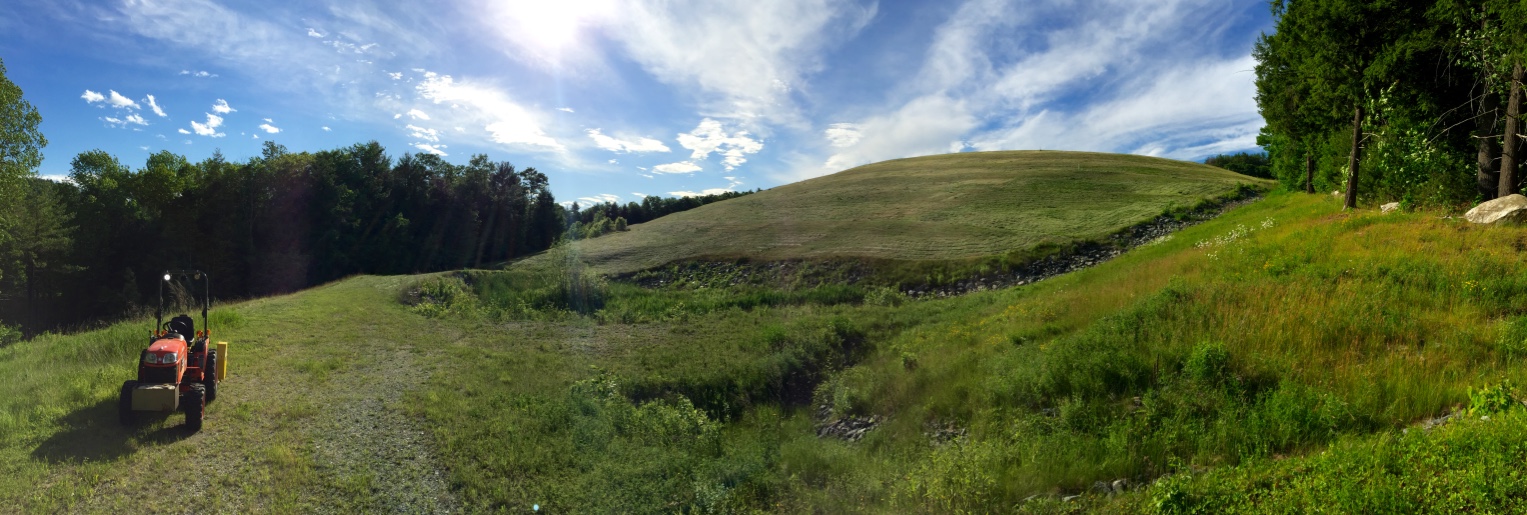

And one more pic showing a section of the sloped field this small tractor and flail mower combo has done many times...thumb_IMG_1946_1024.jpg
And one more pic showing a section of the sloped field this small tractor and flail mower combo has done many times...View attachment 518836
I almost bought the MightMax as it was a solid unit. Found out also these are made here in the USA while their MiniMax line is made in China. If you are mowing a lot with a small tractor these look like the strongest unit I found.
