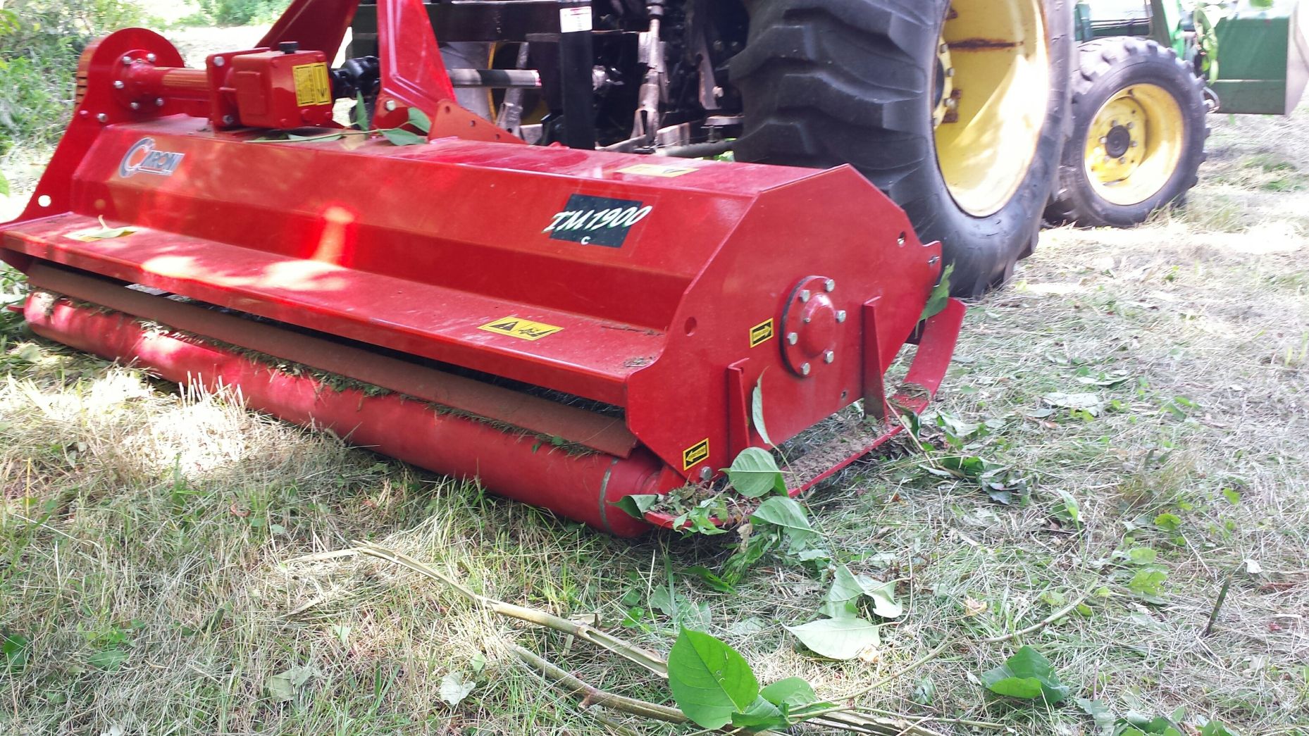

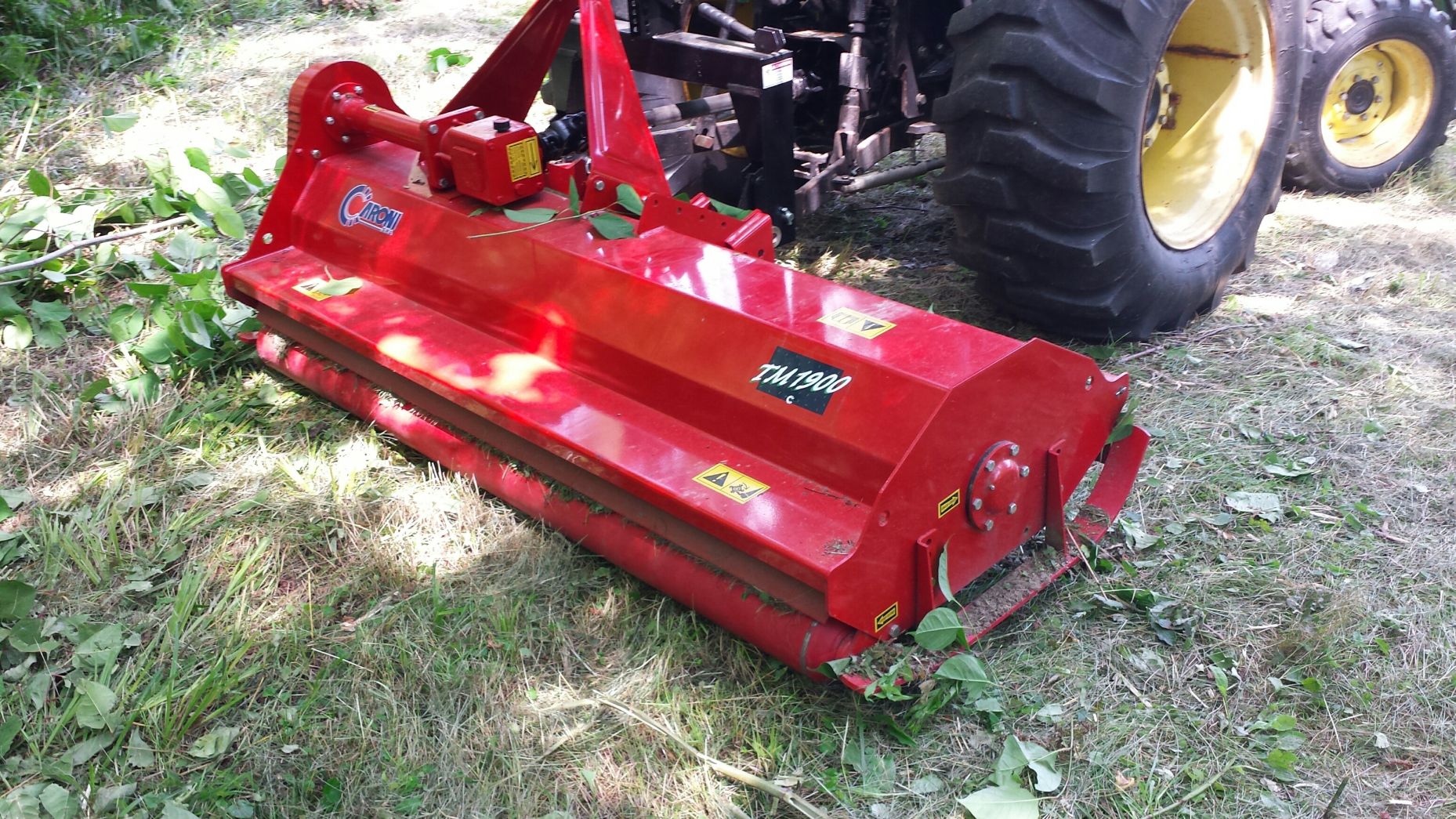

Your field looks great! It looks like your skids are very low, are you getting any scraping at all? When in use, those skids shouldn't be touching the ground. The flail should be supported by the rear roller and the 3pt hitch.

Agree Roy's skids are set pretty low. If he's not gouging turf then I guess his field is nice and smooth and level. I'd tear up the grass in areas I mow if my skids were that low. And, remember, the skids are just there mostly to protect the rotor and knives when the mower is dismounted. I suppose it isn't good to leave the knives in contact with wet soil for long but certainly no harm will come from being left on soft turf for a week or so. Mine lives outside on turf over sandy soil during the off season. No harm after ten years.

The one picture with the skid shoes set so low was taken before any mowing...I re-positioned the shoes much lower before mowing (one hole up). I'll re-position them again (lower) before mowing again to see how that works.
These pictures clarify the skid shoes.
I set them when I lowered the roller...I reckon I can re-position them. I'll admit, I a novice when it comes to flail mowers...I'll learn as I go and heed the advice of fellow TBNers with more experience than I.

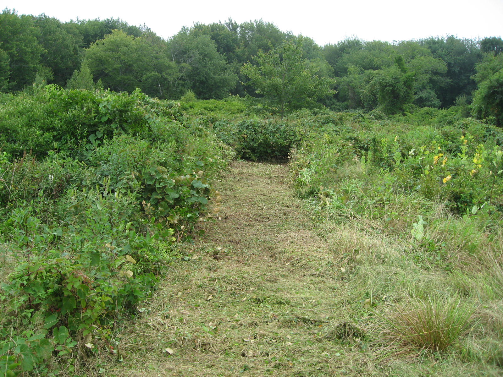

Hello Roy,
I know you will love how the turf looks when you have your final mowing height set and by then all the scrub and the thick stemmed weeds will be gone and you can spread good grass seed in the fall to generate more good turf and choke out the weeds even further.

The pics you posted above are good, that's exactly how you should be running the flail mower, with the skids not making ground contact. No need to readjust! The first pics you posted had the skids touching the ground. If they touch the ground you'll get gouge marks all over unless you have perfectly flat ground.
You've got it figured out, nice looking unit!

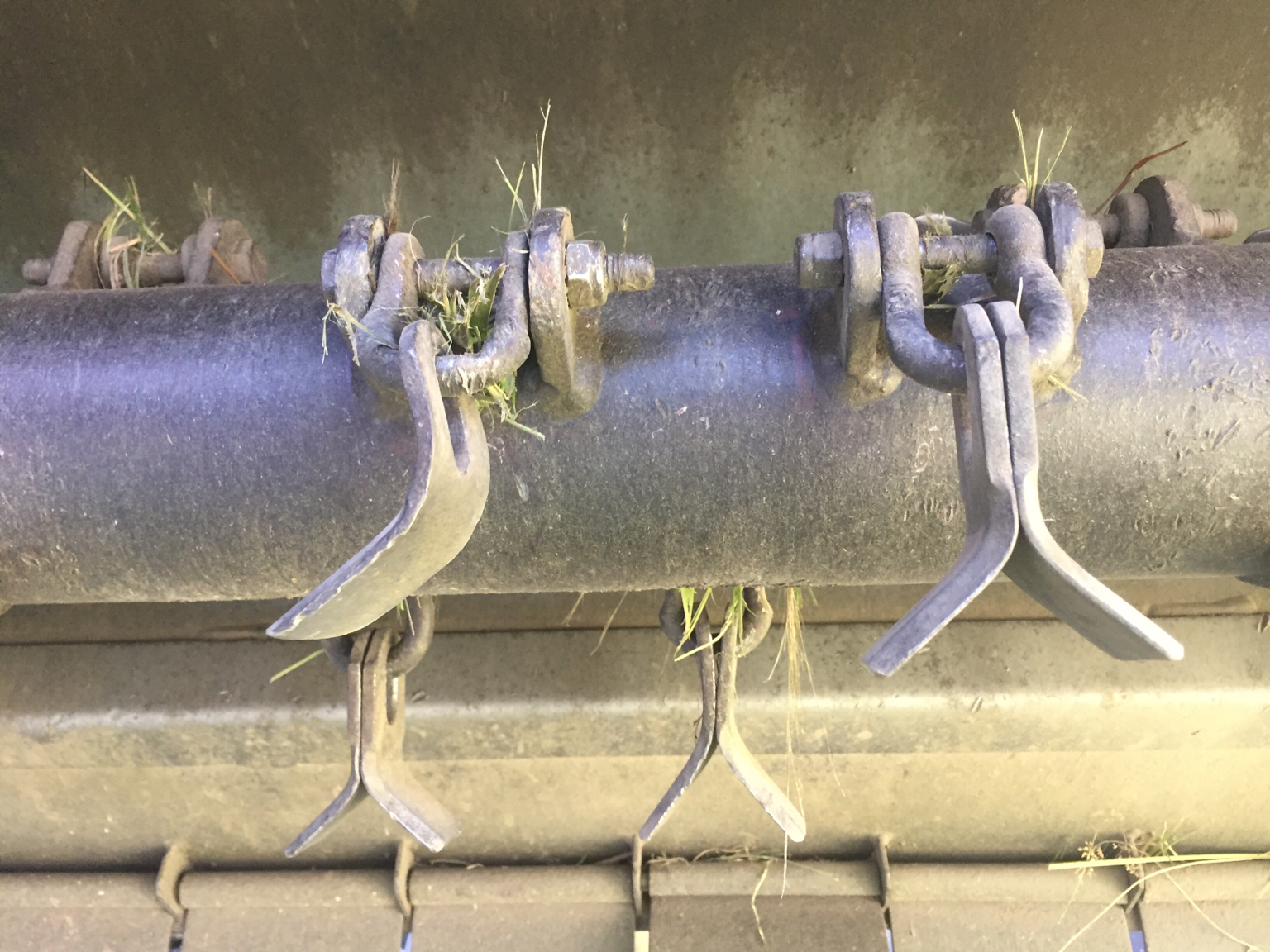

Toe to toe combat with big shale rock hiding in tall grass yesterday. Lost one blade but the rock split in two. I'm calling it a draw. IMG_1165.JPG
Pretty impressive. What was remarkable to me is that the old Caroni metric clevis survived and it was the blade that broke off. Usually the clevis is the weak point with these rock strikes.
BTW, photo shows good comparison of Caroni clevis and blade on left with Flailmaster clevis and blades on right. Slight difference in weight doesn't bother the mower. The Flailmaster clevis has shoulders ground down to fit but is still beefier than the Caroni.
