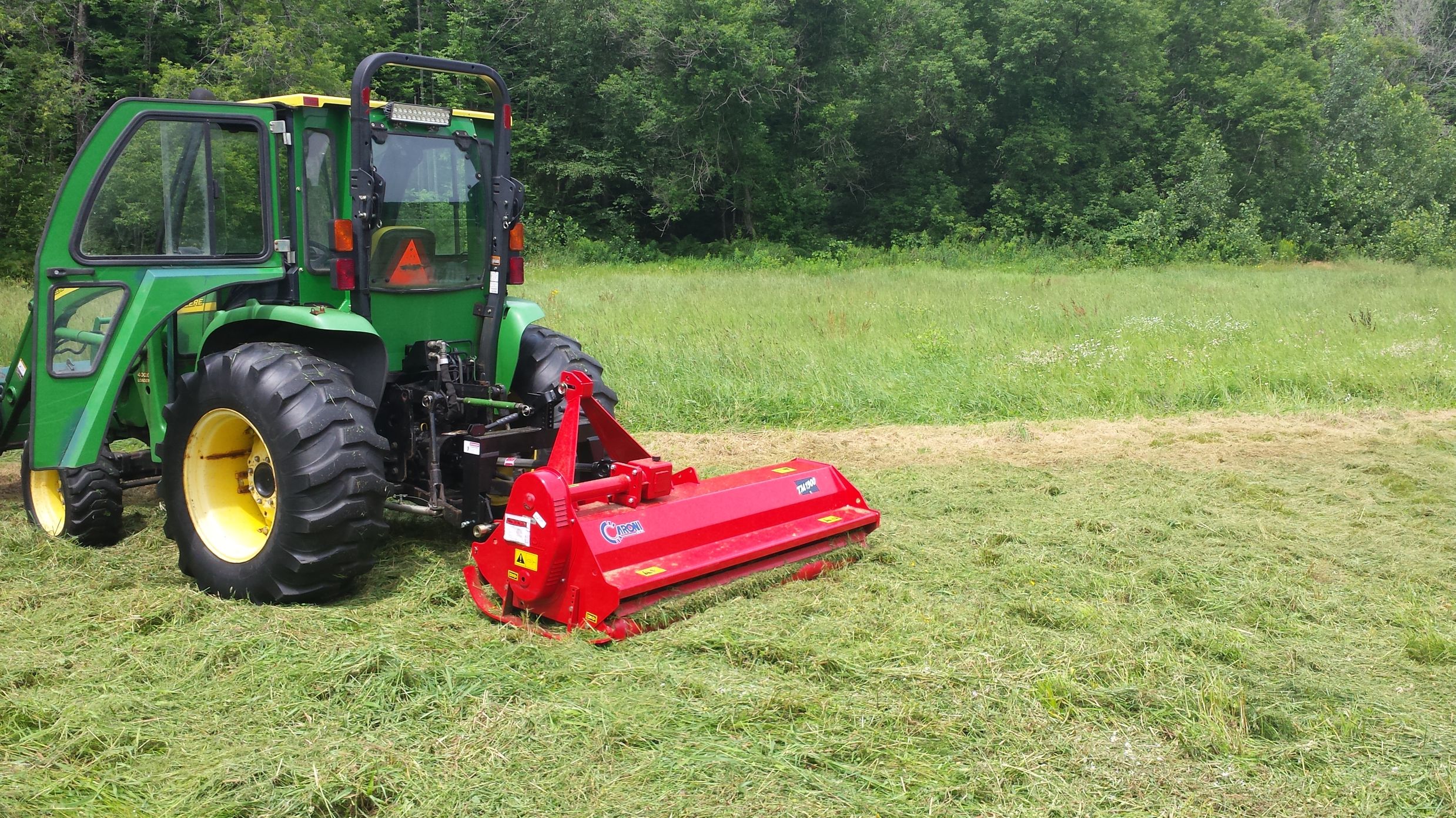

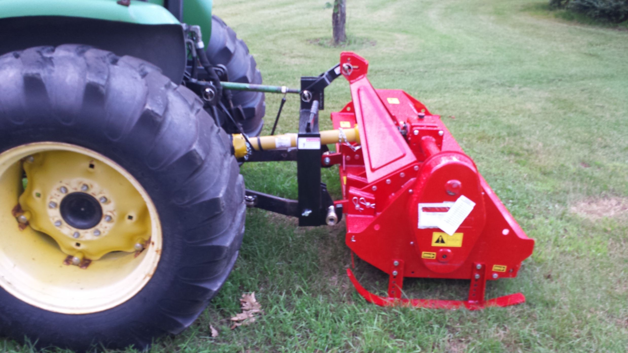

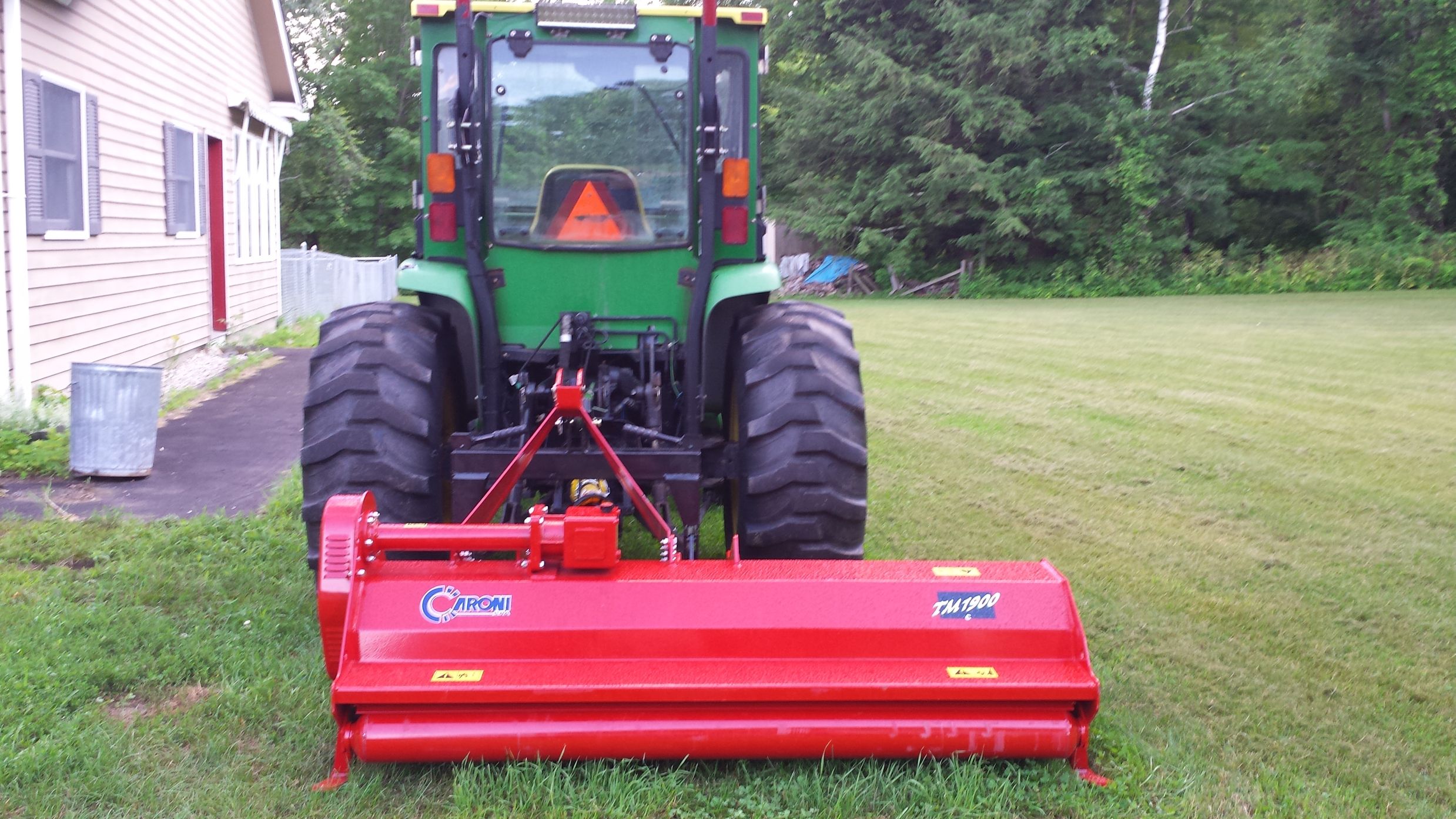

Finally got some pictures of the Caroni flail mower in use...
The maximum offset works best for me, so that's probably where I'll leave it.
The field grass was anywhere from a foot to about 4 feet high, thick in some areas, thin in others. The field hadn't been mowed in 5 or 6 weeks, and we've had a lot of rain during that time.
If I can keep it mowed biweekly, I reckon it'll look pretty good in about a month or so.
The pictures don't show it well, but there's a lot of bamboo growth just off the field. I made a couple passes to see how the mower would handle that...seems to do OK. Clearing that bamboo will be slow going since most is as tall or taller then the tractor (including the cab) and I know it's pretty rutty under the bamboo.
So far, I really like the flail mower. I don't know if the Caroni is a more robust implement than the Woodmaxx, but the Caroni was available...the Woodmaxx flails won't be available for another month.
