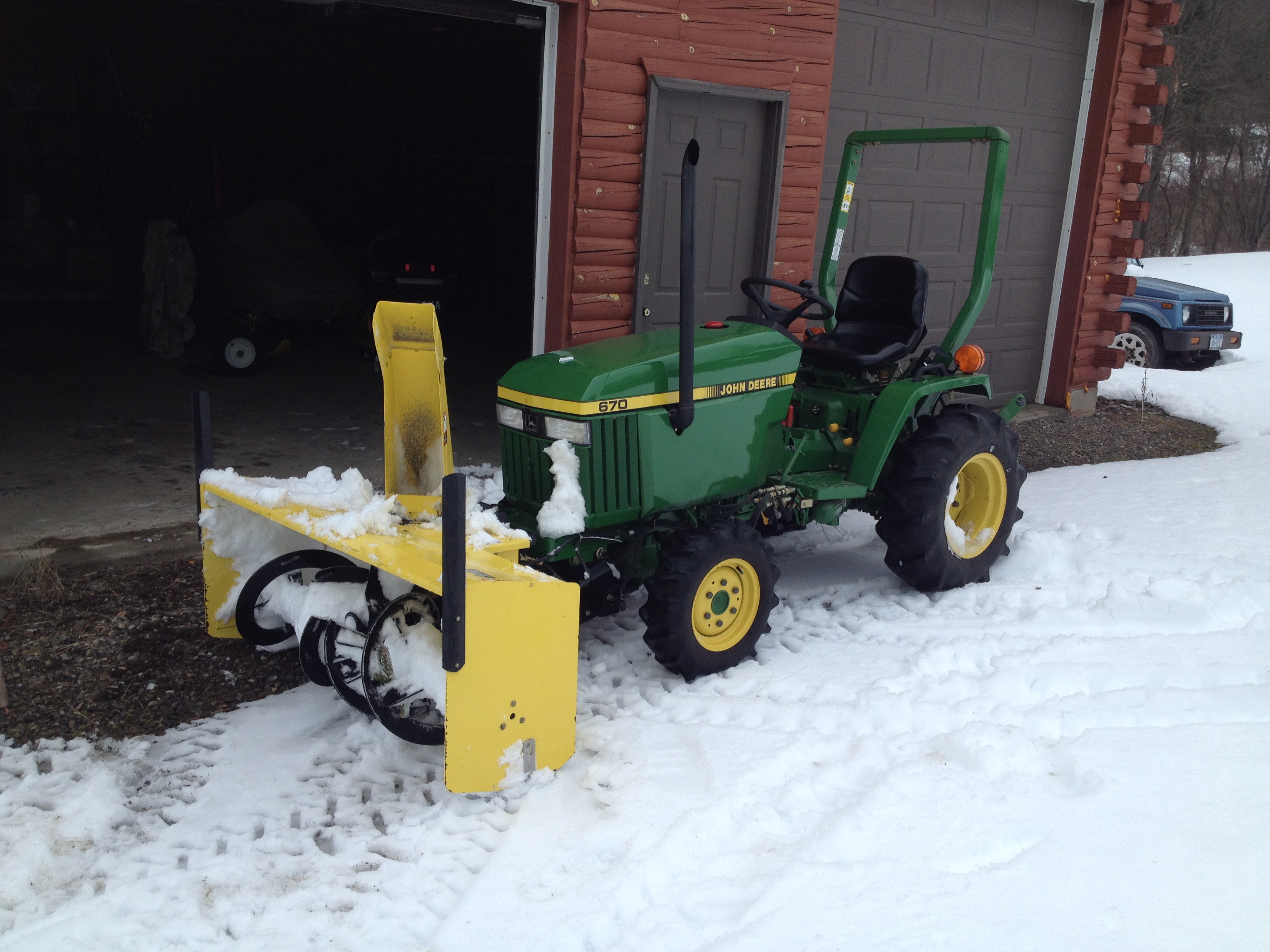

GENTLEMEN, I have been reading this thread from page one for quite a while, actually a very long time, tremendous amount of information, 16 mega tons of info, I currently have a 1999 DEERE 670 compact tractor, I do not have a loader nor loaded tires, nor any front weights, I currently cut three acres with a 4 foot Deere rotary cutter looking to upgrade to a flail mower, I would also like to do some trail cleanup, I have located a 6 foot MOTT RHINO flail mower in great condition it has new drum bearings, new belt, looks well taken care of, it has some cutters of the y-type that are broken, do I want to replace the cutters with a paddle cutters, I only cut the field twice a year, the brush does start growing in during that time, maybe cut it with rotary then the flail ? even field tested the mower on the owners old Ford tractor only vibration was getting the drum up to speed, the sheet metal is not even rusted badly, will I be able to lift it and spin it with my 18.5 hp engine, and will I have to replace the driveshaft due to length, the reason I ask is the flail is about 265 miles away, did not think of measuring the shaft or looking at the spline, Many thanks EDDIE
/ Let's talk flail mowers #4,708
Eddie,
Generally we want to see 4-5 PTO hp per foot of mower. Your 670 would handle a 4' easily, a 5' in most conditions. A 6' would generally be considered to be too large for your HP. As far as driveshaft length, it is pretty hard to tell without hooking up and measuring. A 6' flail would be great behind a 870 JD. The mower looks pretty good.
/ Let's talk flail mowers #4,709
I had a 670...great little tractor, but with about 17 PTO HP, I think that 6' flail would be too much for it. At best, it would be very slow going as the engine would bog down if the brush has any height to it.
I think the 670 could lift it...but not much lift capacity to spare. You would need 4 front suitcase weights, at least.
As much as I hate to say it...but I think you should pass on the flail mower and look for one 4-5 feet wide.

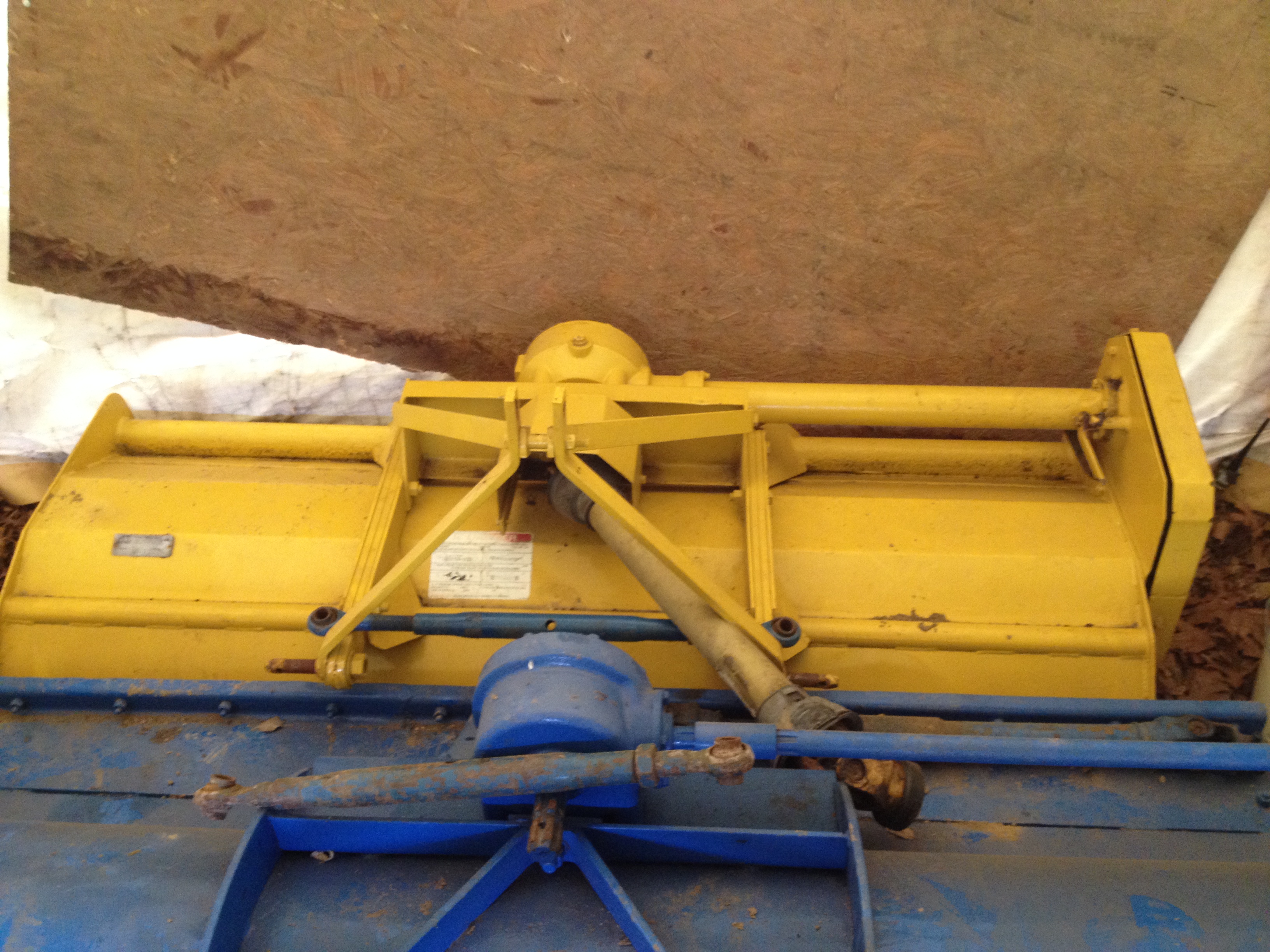

Great match. Great brand. Reasonable price considering what they cost new. It would be nice if you could see it spun up to insure balance and bearings are ok but so long as it doesn't look beat up I'd take a chance on it myself.
I ran a 7' Ford 917 on my L3200. I'm sure it would lift a narrower mower fine as the 2501 is the same frame as my old 3200. Power should be fine.
As long as the rotor isn't warped you should be fine. None of the mounting brackets on my 917s rotor are anywhere near straight. Beat to **** & still runs ok or decent.
/ Let's talk flail mowers #4,712

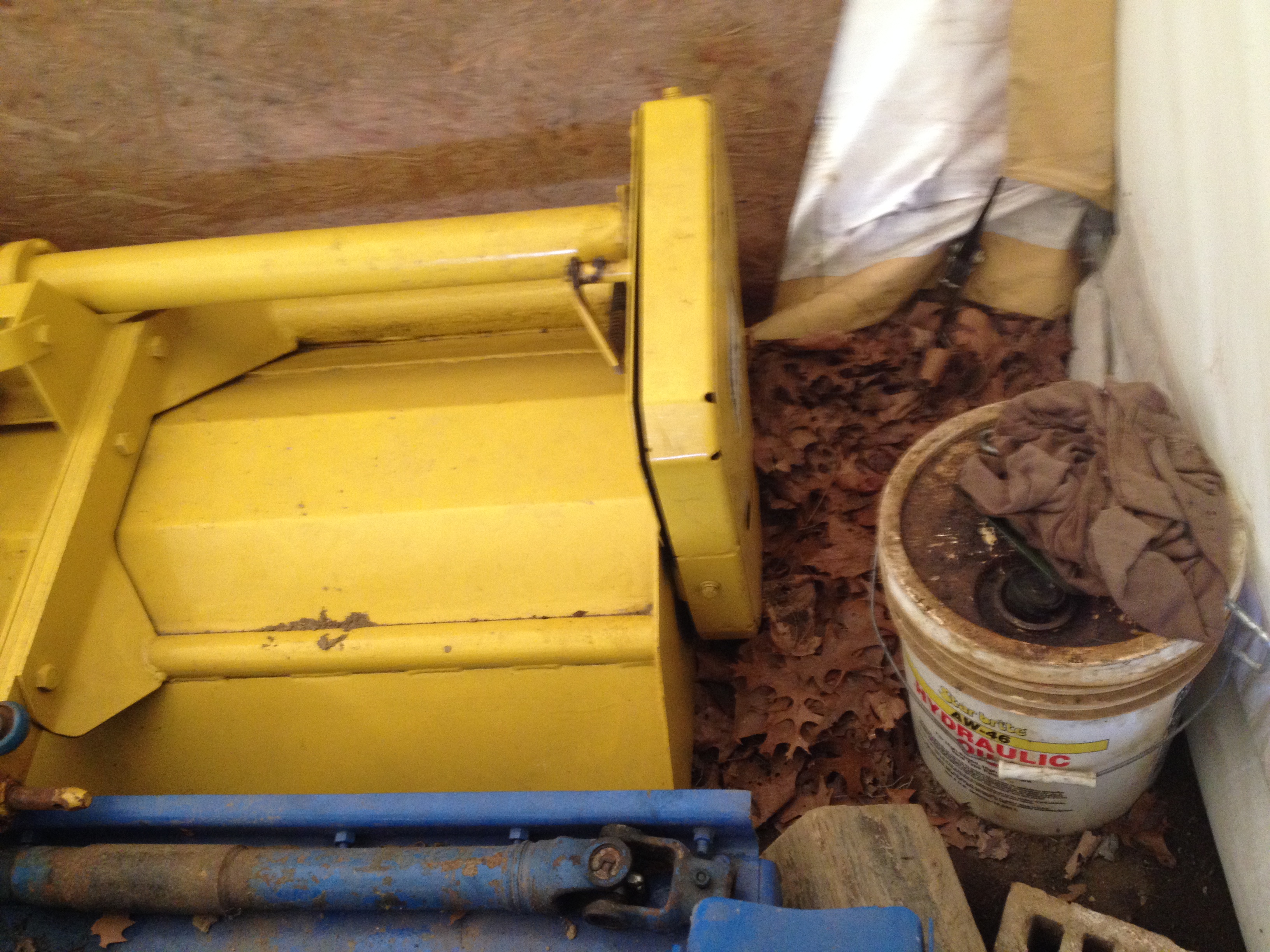

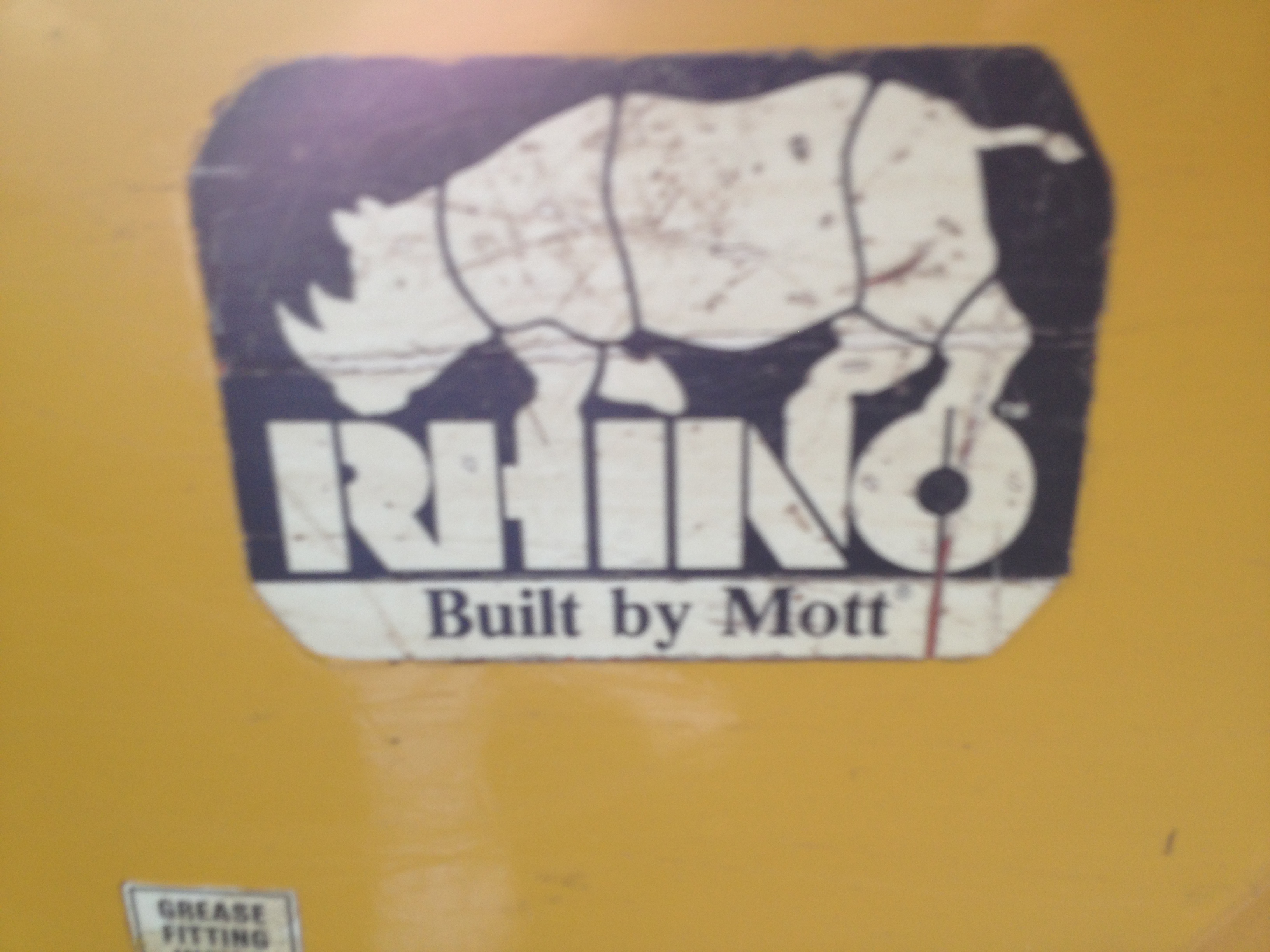

Mower was in pretty good shape. Out of the 76 mounts two were missing blades. Didn't seem to vibrate that much but I don't have a new Mott j60 to compare it too since they were probably last made in the 80's sometime. It was missing a roller bearing on the rear height adjusting roller. I ran it over my property and it cut without any issues including a few tree branches and a 2 inch sapling "stump" I had cut a while ago and couldn't see.
The only odd thing is that in the manual for the j60 it says to run the PTO at 1000rpms and any slower and it may start wrapping the grass instead of cutting. It cut fine with blades duller than butter knives when ran at 540 off my HST. Running it at x2 that speed seems like it would be insanely fast.
EDIT: No idea why that is upside down. It is right side up on my computer.
/ Let's talk flail mowers #4,714
You probably took the photo with a phone in landscape mode but "upside down". Some computers are smart enough to make the corrections but the TBN database isn't
When I click to see the larger image it displays right side up. :)

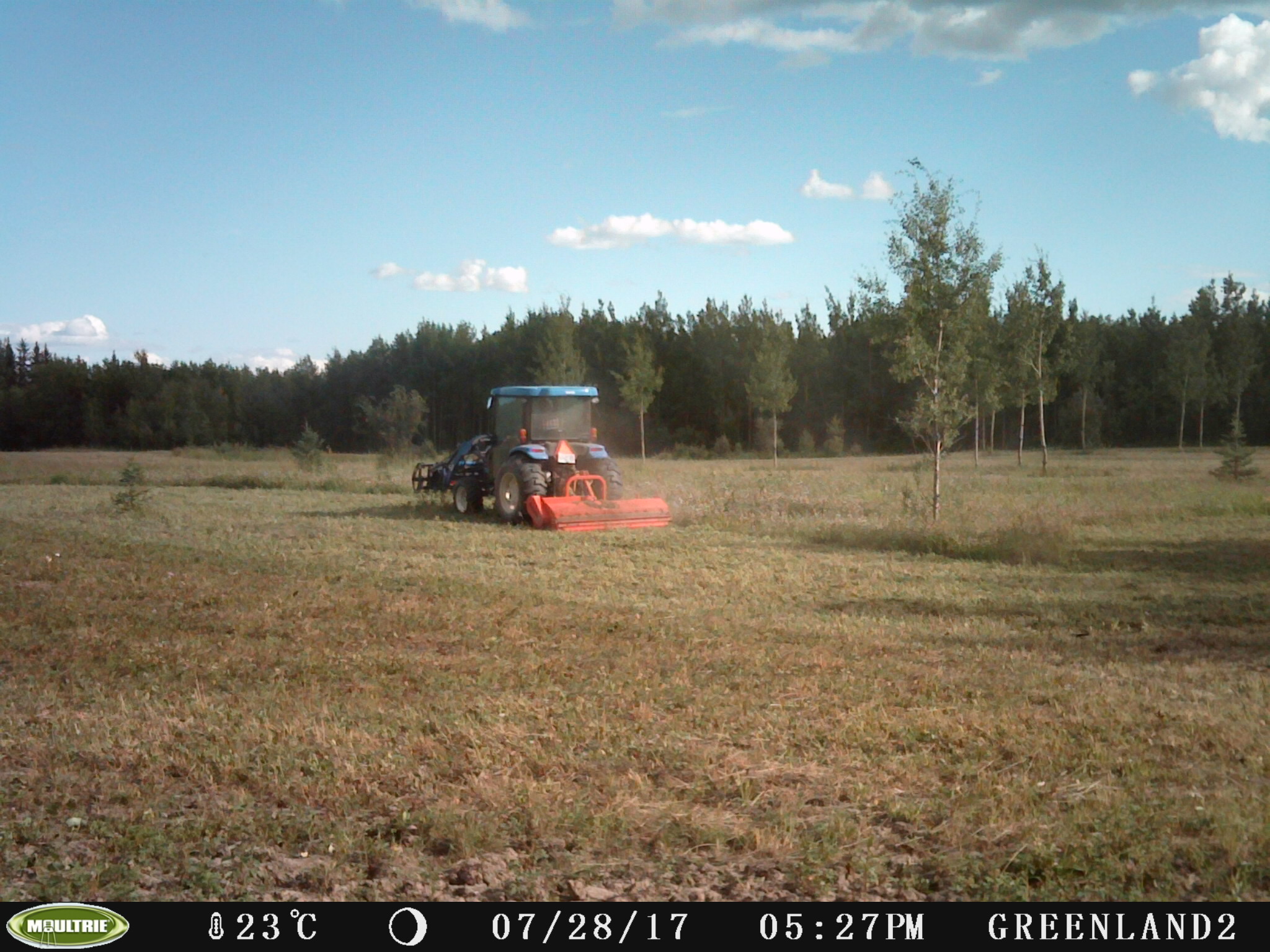

A few picks of a portion of the 40 acres I mow starting near the end of July. I used to do this with a tow behind my quad rough cut. The tractor and flail are far more enjoyable.
