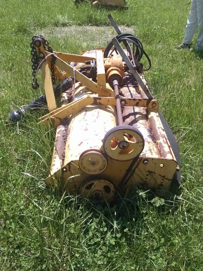

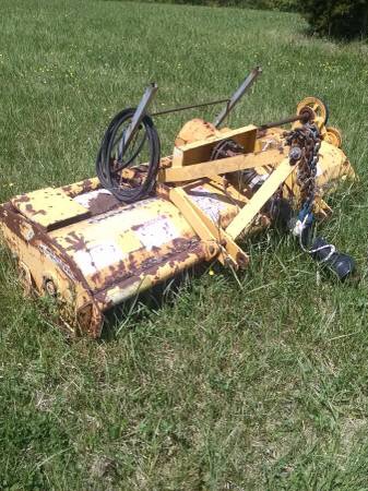

Ok guys I found a mower I want to buy. Listed as an Alamo 72" flail for $600. Owner says good shape, operational condition. Knives and belt are good. Was used for road mowing and hasent been used for the past few years. Says it comes with some spare belts and parts and knives.
If it looks in good shape I'll take it home. What do I look for and if I get it home what's the first few things to do before using it for the first time?
Where can I get a manual for it?
Is this a good mower for pasture mowing?
/ Let's talk flail mowers #4,754
I can e-mail a mott manual to you if you like.
I also have a detailed explanation of what to look for and how to look when buying a used flail mower.
I also explain how to take care of the mower in detail as well.
I would definitely ask where the V belt guard is for this mower as they are not cheap to replace.
It needs a bit of work but until you tap the mower shroud at the weldment's with a heavy hammer to see whether it rings solid you will not know how intact it is.
The PTO shaft will have to be removed and the slip clutch freed up as well.
Please look for the ID plate as well and post an image of it if possible.

View attachment 519623View attachment 519624
I have a Mott SHD88 and it works great for pasture mowing. If everything spins and seems balanced $600 is a great deal. Bearings, knives, belts and other parts can easily be obtained from several sources. I love mine, I use it for pastures but also have used it for clearing trails in a former pasture that is growing a lot of brush and sumac. It's been a workhorse.
One thing I found on mine after I bough it was that it had some cracks in the steel around the bearing mounts on the drive side of the shaft. You may want to look, to see if you can see anything there but mine had been used pretty hard and I have used it pretty hard after repairing it. Even if you ran into the same things I did I would still say $600 is worth it.
