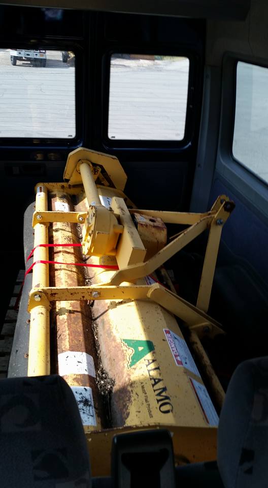

I finally flagged down one of the crews that do our county roads. They switched from rotary to flail for the typical safety reasons. He said the rotary was faster a 5mph vs. 2mph for flail but the rotary made a lot of clumps. I was interested in the PTO speed; they use 2,000rpm engine speed. I didn't pay attention to the brand (yellow) but the tractors are big-azz JDs. (A/C, tinted cab, radio ... still, I don't think I could do 2mph x 8hrs a day)
Jim
/ Let's talk flail mowers #4,813
Jim
The Engine RPM /PTO RPM ratio will differ by tractor. Larger engines may be slower in RPM then most compacts.
So this ratio is more an apples to oranges comparison then an apples to apple...

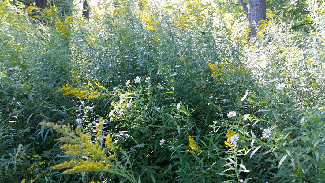

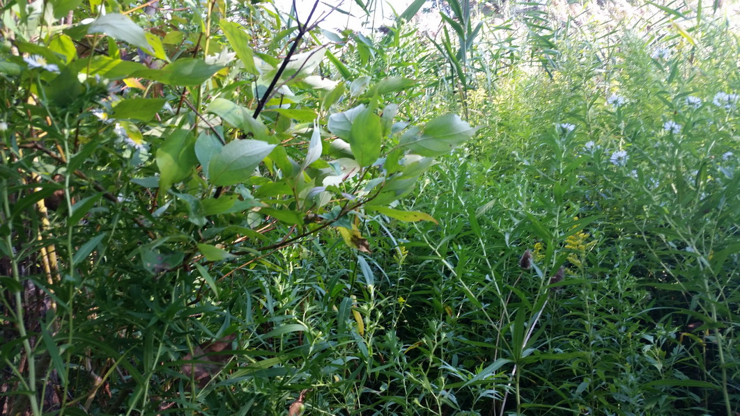

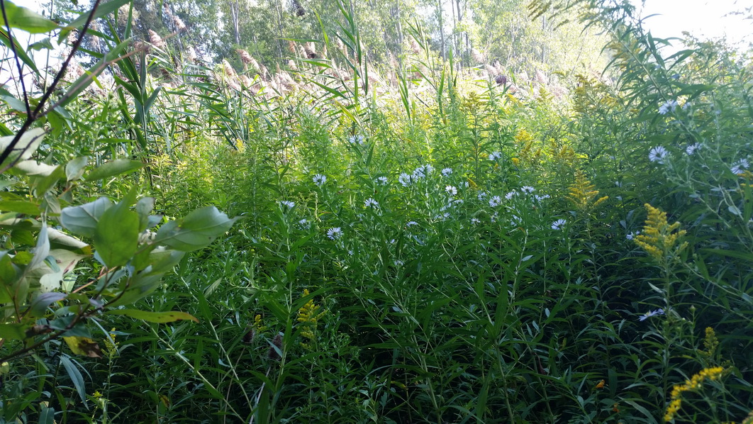

Thanks Leon
As I mentioned earlier, the dry clean lawn fescue type grass is less than knee high, 8"-10". PTO speed at 540 or a hair less. Mowing speed 3-4 mph. ( My fuel usage has almost doubled compared to the brush hog or finish mower)
This is what I'm mowing

Thanks Leon
I can tell you from my personal experience that you need to slow down your travel speed with that height of grass. That is why you lost your first set of belts. The scoop knives should help a lot if you intend to mow only occasionally.
Your pulleys are fine and the flat snubber pulley is in proper tension with the supplied OEM spring as the V belts should not move more than an 1/8-3/16 of an inch with the push of a finger as the snubber is designed to react to loading on the rotor.
