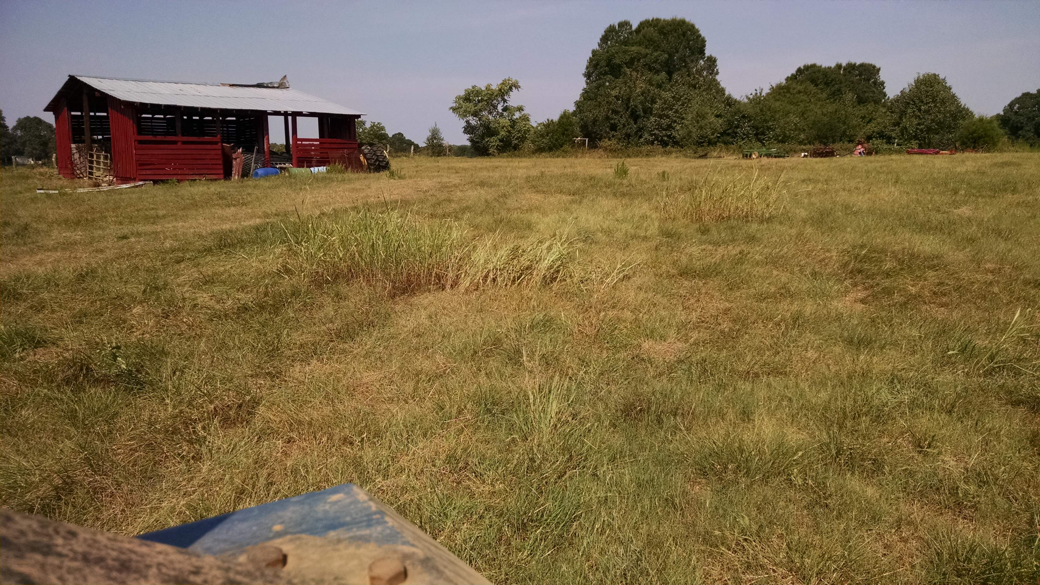

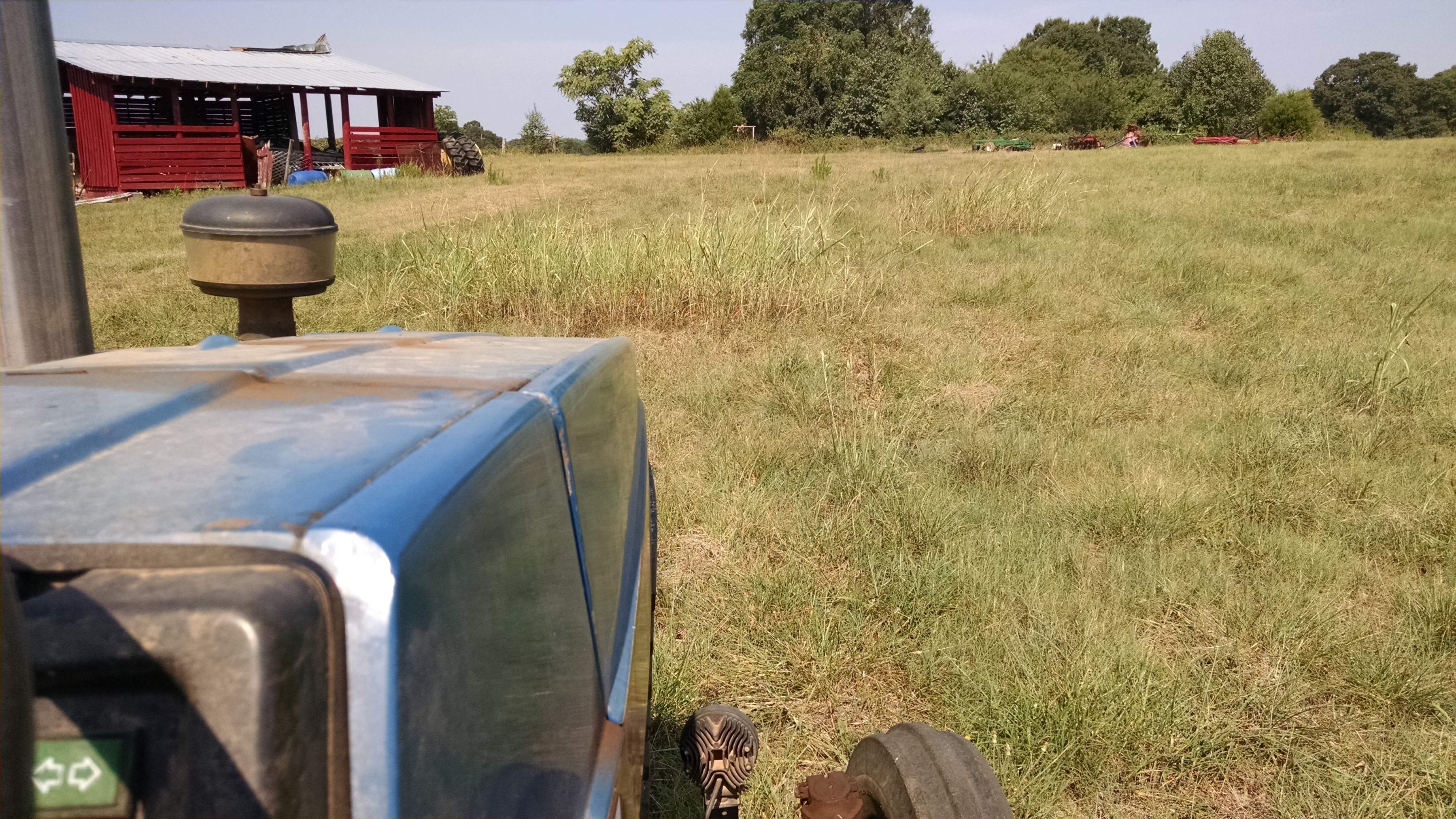

I been tryig to find a happy place with my Caroni flail. With the standard JB top link the upper mast of the mower was canted forward ~10-20deg. A couple of days ago I bought an XL top link at the tractor store ($39). Here's what it looks like now...
Background: My front pasture is ~5ac and 'fairly' flat with no rocks, stumps or other obsticles. I had been cutting it with a 5' brutish bush hog or 72" finish mower by Bush Hog. It gets too thick and too long for the finish mower and the old bush hog simply clubbed stuff to death and made massive wadds of dense matting that nothing grew thru. It appeared I needed to either bail or burn this at the end of the summer - neither was attractive. I sold these mowers; they paid half the flail's bill.
I'm still struggling to find the perfect combination.... With the mower front-to-back level I felt I was getting an imperfect cut because if I raised the mower for ground clearance it was like trying to level an uneven roadway with a fixed back blade ..lotsa Up/Dn. If I rode closer to the ground the skids were cutting furrows... I thought the ideal was if the mower rested on the rear roller so that is why I got this XL top link.
In the one hour test, it does do better. The skids are less of an issue. (I may remove them to see that result...) I am still getting skips on tallish, thin grasses. I am still getting some points where the mower seems to suffer from indigestion. I am also trying to drive in 2-low (geared tractor). I really do not want to stay out all day in 1-low. My tach needs the cable replaced so I am driving by ear. Do these flails need a lot of spin? I gather it's spin and forward movement that needs to be happy together, but I don't seem to know where that is yet.
Jim

Jim, a couple of thoughts: First, you still have one notch to go to fully raise your skids. I hate skids so mine are all the way up. Second, that toplink does look a bit long. The mower shouldn't need to tilt backwards as much. Third, I always have the rear roller in contact with the ground unless in very thick brush that I am backing into and even then I lower it before I drive forwards again. I cannot think of any other reason to have the rear roller off the ground while mowing.
I'd experiment with different holes on the tractor for the top link. Try it in the slot (that's where I keep mine). I have a hydraulic top link so can and do adjust it easily but you should still be able to get the right setting with the standard one. I cannot help but think that topping lift is just too long as you have it in the photo.
I have mine set so my skids never touch the ground, the rear roller is always in contact with turf and I fiddle with the topping lift to pivot the mower to get the cut height right. I use the 3pt mostly in the full down position but in thick grass sometimes have it slightly higher.
Others setup their mowers differently. I am mostly in fields knocking down annual growth and brush, not trying to maintain a perfect lawn. Leonz may have some suggestions too.

If I may offer my take on adjusting your flail mower or most any kind of implement. First I don't want to sound as if I'm disputing any suggestions already given you because I've received a lot of good information from a lot of folks much smarter than I. So here goes:
1. With the mower resting on the rear roller and the 3 pt lift arms connected take your top link off the mower side.
2. Raise your 3 pt lift slowly until you have it looking level from the side.
3. Put your top link in the slotted hole and adjust it until it's half way of the slot.
4. The position your 3 pt lift arms are in will be the position you should cut with the mower.
If your cutting height is not what you want, adjust the rear roller height either up or down then you'll need to adjust your 3 pt lift arms a bit so the mower looks level again and you may have to adjust the top link so it rides in the middle of the slot again.
Your 3 pt lift arms will hold the front of the mower while it rests on the roller. The rear roller should always be on the ground when cutting. The top link will come into play when you need to lift your mower. Having the top link in the middle of the slot will allow your mower to pivot a few inches and follow the terrain. It will only pivot a few inches then catch itself after it runs out of slack in the slot. Most of the time that's all that's needed to get a good cut.

Adding to Island Tractors and Steaves comments;
As I do not have my copies of the caroni manuals in front of me:
I believe you can extend the lower mounting arms one or two holes forward
to level the flail mower to solve this problem.
Happy mowing.

I've looked at my Caroni manual. Pretty useless manual as far as operation goes. No guidance at all in fact.
The 3PT tractor arms attach to "intermediate" arms (about 1/2" plate 3x8" or so) that are in turn pinned to the mower in slots. Each has two pins attaching it to the mower and only two pin holes in the slot so there is only one way to attach those intermediate arms. No adjustment is possible forwards/backwards. You can move the whole mower sideways by using the extra set of slots but that only affects offset.
I'm still thinking the main issue for JimCan is that the topping lift is too long. If that were shorter and the 3PT lowered a bit I think the mower would be riding on the rear roller and roughly in plane with the ground.

IT and Steave. I appreciate the reply. I shudda taken the pic with the mower resting on the ground... None the less, I previously ran the unit 'level' ...with a bubble level to be sure. The top mast was leaning waay forward and the skids were level. But, the skids were cutting or riding the ground too hard and the roller did not seem to be making contact. I needed elevation but I cannot get it by lowering the roller; it is fixed. I figured I 'rock it back' onto the roller by raising the front - hense, the new, longer top-link. I don't need a 3" lawn cut for the pasture, just need to supress the weeds.
My next test is to pull the skids forcing the roller into full contact, then check the cutting height and vary the lenght of the top-link to see what I get. (I'd almost like to see what I get without the top-link attached when the unit is totally fully, self-adjusting/trailing the tractor...) Thanks again. Jim

Skids are there to prevent the rotor & to some lesser degree the knives from hitting the ground. They should only ever hit the ground in rare circumstances. Generally you want to have the skids raised all or at least most of the way up. If the skids were raised all the way up & still digging, ya, definately level issues to sort things out with the 3pt & roller height adjustments.
My ancient Ford 917 flail has a non-adjustable roller & skids (welded in place years or decades before I acquired it). So I'm stuck with 3pt height & toplink length to sort out cut height. On my L3200 I just left the hydraulic toplink in float, but no hydraulic toplink on the L4060 for a few more months. The 917 floats with some floating lift links rather than with anything on the toplink.
