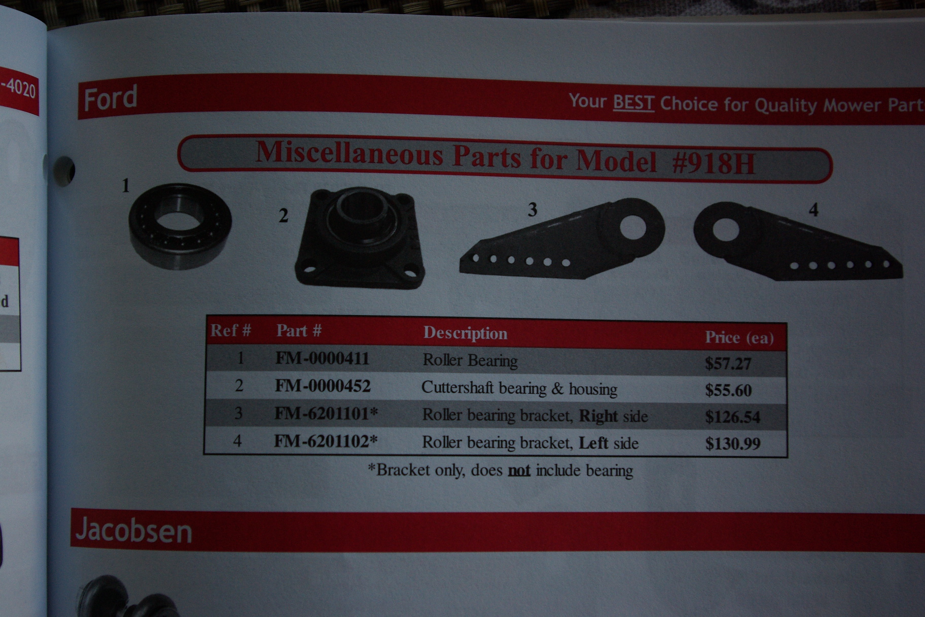

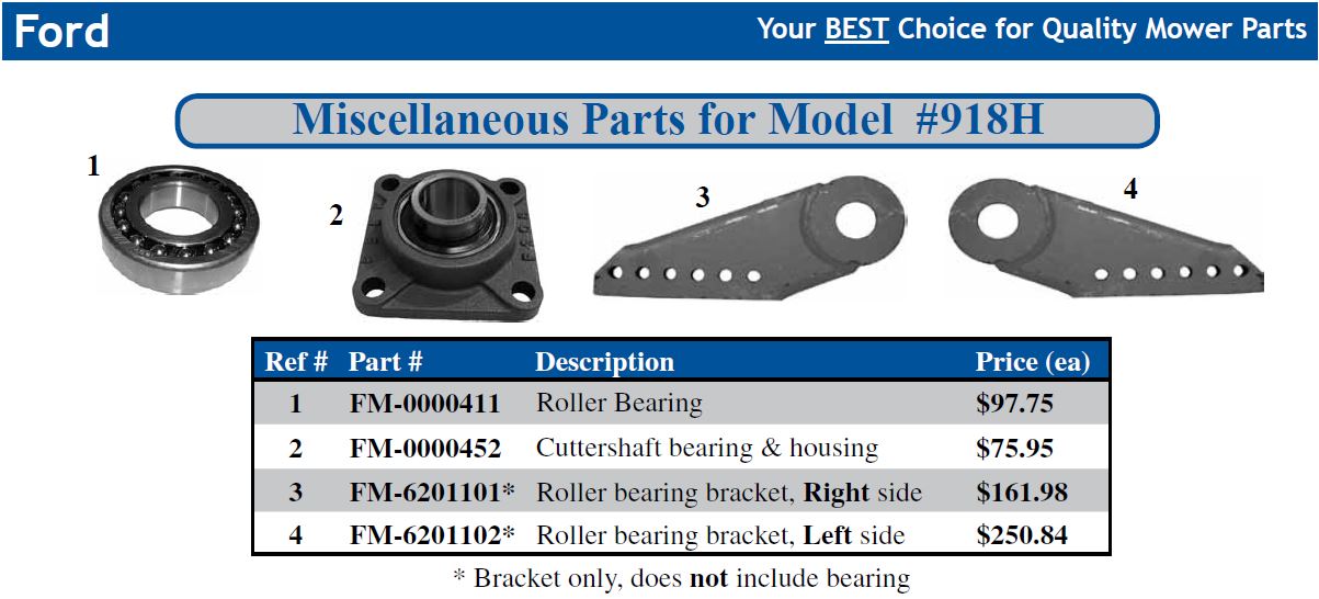

Found a 2007 Flailmaster catalog and this is all they show. Makes me wonder if yours has been turned down to 1.25 at some point in time.
/ Let's talk flail mowers #4,425
Perhaps the previous owner had a bearing freeze up and turned​ the end down to be true and round?
Wow. Prices sure have jumped up in 10 years. Bearing $57 to $97 (+70%) and side housings up from $257 to $413 (+60%)
The Caroni is starting to look better tonight.
