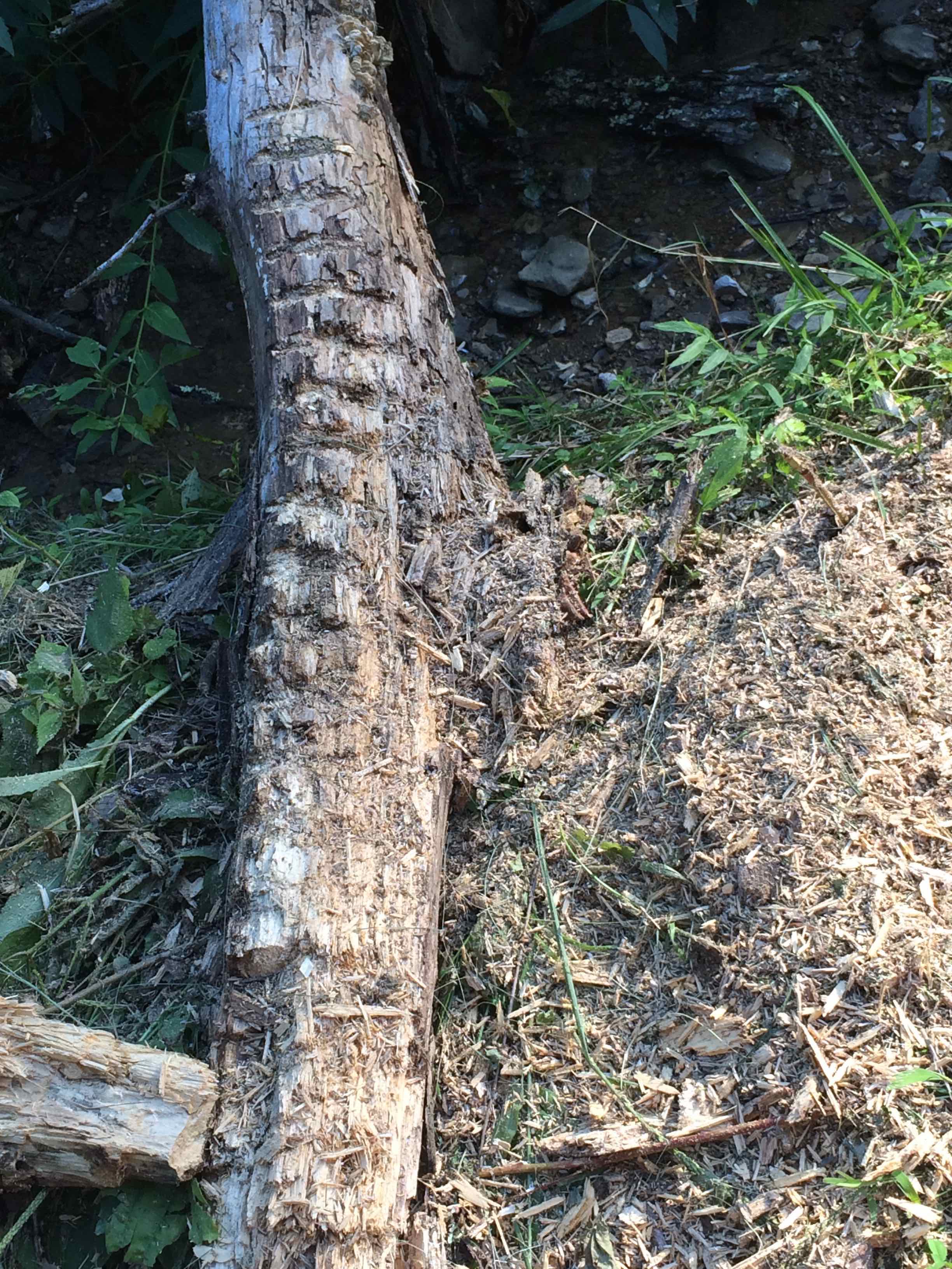

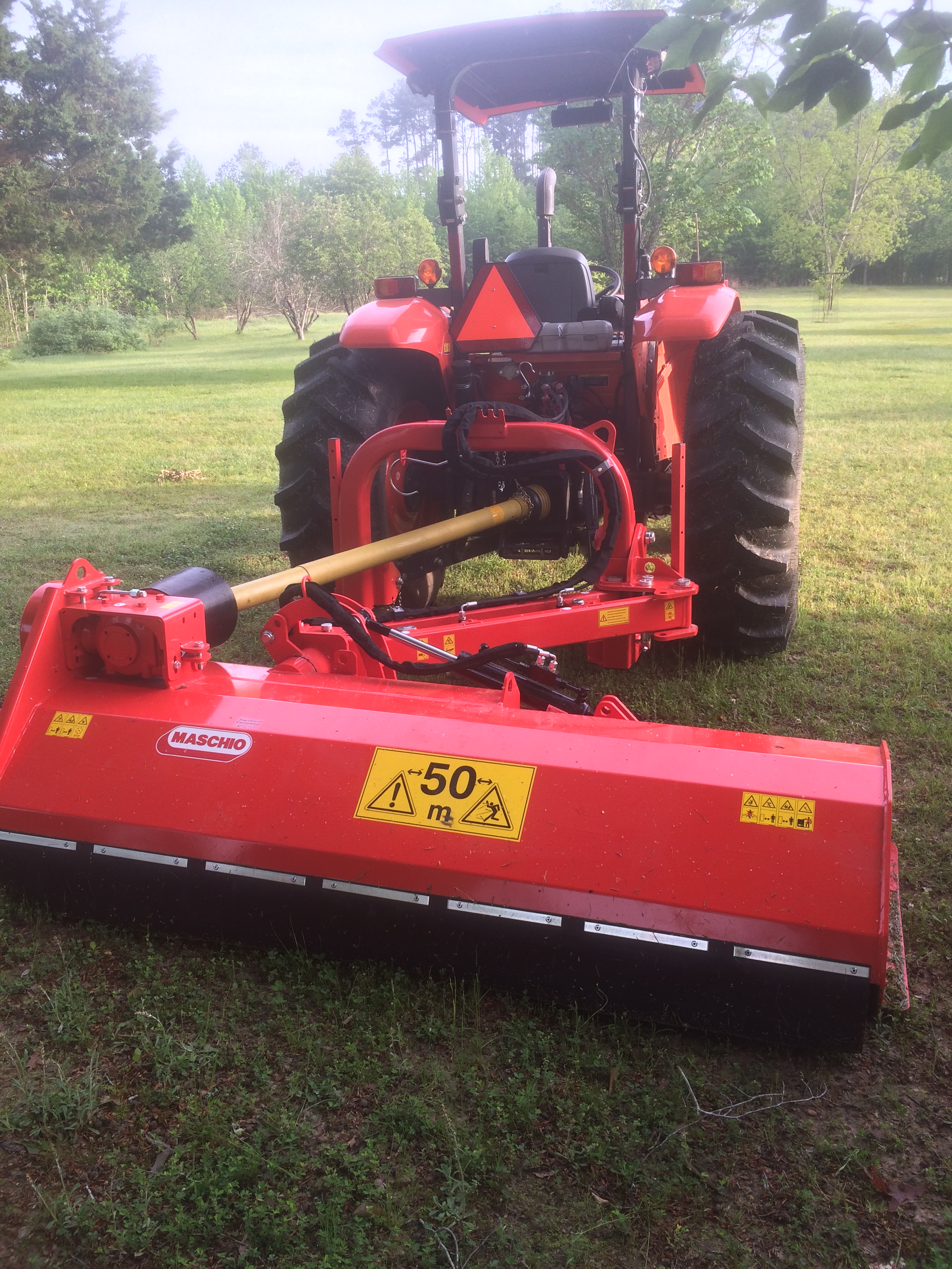

well, I am now the owner of a flail mower got the Maschio 210SI. Very impressed with it, it chewed cypress knees even with the ground. When I was almost done, I found the soft spot beside one of the ponds with only about 100ft left to mow. My neighbor came over with his orange tractor and pulled me out :thumbsup: IMG_1912.JPG

Does your tractor have diff lock?
Seems like 4WD and diff lock would have pulled through that soft spot.
/ Let's talk flail mowers #4,385
i do but the ground was like walking on a water bed on the right side of the tractor i was able to push back about 2ft back with the loader the mower was on the ground in the out position and could not get it to move back to behind the tractor and really didn't want to tear up the edge of the pond any more than i did
