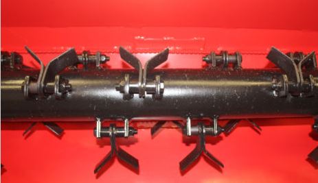

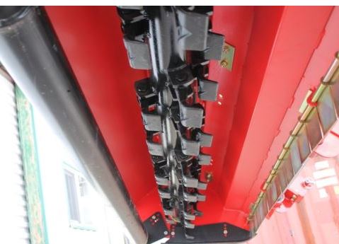

The large rocks are the size of boulders. Our dozed couldn't move them. The smaller softball size rocks constantly get uncovered due to the 200 inches of rain a year. That's one of the reasons for mowing so often so you can see the rocks and avoid them.
So is the upper picture considered the hammers?
Yup! Get rid of the large rocks first. Any rock that sticks up more than an inch or two out of the ground should be removed. I had to remove a couple dozen 100-300# boulders from my pastures before I could get them under control and some still work their way to the surface each year.
Hammers work great on pastures and fields. As long as you don't want a finished golf course look, hammers will do a good job. Get the best one for your situation as your L6060 should handle any of your choices. However, I suggest you get one that is at least as wide as your outside rear tires width, i.e. - greater than 72" (180cm). That way when you shift it out it moves out past your tire.
/ Let's talk flail mowers #4,454
I see ... so your large rocks are rooted in Middle Earth. LOL
The upper pic looks like it could be one version of hammers OR they could be duck foot blades. Someone with better eyes might be able to tell the difference. Hammers are heftier than duck foot knives. Smaller hammers weigh close to 1/2#, the larger ones can weigh 3 times that.

Actually they are what are referred to as scoop knives. They are sometimes described as duck foot knives.
Traditional flail hammer knives for orchard and Vineyard use are cast iron with a wet ground cutting edge(if they were made the right way).

Yes it is their type of flail hammer knife for their flail mowers:
