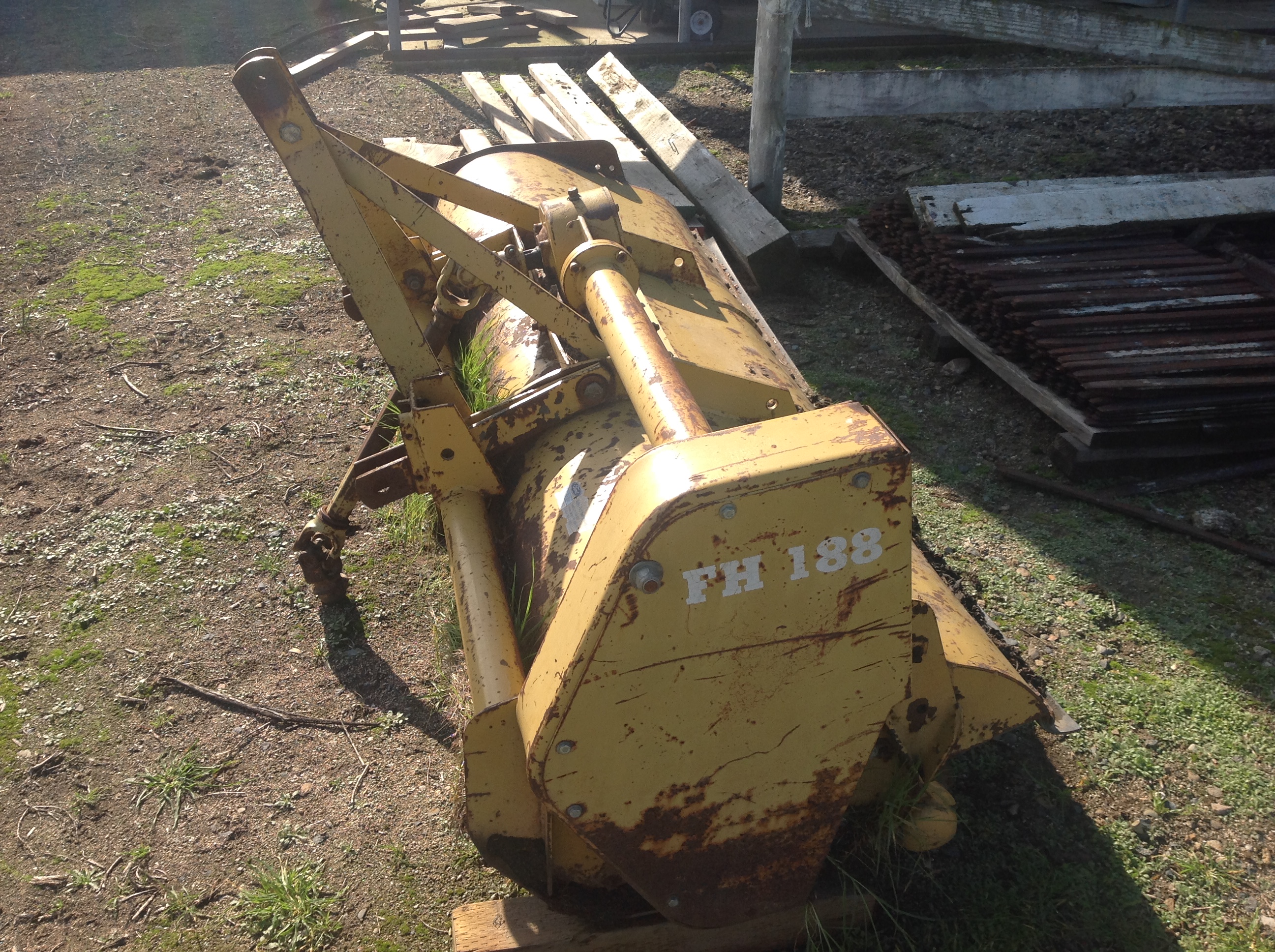

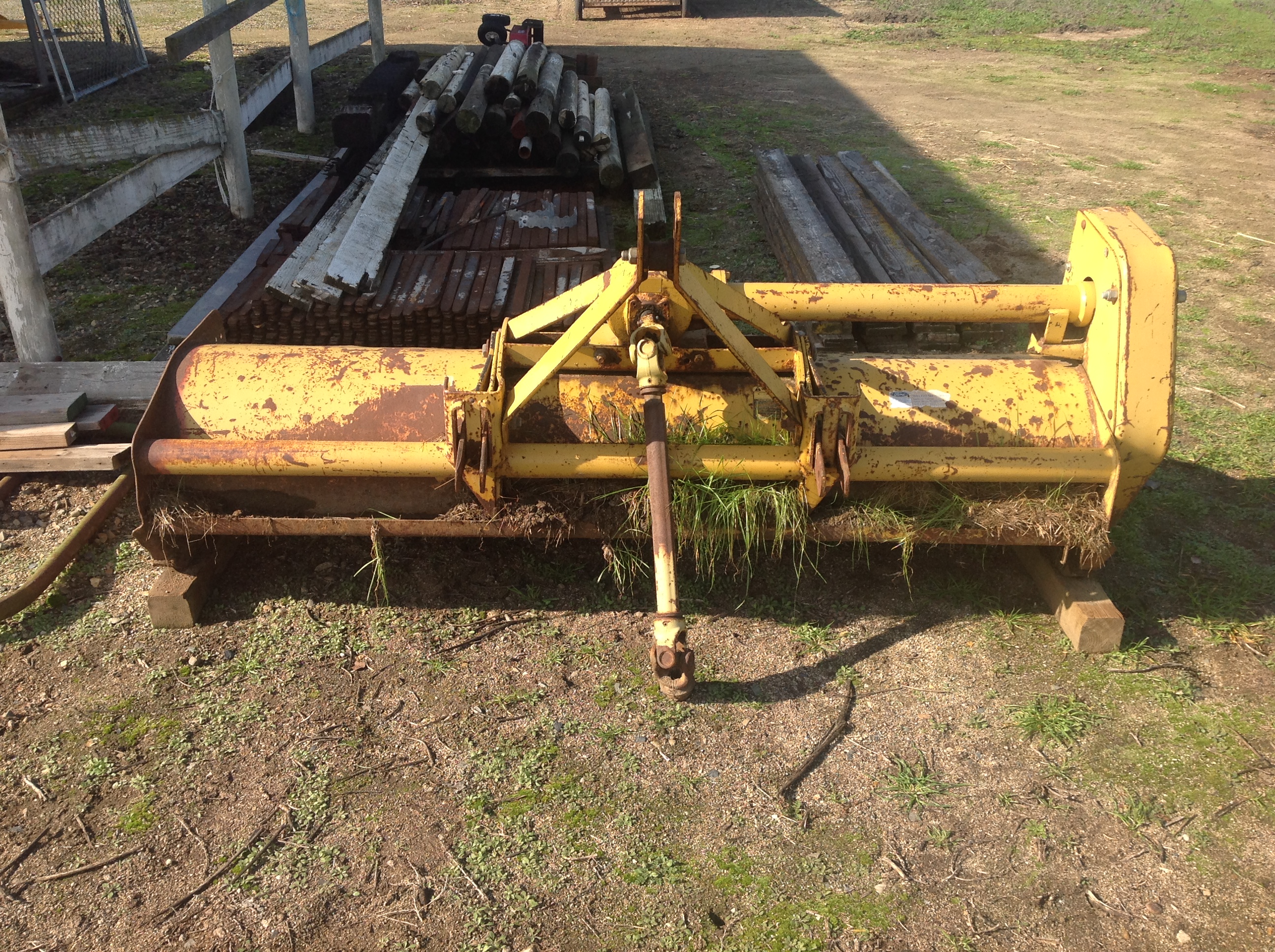

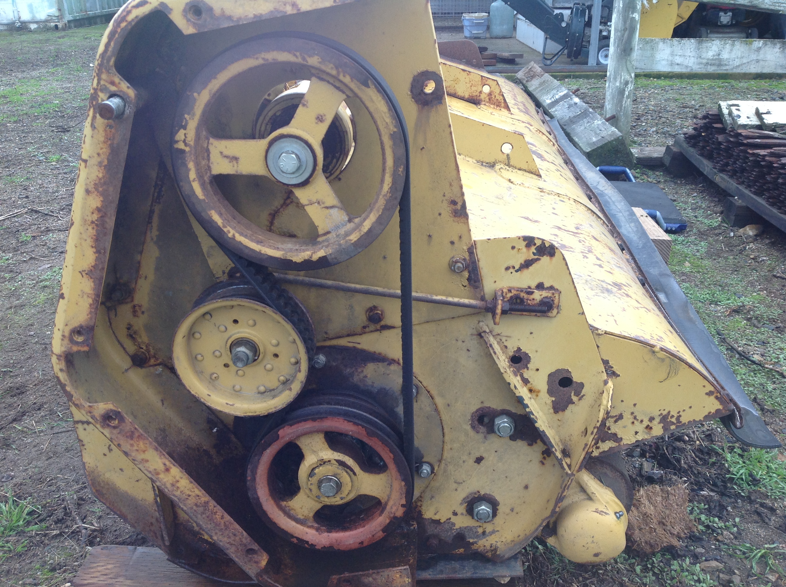

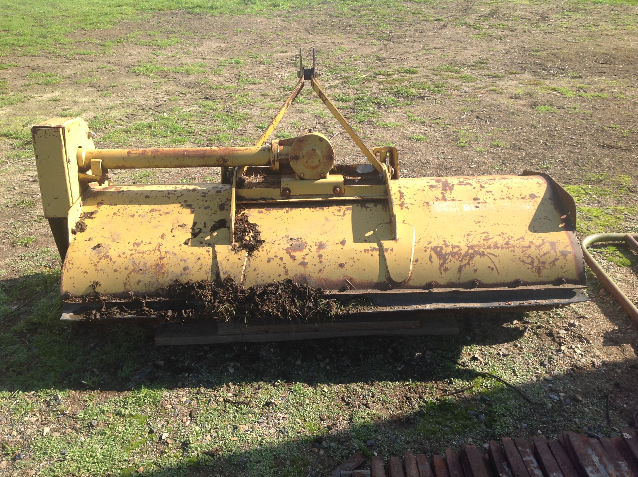

Hello, I have this flail mower and I would like to find out how much it weighs or where to search for a manual or rated PTO hp needed or any specifications. Thanks in advance.
Brush Hog
Model FH188-**01 After the 188 it appears to be 62 scratched out and someone wrote 01
It measures 78" long

That looks exactly like my ancient 7' Ford 917 flail. Same floating hitch, gearbox & belt cover. Technically mine is a 917 22-184, but there were a pile of various widths (the 84 in the model is 84", or 7') and various revisions over the years as it changed from Ford to New Holland & what not. You can find parts at Flailmaster & parts & a parts diagrams at Messick's.
Mine is a 7' model & was oversized for my 32hp Kubota L3200. But in general you can lift it you can spin it. I had to go slow but the L3200 ran it fine with 25hp or so on the PTO. It covered acres equal to or better than my 5' rotary due to the extra width even going a fair bit slower. And going slower is easier on you & your machine.

Four years ago I purchased a Used MF 30B tractor and the guy sold me this flail mower, I bought five acres and needed to control the weeds, I got the tractor home started to cut the grass/weeds and the tractor stopped working 20 minutes into the job, after diagnosing the problem it was the Diesel pump, I dropped the flail mower in the field and towed the tractor with my pickup into my barn to work on it, four years later and I still haven't fixed it. So I bought a new JD Compact and was surprised that it picked up the flail mower and I was able to get it out of the field where it has been sitting for four years. Time sure does fly by when you have so many projects and so little time.

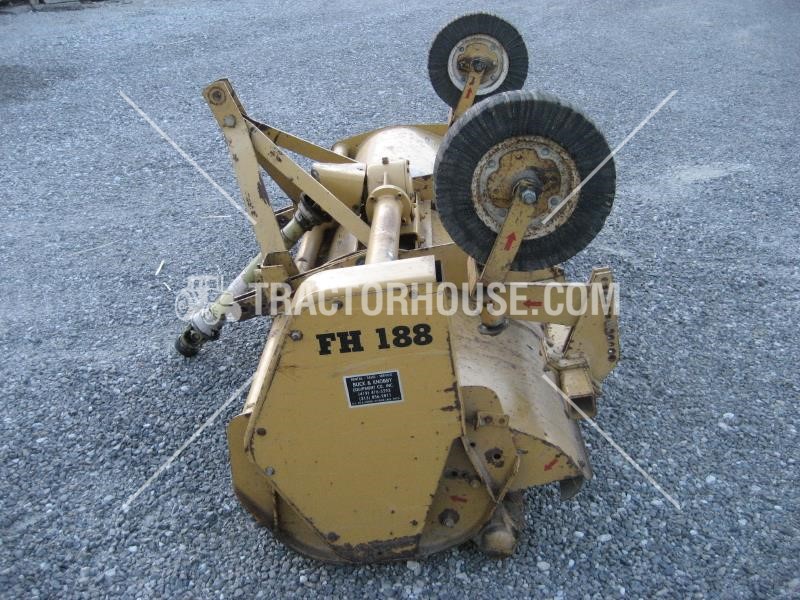

There was another picture I seen where there was two big rubber wheels at the back that would seem more practical for an uneven field, do you know what the big metal roller on the back does.
Do you think I can use this flail mower on my JD2032R, how would I protect the PTO from damage, slip clutch or sheer bolts.

If ypu can lift it, you can spin it. You already indicated ypu can lift it, so give it a try.
The belts on a flail are the protection, they will slip if there is a jam.
All flails have that roller to control height. Only a few come with tires. Mine came with the frame & rusted rims. Never bothered to fix em up or get rubber on em. Runs fine without em.
Just grease up all the bearings (my idler pully isnt greasable, some aren't) U-joints & PTO shaft and make sure there is lube in the gearbox. There should be 90wt gear oil in there, but I put in pourable grease when my seals started leaking rather than spend $70 or so for new seals.

I'm puzzled. Cant you just weight it with the good scale set up you have like you did your tiller in your other thread?
Have you tried Bush Hog(R) Performance You Can Count On and contacting them. Many times you can get manuals for free. Here is their contact page Contact Us Also in one of the photos is a Ford label so Fallon may be on to something.
Hope this helps

Thanks powerscol, yes I can weigh it but the weather man has predicted rain for seven days straight so I was looking for an easy answer, when I picked the flail mower up it sure was leaning to one side a lot. But thanks for the other info I'll check them out.:wave: my FEL has a capacity of 1,020 lb at the pivot point so if the flail mower is less than that I can weigh it. I found a photo of the wheels I was talking about, they seem more practical for uneven fields, I'm guessing that's what they are used for.

If you have the rear wheel mounts investing in a pair of them will only help you in you mowers use as quite often they were used to do stabilize the mower while mowing and allowing a smaller mule to be used for mowing and some of them were designed to towed the motorized Mott flail mowers that were used to mow large overgrown areas.

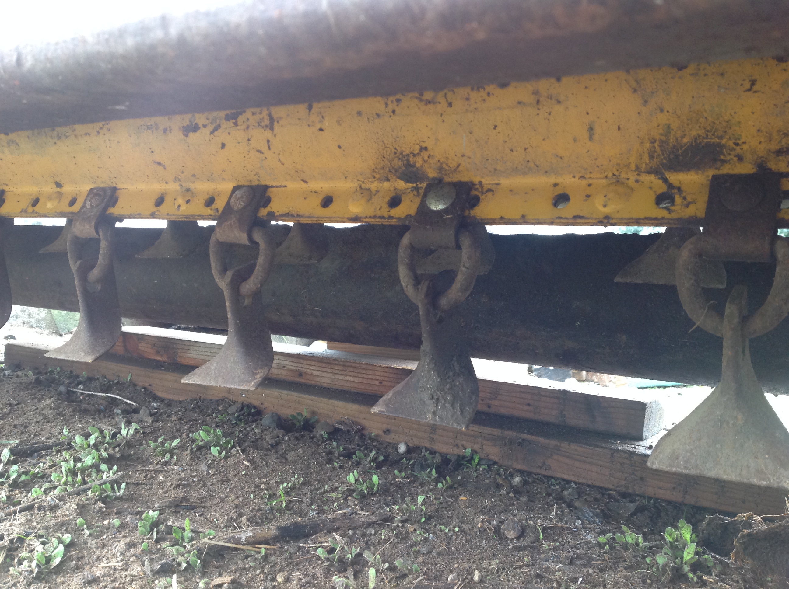

These are the paddle blades on this tiller, I will be using it to mow a field, how do I know if they are any good, can they be sharpened or do you just replace them.
/ Let's talk flail mowers #4,015
View attachment 494604View attachment 494605View attachment 494606
The blades look fine. No dings. If you are just field mowing you are probably not concerned about having the cut resemble a fairway at a fancy golf course. No need to sharpen before you mow. If it were me I would never sharpen the blades for field/pasture cutting.

If you look very closely you will see that they are mounted on the three point hitch.
An integral or towed flail mower/crop shredder is free to follow the ground contour and follows the ground contour better than a rotary cutter or finish mower just as long as it is left in the float position.....
