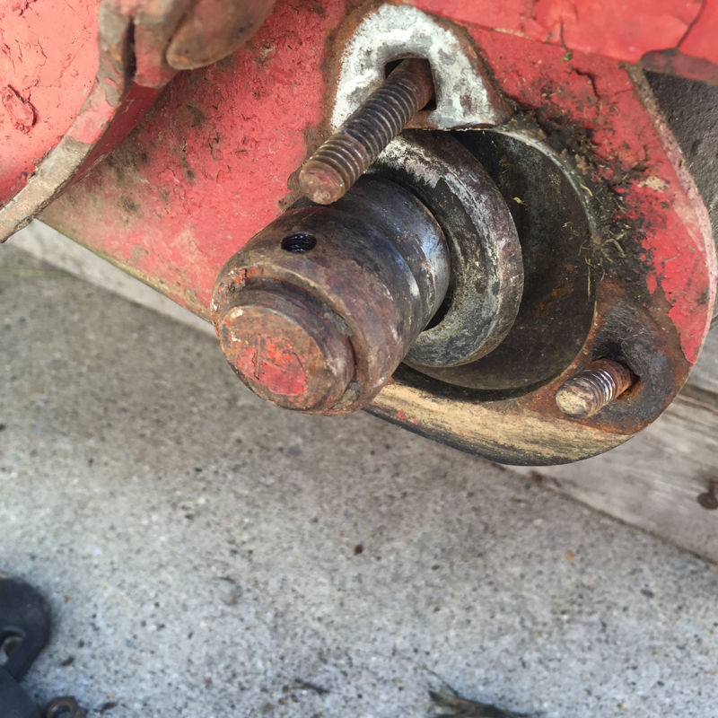

We had a break in the weather so I got a chance to weigh my Bush Hog/Ford new Holland flail mower, it weighed 860 lbs. I was told the belt adjustment should be between 3/8" to 1/2" deflection on the belt, does that sound correct. This is a single double belt and has no spring on the adjustment only a tension rod, You guys said that the belt slipping is what protects your PTO and since I'm trying to use such a big flail on a smaller tractor with only 24 PTO hp should I keep the belt adjustment at 1/2" or more to compensate for the smaller PTO and allow for easier slippage to protect the PTO.

I kept mine tight on my L3200 (25 PTO HP). Never had a problem including the time I mowed my well head. It ended poorly for my well head & to a lesser segree my rotor. The mounting bracket on the rotor was a little bent, but continues to be serviceable and no worse than some of the other rotor dings on there. Its not the smoothest running implement (even after new rotor bearings a year or so later), but i paid $100 for it & now have about $700 into it total. Had to replace a couple knives & clevis especially in addition to the cap on the well.
