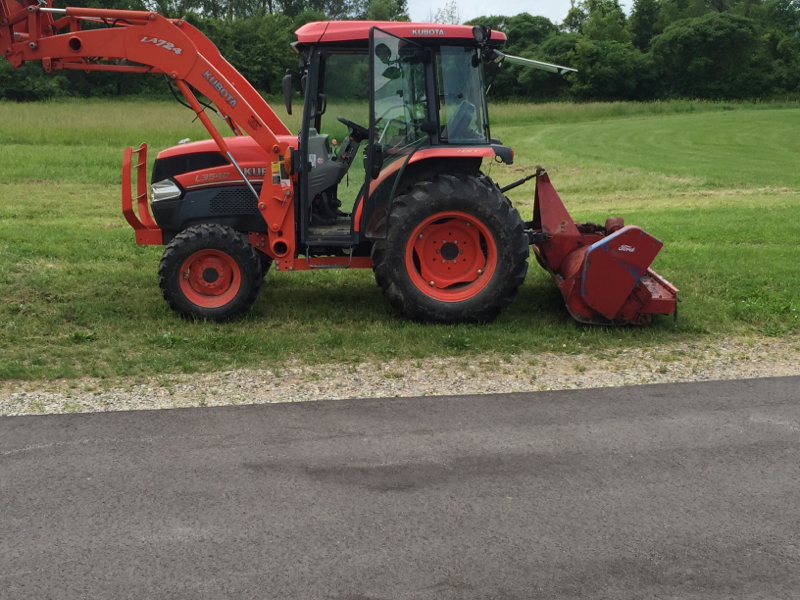

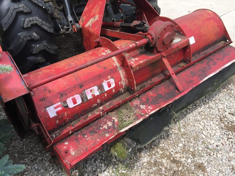

My 5' rotary ran off with my old L3200. Used my ancient Ford 917 once with my new L4060. Given the age of my 917 I've seriously been thinking about replacing it, or at least getting a backup & the WoodMaxx is high on my list. I keep eyeing the biggest Cat1 hydraulic sideshift they have.
Pretty sure the only difference in our machines is you have 20hp more & a Cat2 3pt, maybe bigger tires. You likely want to look at the 2 bigger Cat2 mowers if you go with WoodMaxx. Think the 78 is a Cat1. My 32hp 3,500lbs loaded L3200 ran my 7' 917 fine, although a bit slow in high dense stuff. My L4060 actually ran it as well as my L3200, but it was really tall winter grass with a touch of snow in places when I mowed the once so far. 20 extra HP & no altitude issues (turbo on the L6060 even if you are near my 6,500') means you'll be able to spin a fair bit more mower in denser stuff than me.
I really don't bother clearing branches & have intentionally ran & mowed over several dead Christmas trees & similar sized standing trees. The rotary ate them up better, but the 917 did an OK job despite a bit of noise. The grass side cutters just bounced off the heavier trunk making a little racket & mulched the rest. Duck foot hammers would have likely eaten a lot more of the trunk. If you go slow you should be fine mulching reasonable sized branches.
My 917 with grass side slicers has mostly heald up to occasional mowing of woody brush & occasional Yucca (imagine dipping 2-3 pair kid size blue jeans in plastic & calling it a cactus, would be slightly easier to mow than Yucca). I did blow a rotor bearing on a gig last year. But the flail is as old as I am, so I can't blame that failure on pushing it.
