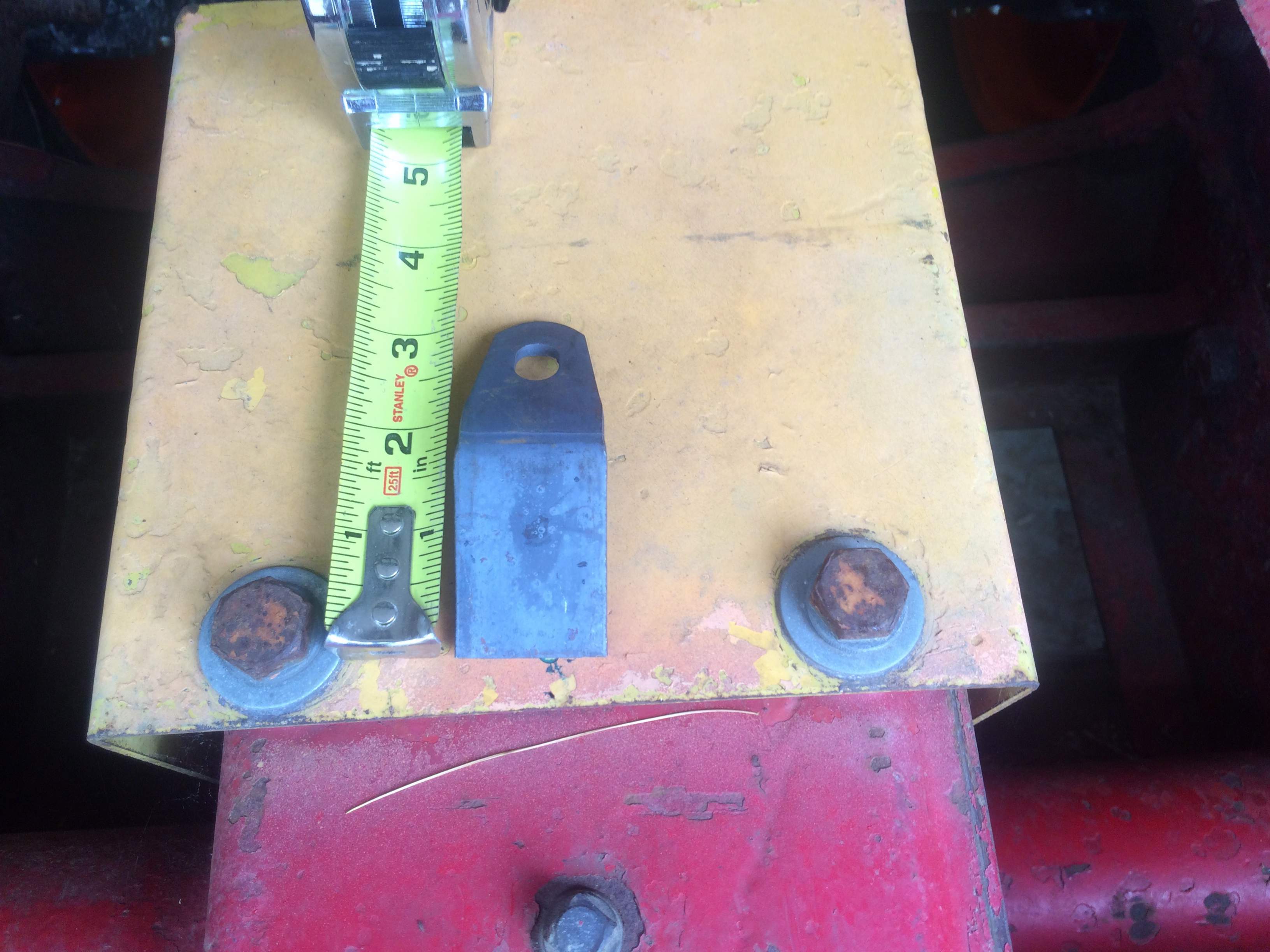

Check for play in the gear box (and oil) and the condition of the bearing and gear box seals. Y cutters are 2 piece per station and T are one piece, Y are for heavier material and brush.

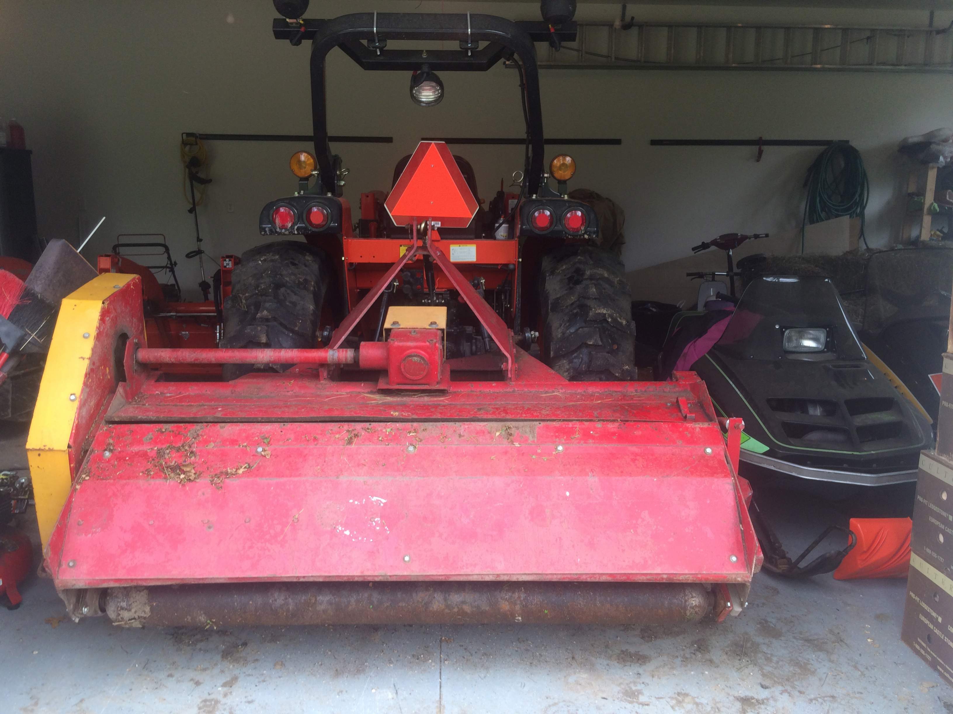

Found a Ford 917 for sale nearby, looks like it is in decent shape from the pics. Planning to have a look this weekend.
Unit is a 22-184 - based on another post, that makes it a 1973-76 74" cut model. Said he put new belts on it and that it has the Y or T cutters. Tractor house has some rusty ones for sale in the $650-900 range. His price is a little more, but said "cash talks".
Am I crazy for even considering a 40 year old mower?
Bearings, belts, knives and the drive shaft? Besides those and rust, is there anything else to check?
I paid $100 for mine, the same or nearly same model. Dumped $400 into new PTO shaft, belts & knives. Recently $75 or so for new bearings. Not to mention several full weekends of work repairing a damaged hood.
I'd do it all over again in a heartbeat if I had it to over again.
Check bearings, gearbox & for collisions between knives & hood. Busted gearbox would be the worst, most others would just be some work.

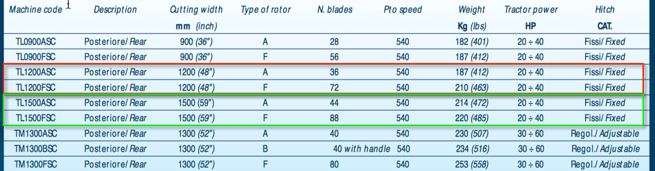

I'm ready to buy, just want to be sure I get the right gear. I was dead set on a Caroni before, but the discussion about the B vs F type rotor made me re-think my needs. I have a ZTR for finish mowing and my wife likes to use it so that's the end of that discussion :-D
F type rotor seems a little wimpy for heavier brush. Hammers look to be more up my alley. Then again, seems like folks do just fine on the F type rotor going slow. IslandTractor has the B type rotor and has many posts about the clevis breaking on rocks with options for replacing with less expensive stuff than the Caroni replacements from AgriSupply. F type has no Clevis, so possibly a less expensive replacement if you only need the knife and a bolt...
Interestingly enough, the F type is exactly double the number of knives as the A type so it would seem you could simply remove half of the flails to have the mower function as an A type...
Be careful how you count. Some manufactures count the number of blades each, so rotor might have 20 stations and 20 hammers, or 40 Y blades (2 blade sections per station), or 60 3 part Y blades (3 blade sections per station) depending on how they count. Maschio is that way - number of mounting stations is the same for the different blade types available. Double check with your dealer.

I decided to do some quick calculations on pounds per inch of cutting length and price per pound of steel in the mower. Results below:
Caroni 59" TL1500FSC: 485 pounds, 59", $2000 (shipped) = 8.2 pounds per cutting inch at $4.12 per pound of mower
Woodmaxx 62" FM-62 (non-hydro for apples to apples comparison): 641#, 62", $2249 (shipped) = 10.3 pounds per cutting inch at $3.50 per pound of mower
DelMorino 52": 540 pounds, 52", $2700 (shipped) = 10.38 pounds per cutting inch at $5.00 per pound of mower
The Caroni with F type knives has 88 knives or 44 pairs. The Woodmaxx with hammers has 18 hammers. More quick math:
Caroni: 20 HP over 44 pairs = 0.45 HP per flail pair
Woodmaxx: 20 HP over 18 hammers = 1.1 HP per hammer
I'm sure I could do some force calculations with the weight of each hammer or pair and the length of cutting surface but I'm tired and already made my decision. Suffice it to say I believe I'll have a lot more force to chop up the heavier brush with the Woodmaxx than with the Caroni. Now, if I wanted to cut grass the Caroni would be the absolute PERFECT machine for the job. Makes sense when you think about the companies > Caroni builds mowers finish, flail, etc > Woodmaxx builds chippers and got into the flail mower business.
