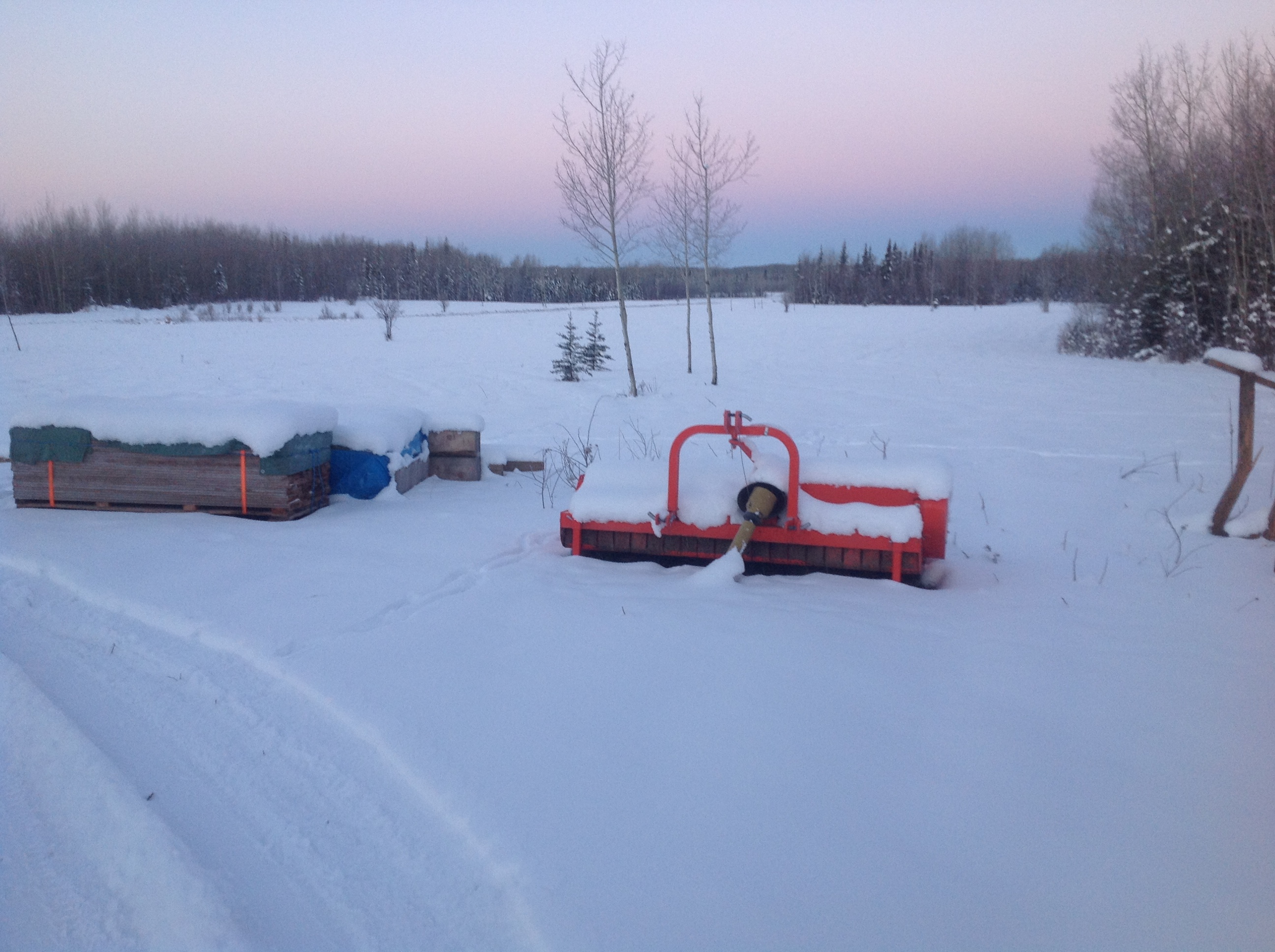

I'm a little jealous of you guys that are still flailing away��

GS.. I beat fall leaves to a pulp.. maybe you should try a pass on the driveway..??? Wonder if hammers or Y's would groom snow better? ..roller packed? Cheers.

Well Jim, look at this way, at least you will not be
running over any sasquatch tracks in the mud now.
