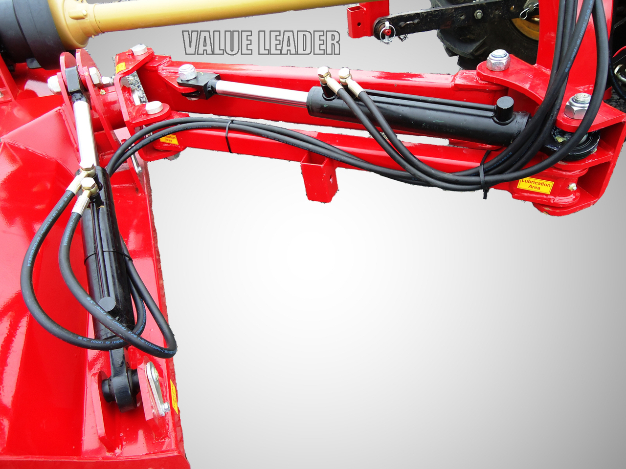

The end of the hydraulic arm is U shaped with a hole through both flange legs where it connects to a pivot point on the swing arms. From the pictures and a similar connection I figured out the washer was a top spacer when fitting over the connection. As the connection also had sides, I was able to lock the nut from turning by wedging a pair of cutters in to fill the gap. It tightened right up. The nut was a lock nut, so everything is good. I did lube the connection up where it rotates before assembling.
I think I have figured out what the 4 brass washers are for - seems strange, but they look to be used when installing the boss hydraulic connections to the cylinders. They show up on the parts diagram. Never run across this before, but will check with IFE in the morning. Most boss connections with the seal installed as part of the fitting, just screw in to a machined female boss unit. Question I have is should I use any lock-tite on the threads. I have the blue stuff available, but not sure if it is compatible with hydraulic fluid - need to read the bottle.
Lousy weather for the next few days, at least down here so Ill get back to it in a few days. Snow up in the mountains :cool2::dance1::cool2::drink:
Thanks for the help

Everything is hooked up and running, PTO Just fit without trimming. Tight spot is when fully retracted. Weight is not an issue, even fully to the side. Once you get past the start up clank (and shut down) it runs with ZERO vibration. Sounds like a jet. Extension gives me plenty of room to sit on the road and pivot down the slope. I do need to lower the roller as can be seen in the pictures on my test cut with the skids leaving ruts. My son is coming for Thanksgiving and Ill get him to help. I also need to add a restriction to slow down the lowering speed - not a big thing.

Let us know what you finally come up with to satisfactorily slow down the lowering of the cutting head. Mine has the same problem and I have just managed to use a finer hand on the spool valve but a restriction would definitely work better.
