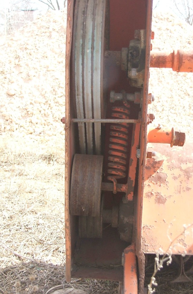

kimaran if you had only one belt broke out of the 3 the rotor should still be turning. You said your rotor wasn't turning so you need to check and see if something is jammed somewhere.
The tensioner spring is somewhat stout and you might have to use a bar or pipe to relieve the tension on the belts to get them off then back on. I think leonz already mentioned replace all three belts.
If your rotor is not turning at all, take your drive shaft loose from the tractor, raise the mower, then see if rotor will turn by hand. You might also have to tie the driveshaft level so it can turn with the gear box on the mower. If not you might have to check farther then post back, somebody might can talk you through what to check. Hope it's just the belts.

Looks like more going on with Kimaran's flail than drive belts. The flail rotor should turn with even one belt. I see what appears to be three belts still on the lower pulley. Normally, when they break they're nowhere to be found. Here's a shot of my Caldwell Barracuda three-belt drive. (The tensioner angle has been fixed with a new shaft.) The tension spring is a monster but will go over-center to allow belt changes. A good leverage bar is needed to move it.
