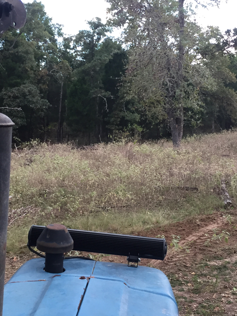

Some of you may remember a while back when o asked about my JD25A. It's old, it's beat to snot, but it needs a roller bearing, and 5 knives were contacting the leading edge of the mower. I tried the heat/beat method, I tried bending, I ended up just using my plasma cutter to remove the offending section. I'll weld a patch back in next summer.
I replaced the 5 shattered knives, pumped it all full of grease per Leon's recommendations (5-7 pumps) which was just enough to squeeze out the old grease.
I've had all sorts of other vehicle problems and other things taking priority, but I finally hauled it to my house last night, unloaded and hooked it up today. Had to tweak it a bit, and found out quickly that I should have raised the cutting height to the max (d'oh!!!) and also learned that the governor on my Massey Utility 35 needs serious adjustment!
Well, I've got to say, as beat as these old beasts are, (tractor is a gasser, mower is old too!) I'm IMPRESSED! It leaves a trail of shredded brush behind, sounds like a huge vacuum cleaner, and DEMOLOSHED a small pile of 1/2"-3/4" vines I had laid in the field over the summer. (I cut them out of the trees in my yard).
I'm officially a HUGE fan of flail mowers. This thing is awesome! I posted a pic from my phone through the app, so don't hate me if its enormous or something. Got done when it was dark out, so the pic is probably terrible.
The area in front of the tractor was all 4 feet high!

Don't you love it when a plan comes together shaeff?
I am glad the night maneuvers went as planned.
Now you can keep it low until frost and seed with good grass
seed by November and have many fewer weeds come May 1st.
I hope you have room to work on the flail mower this winter if
time allows-oh, and change both flange bearings for the flail
mower rotor not just the bad one as the old bad one stressed
that one as well.
Happy mowing until late Fall and Happy Halloween.

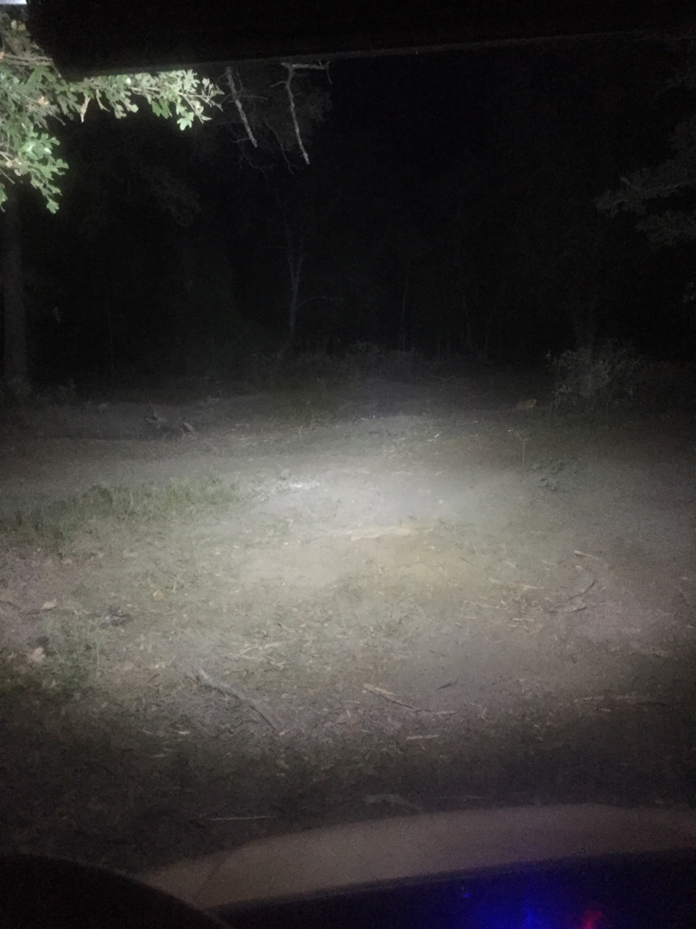

I certainly do! The grass growth here has slowed significantly, though I expect a quick jump with this 80* weather we've had for the past few days. I do have room to work on it this winter, unfortunately that room is outside! Either way, the rotor bearings are still good, the roller bearing on one side is bad. I'll replace both, I found part numbers for less expensive alternatives.
Thanks! And here is a picture from this morning:
