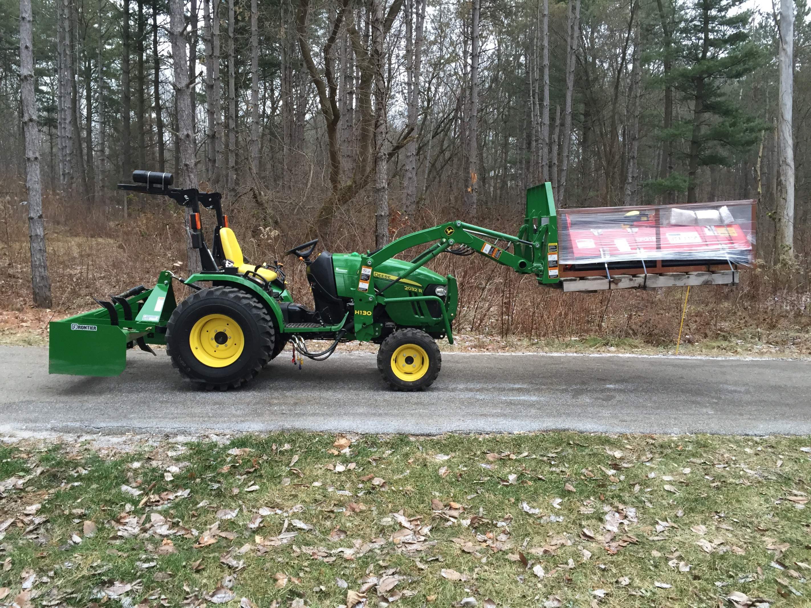

Mitch with BVS did call back with information and pricing. Their pricing is much higher than another online source, but he provided somewhat different information that was helpful. He also made an alternate suggestion. I am very puzzled from what I am now finding, The Giraffetta 160 SE is listed as needing 25 and 35 as the min HP depending on the source sheets. European say 25HP, US say 35HP Confusing. BVS says I cant run it, but another seller says I can.
I plan to test my lifting and operating capability by adding weight to my PZ 170 mower. It weighs 840 lbs, and extends 10' from the PTO pivot point and I am guessing the pivot arm to the mower head is about the same mass as the flail mower arms. If I add weight to the center of the mass of what the flail mower would be extended, say 150lbs or maybe 200 lbs for a safety margin and then try and lift both in the rear position and most critically to the side, do you think this would give me the idea of what I am up against? I can account of the pivot location being to one side of the 3pt by moving the load out to where the load would be on the flail. The units I am looking at weigh 900lbs, 926lbs and 980lbs. Any suggestions on this would be appreciated.
The big confusion is the offset distance. In the sales photos most show the gear box/pivot point outside the tire on larger tractors than what I have, but per the dimensions in the specks, many do not go far enough to the side. Ill do some more calls Monday to find out the answer. The gear box/pivot point needs to be beyond my tire to mow a ditch bank, correct? I want to stay on the road, and not get over onto the bank.
IF anyone here running a ditch bank or verge mower that can take some real world measurements on how far the gearbox or pivot point actually moves in relation to the PTO shaft? This would be a huge help.

Mitch with BVS did call back with information and pricing. Their pricing is much higher than another online source, but he provided somewhat different information that was helpful. He also made an alternate suggestion. I am very puzzled from what I am now finding, The Giraffetta 160 SE is listed as needing 25 and 35 as the min HP depending on the source sheets. European say 25HP, US say 35HP Confusing. BVS says I cant run it, but another seller says I can. I plan to test my lifting and operating capability by adding weight to my PZ 170 mower. It weighs 840 lbs, and extends 10' from the PTO pivot point and I am guessing the pivot arm to the mower head is about the same mass as the flail mower arms. If I add weight to the center of the mass of what the flail mower would be extended, say 150lbs or maybe 200 lbs for a safety margin and then try and lift both in the rear position and most critically to the side, do you think this would give me the idea of what I am up against? I can account of the pivot location being to one side of the 3pt by moving the load out to where the load would be on the flail. The units I am looking at weigh 900lbs, 926lbs and 980lbs. Any suggestions on this would be appreciated. The big confusion is the offset distance. In the sales photos most show the gear box/pivot point outside the tire on larger tractors than what I have, but per the dimensions in the specks, many do not go far enough to the side. Ill do some more calls Monday to find out the answer. The gear box/pivot point needs to be beyond my tire to mow a ditch bank, correct? I want to stay on the road, and not get over onto the bank. IF anyone here running a ditch bank or verge mower that can take some real world measurements on how far the gearbox or pivot point actually moves in relation to the PTO shaft? This would be a huge help. Thanks Keith
I'd be surprised if your CUT 3pt would have trouble with a 1000lb implement that only extends 4-5 feet back regardless of offset. My 40hp tractor with 32PTO power can lift about 3000lbs with 3pt. My 750lb flail with offset is barely noticeable.
