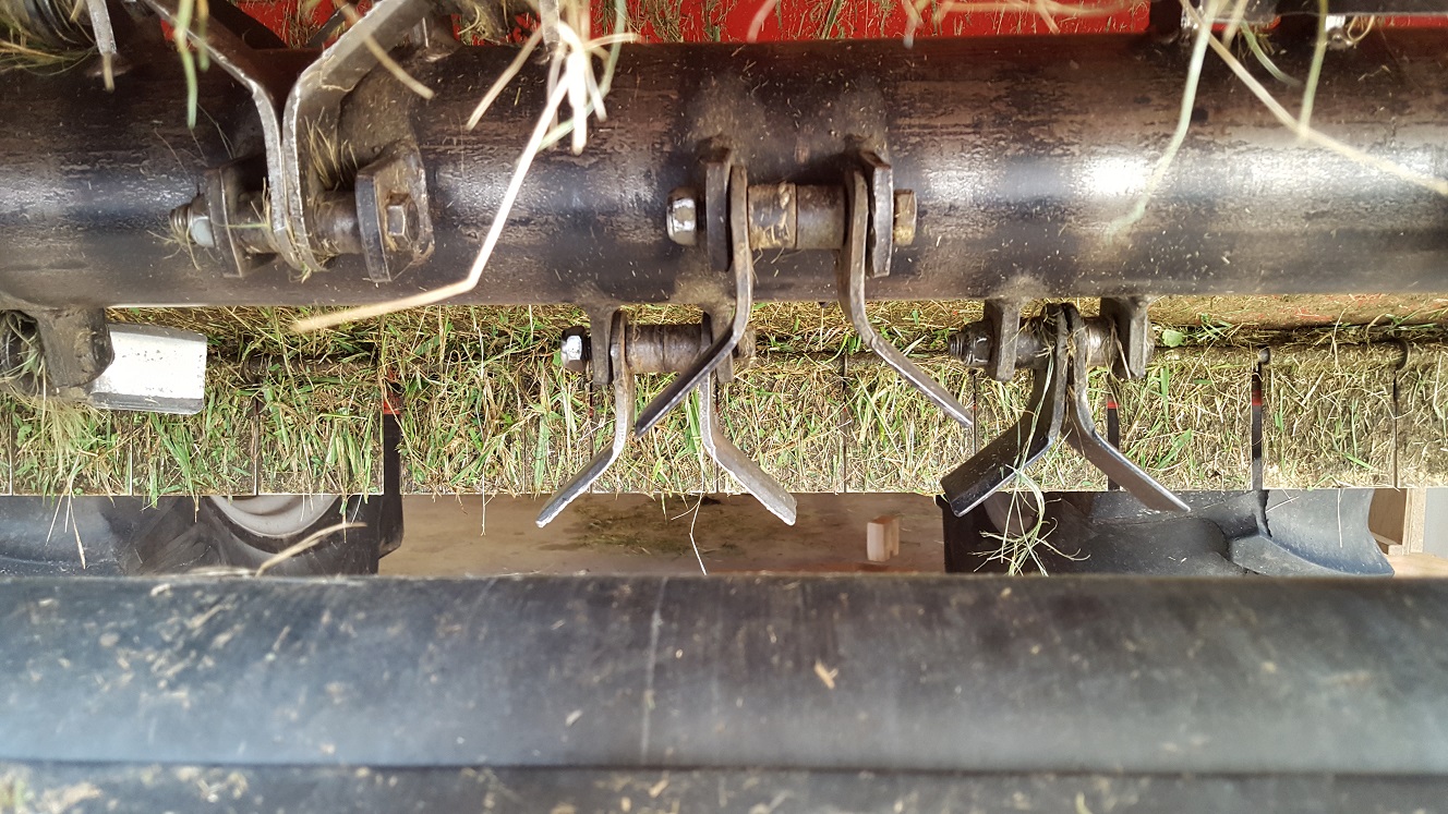

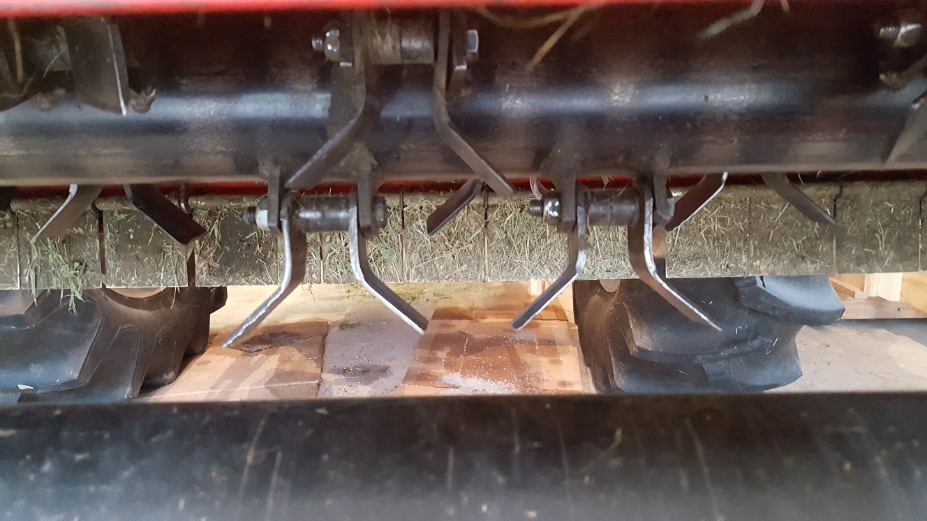

Another update.. things went much better last time out. On my Value Leader mower it's crucial to have the scraper bar as tight as possible, I can't see how others can run without one unless this mower just doesn't mulch well... Only two small bolts to hold it in place and I had to tighten them as much as I dared to keep it in place. That still leaves a decent gap at the ends where the roller tapers in to the bearings and grass still builds up around the bearings, but at least I was able to mow for a couple of hours on Saturday with only one small bit of cutting grass off the roller. I also pulled the knives and sharpened them, and after careful examination of overlap I re-configured them. Instead of spacer/knife/knife/spacer on each bolt that leaves a center section with no cutting edge, I went knife/spacer/spacer/knife and when I sharpened them I took it up around the curve onto the vertical part of the knife a bit so that is now a cutting edge. I made two changes at once there so I can't say which did what, but it certainly cut better this last time out.
Still not thrilled with the mower, but at least I was productive for a bit instead of just fighting issues... would like to try something else but it's not worth the return shipping cost to send this one back from Minnesota to Oregon. There's a Sovema flail on craigslist locally, might look at it just for the heck of it, but can't find much on them other than made in Italy..
