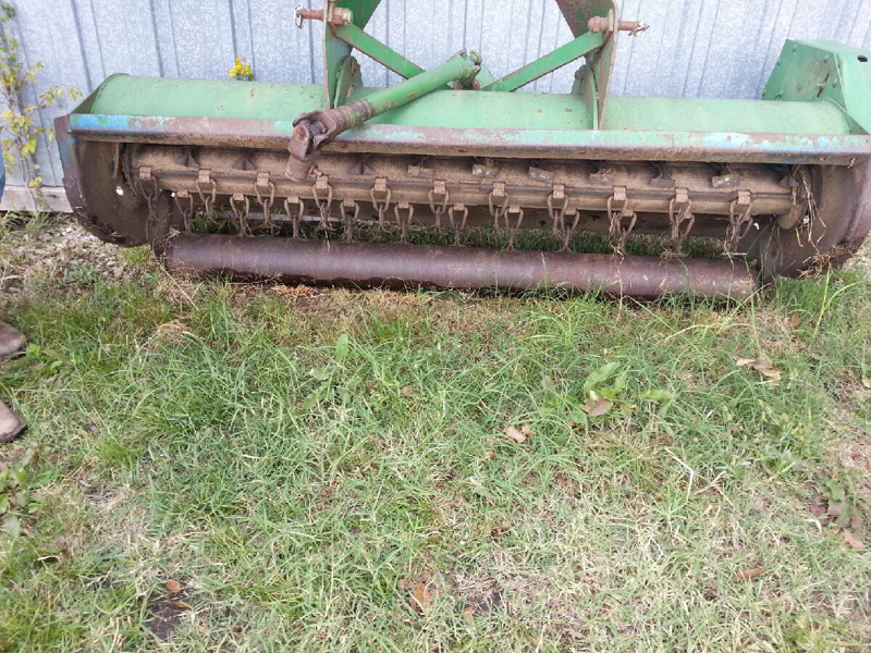

The idler pulley seems to be out of alignment with the other two. Is this normal? If not, the way to adjust it isn't obvious to me. Thanks for your help. <img src="http://www.tractorbynet.com/forums/attachment.php?attachmentid=466053"/>
Is there room to put a shim on the rotor pulley to pull it out a bit? They really shouldn't be that far out of alignment.

1st - It looks like you have at least one broken blade just in the picture.
2nd - You can turn the blades around. The cutting edge is rounded so you will get a better cut and have sharper blades by just doing a 180. You have cotter pins so the job would take you about 3 hours. FYI - get some new cotter pins before you start.
3rd - Those blades are in better shape than mine were before I replaced them and they still did a fair job.
4th - If the belt is out of alignment you will smoke it before you finish your first pass. However, you should still have a couple of spares (FlailMaster has them for $32)
5th - I have the same flail and if the fallow field is green and thick, do your first run with the flail roller about 3" above the ground then you can do a second pass normally. All those blades will not move the cut grass out the back if you are pushing into a mass of vegetation. It can't get enough air in through the front to move the grass out the back and it clogs up in the front. I do not mean thick brush but tall thick grass and vines that are green not dry.

Thanks for the tips. I'll keep them in mind. Looking at the pulleys, what do you think the issue is?

From the pic the belt looks like it is in line with both sheaves. It would appear just the tensioner is slightly off.
This pic is strait on to the belt so the wall to the left is at an oblique to the viewer BUT it appears that the wall is bowed away from the belt. The tensioner is attached to that wall so straightening the wall might help.

Take one of your wife's yard sticks and put the edge across both sheaves as close to center as possible. If the straight edge touches both sides of each sheave then they are in line.

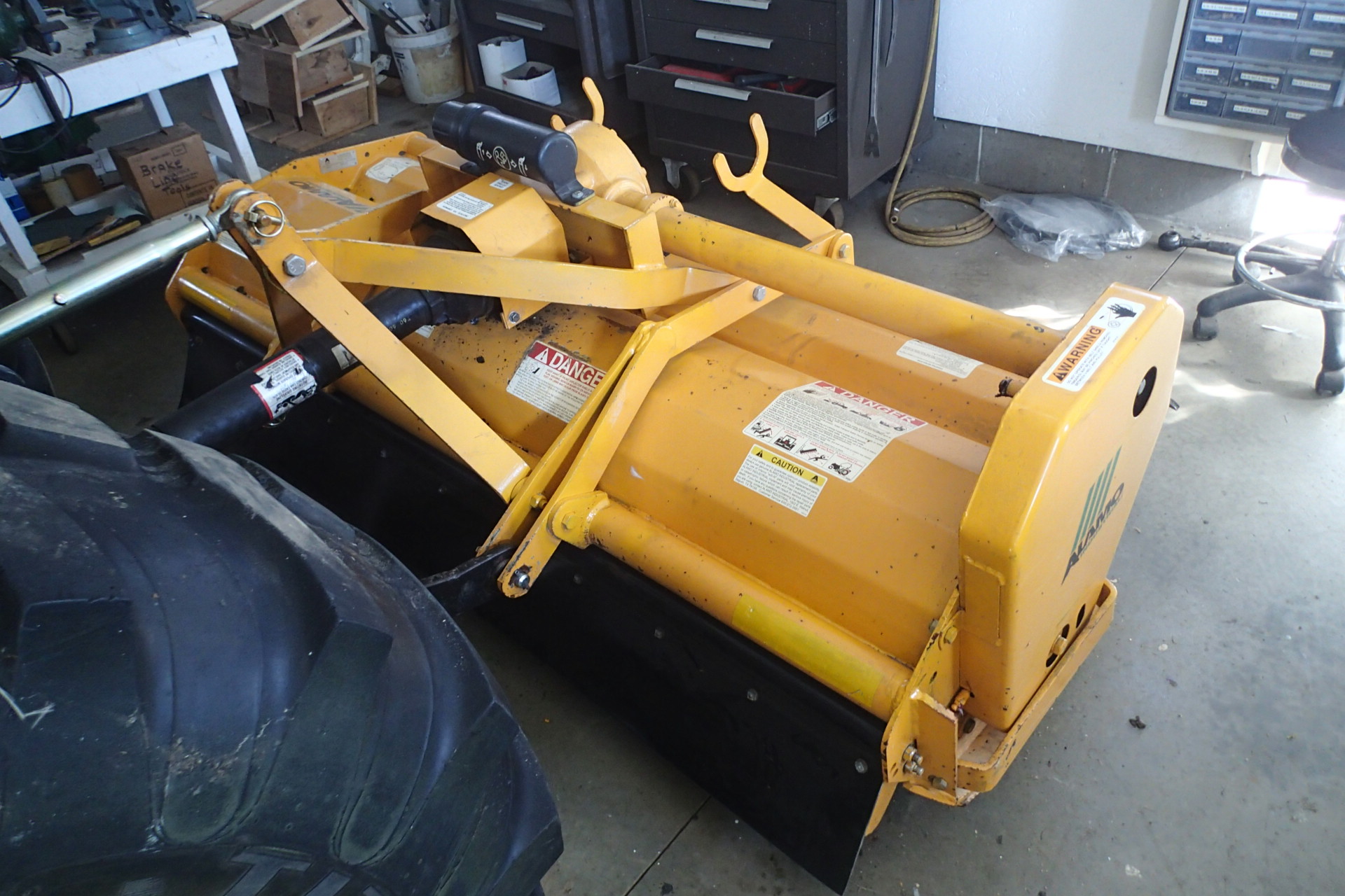

/ Let's talk flail mowers #2,817
Gentlemen, I have joined Flail Nation with the purchase of this used Flail Mower.
Seems to be in real good condition.
Its a 74" fine cut mower.
Now to get it to use!!

<img src="http://www.tractorbynet.com/forums/attachment.php?attachmentid=466459"/> Gentlemen, I have joined Flail Nation with the purchase of this used Flail Mower. Seems to be in real good condition. Its a 74" fine cut mower. Now to get it to use!!
That's used? Wow.... Great condition

That flail's not used, it's just dusty. Nice find.
And, I think you deserve an award for your screen name.

Hello Weedy Fields,
I want to welcome you as the newest resident member of the flail mower nation.
That Alamo flail Mower looks sharp.
Be sure to chain the dog to the mower(if you have one) attach a motion alarm and lock the doors as that mower is north of 7K new!!!
Just be sure to read the manual, ask questions, adjust properly, ask more questions, operate the engine at the speed @ 540 rpm and have spare parts like belts(kevlar) and knives on hand.
The slower you mow the finer the cut, and the sooner the clippings dissolve. Take That ROTARY CUTTERS AND BUSH HOGS!!!!!!!!!!!!!!!!!!!!!!!!!!!!!!!!!!!!!!!!!!!!!!!!!!!!!!!!!!!!!!!!!!!!!!!!!!!!!!!!!!!!!!!!!!!!!!!!!
