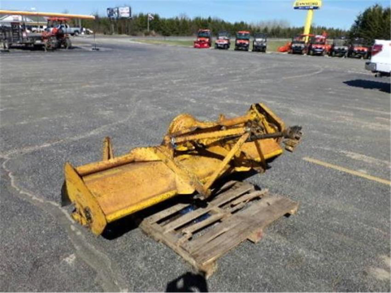

I found a used Mott 72" flail near me. It looks to be in decent shape. I'm going to check it out on Thursday. Anybody familiar with this unit or vintage?
