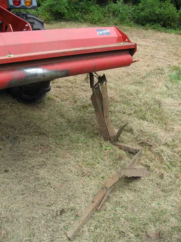

I run over briar all the time with my flail. Don't know how different that is from Spanish moss but a flail spins at many thousand RPM and chews up pretty much anything I have fed mine short of logs, old car parts and garden hose.

Well I always wanted one of those automatic hose reels!:D
How much damage did that piece of steel do?
/ Let's talk flail mowers #2,829
Well I always wanted one of those automatic hose reels!:D How much damage did that piece of steel do?
None. Just took about twenty minutes to get it all out. Turned out the field I was reclaiming had been an auto junk yard in the 1930's to 1970.
I didn't find a photo of the firewood I ran over but that jammed up the rotor so belts started smoking. Finally got it out. No damage.
I now carry a three foot pry bar on the tractor to extricate foreign objects. Pry bar fits nicely in the torque tube and is held there by a bungee cord.

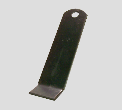

Leonz,
any particular brand or source better for blades and belts?
my mower has knives like this now
They seem on the flexible wimpy side.

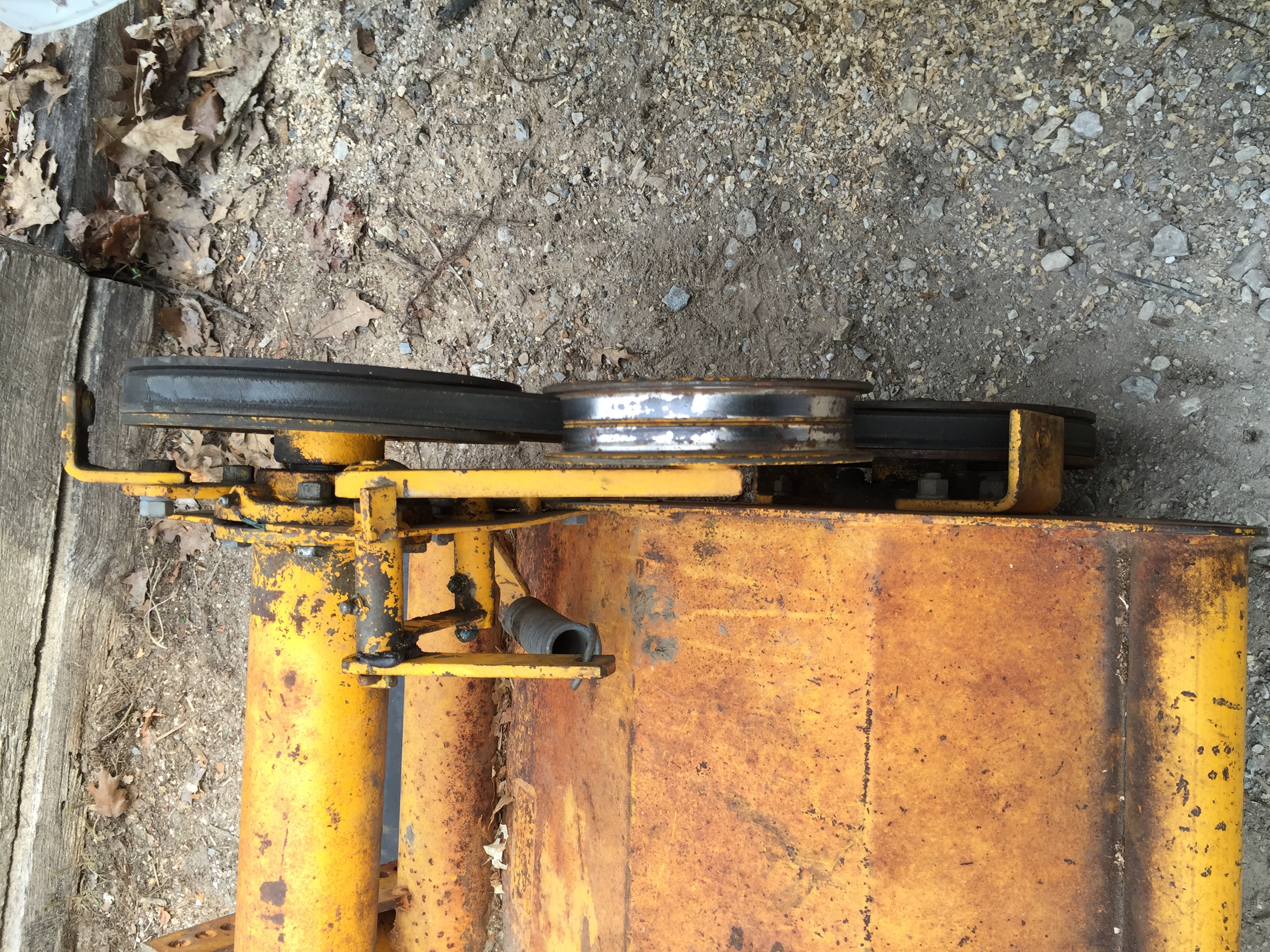

The idler pulley seems to be out of alignment with the other two. Is this normal? If not, the way to adjust it isn't obvious to me. Thanks for your help.
I'm pretty sure that mount should go on the outside of the bearing housing. Move that mount to the outside and I bet you will be back in alignment. I'll check mine tomorrow to make sure.

Whats happening is your mower is a fine grass mower the side slicers are too thin for the job of brush mowing and you can replace these knives with heavier ones. you need to replace all of them at once if you do this and be sure to have spares.
BUT you can continue to mow with this style of knife and you will have to replace them more often as they will bend more easily and break. the plus is they are not very expensive per knife in the scheme of things.
1. Depending on which side of the continental divide you live on you can and should order catalogs from clean cutter and flail master; actually you need(should have) both catalogs and a replacement knive list from your alamo dealer.
Order these parts catalogs quickly as the grass and brush monsters are going to be very very nasty this year.
Ask the local alamo dealer for a knife list for your flail mower then compare prices for the replacements from all three sources. You will need a heavier side slicer and they are available.
