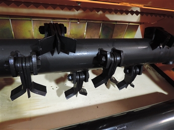

Can you upload more pictures of the rotor from left to right and pictures showing the entire rotation of the rotor??
I ask because I always worry about not seeing any welded weights on the small diameter rotor shafts which is something I do not like at all on the machines available to the market now.
The smaller tubular flail mower rotors require longer knife sets and more power to run them.
Thanks much,
LeonZ AKA "Flail Mower Whisperer"
Here you go. There are two welded weights, one on each side.
