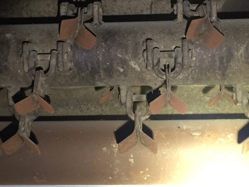

It's an older model but can you show a picture of how the knives are attached? I'm wondering if someone changed it to nuts and bolts? Mott's take a while to change knives but if you don't use the special cotter pins with a flat side like Whirly posted, it is a royal PIA to keep the pin from turning. The flat sided cotter pins go against the hanger and you bend the long side of the cotter pin out about 30 deg's. Mott used to supply a simple tool for this with a box of knives but a pair of side cutters makes it really easy to do. I'm not sure if your model is the same as the later 72" Heavy Duty model with 2 1/2" cutter shaft but on those you could leave the knives off that are closest to the side plates of the mower so they don't rub on the side plates. You lose maybe a couple inches of cutting width is all.

Here is my mott

Ok, I see what you have. You have the optional rough cut ring mounted knives on the smaller dia. cutter shaft. This arrangement wasn't as common as the standard knives arrangement and did use bolts to hold the ring mounts on. I think bolting them tight is to prevent the ring mounts from moving which could cause the rings to come off. Changing all of them would be a PIA. The rings mounts on the larger dia. cuttershaft don't use separate ring mounts. The pin goes through holes in the rings.

So this is rough cut? Honestly, when the grass isn't to tall, it give a great finish. So what does the finish blade setup look like
/ Let's talk flail mowers #2,486
Rough cut may not have been the best terminology to use. The cutter shaft is already designed as a fine cut with more mounting points. The ring mount knives are better if there's trash or possible rocks you may encounter because the knives can pivot forward and back as well as sideways if an obstacle is encountered. The cutting will be the same as the standard knives though because the spacing is the same. The standard knives use a clevis pin and cotter pin keeper but are longer. Basically the standard knives only pivot forwards and back but are essentially the same length as the ring mount knives on the rings. The cutting portion of the knives is the same.
/ Let's talk flail mowers #2,487
Ok, very well stated and that was original assumption ....

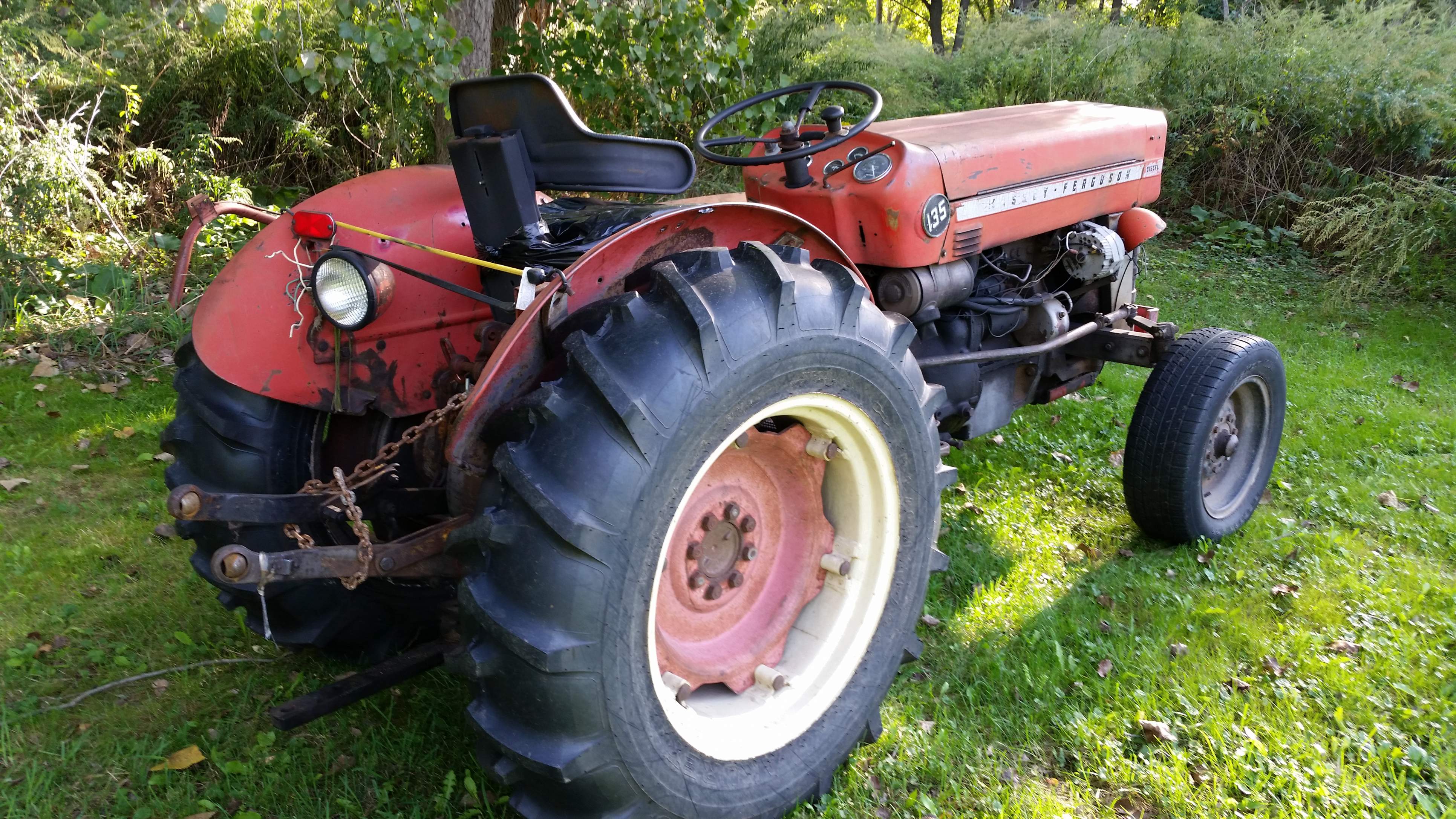

After buying my Massey Ferguson in early August, expecting it to be available in late August, I was finally able to pick it up today (the seller's new tractor came to him late.) I picked up my Alamo SHD74 from the Highway department a couple weeks ago, and about a week later, finally "unloaded" it from my van (WOW, is this thing heavy!) To unload, I tied a tow strap about 10 feet high in a tree, then hooked it onto the flail, and while my son did his best to "guide" the mower (not much at all) the upward pull of the tow rope helped slide the mower quickly out of the van, and it swung fairly gently to the ground. Whew! I was so relieved when it landed safely!

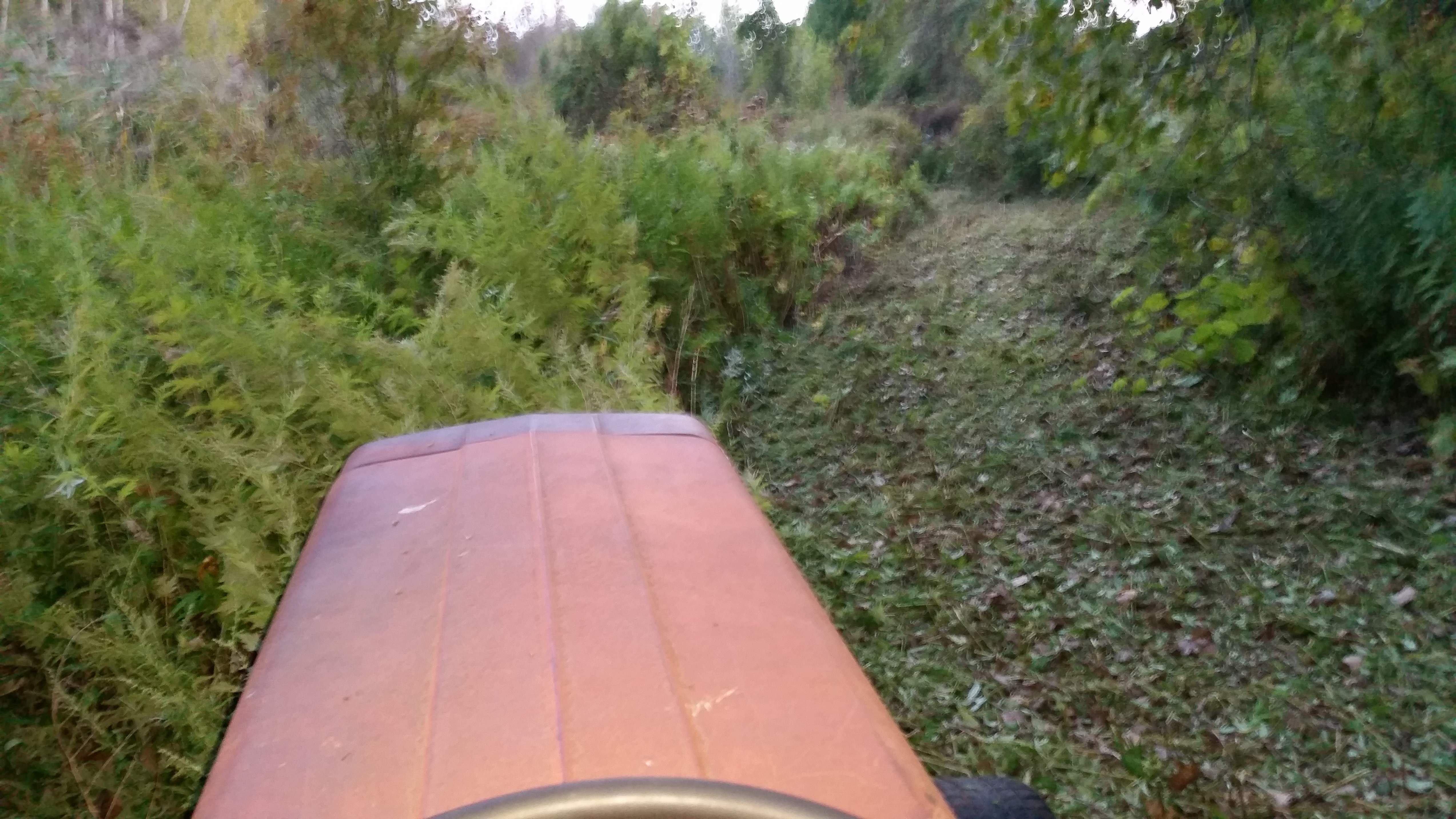

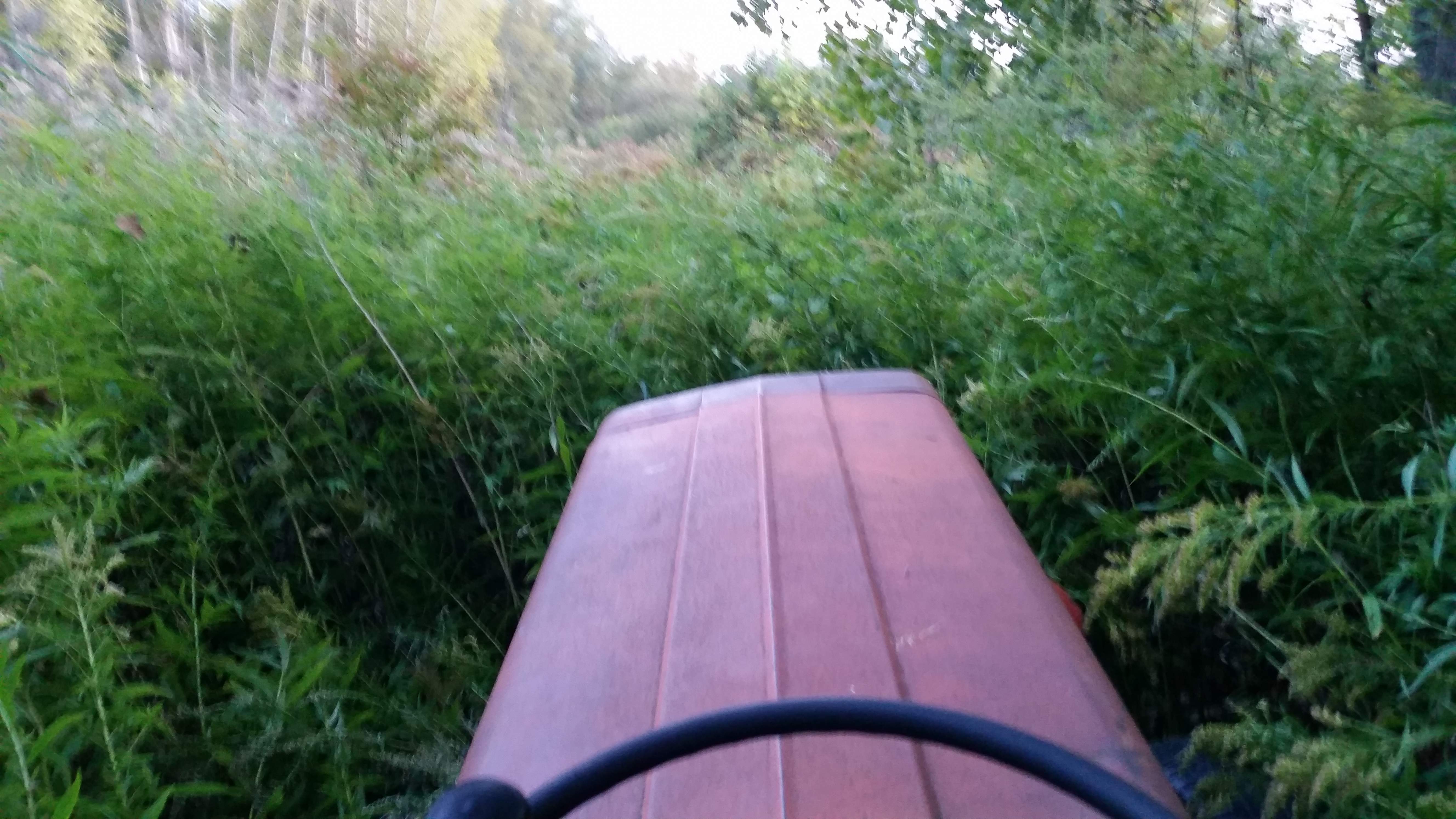

So with my mower and tractor together at last, I horsed the tractor around enough to get the hitch lined up and connected, and took a shot at clearing the jungle. I had been told by more than one person that this tractor wasn't powerful enough for this flail, so I was wondering how this would work out - would I be happy enough with it, or would I end up selling and getting a brush hog with the proceeds? I plunged headlong into the weeds (some well over my head when I'm on foot) and realized I'd forgotten to lower the mower, so I dropped it down, and went ahead a few seconds and looked back - and was shocked at the clear path that lay behind me! This thing was amazing! After all the struggles I've had doing the same sort of "clearing" with a Cub Cadet 123 garden tractor with oversize 44" deck, and with a John Deere 425AWS with a 48" deck, and a John Deere 48" walk behind "yellow deck" commercial mower, with all the clogging, backing up and taking another push at it I was used to, almost muscling the mower through with force of will (and gallons of sweat), to just drive forward through the dense vegetation and have the machine just chew it up without complaint was a shock. I had a few troubles with some old wood chunks/logs, and some thicker saplings. I did chew through a sapling that was probably 1-1/2 to maybe 2" thick, but it took a moment, made quite a racket, and there were a few sparks seen coming from under the flail, so I may have caused myself some grief. Still, I suppose replacing a few knives once in a while is a fair price to pay for going through such a mess.
And a little while later.

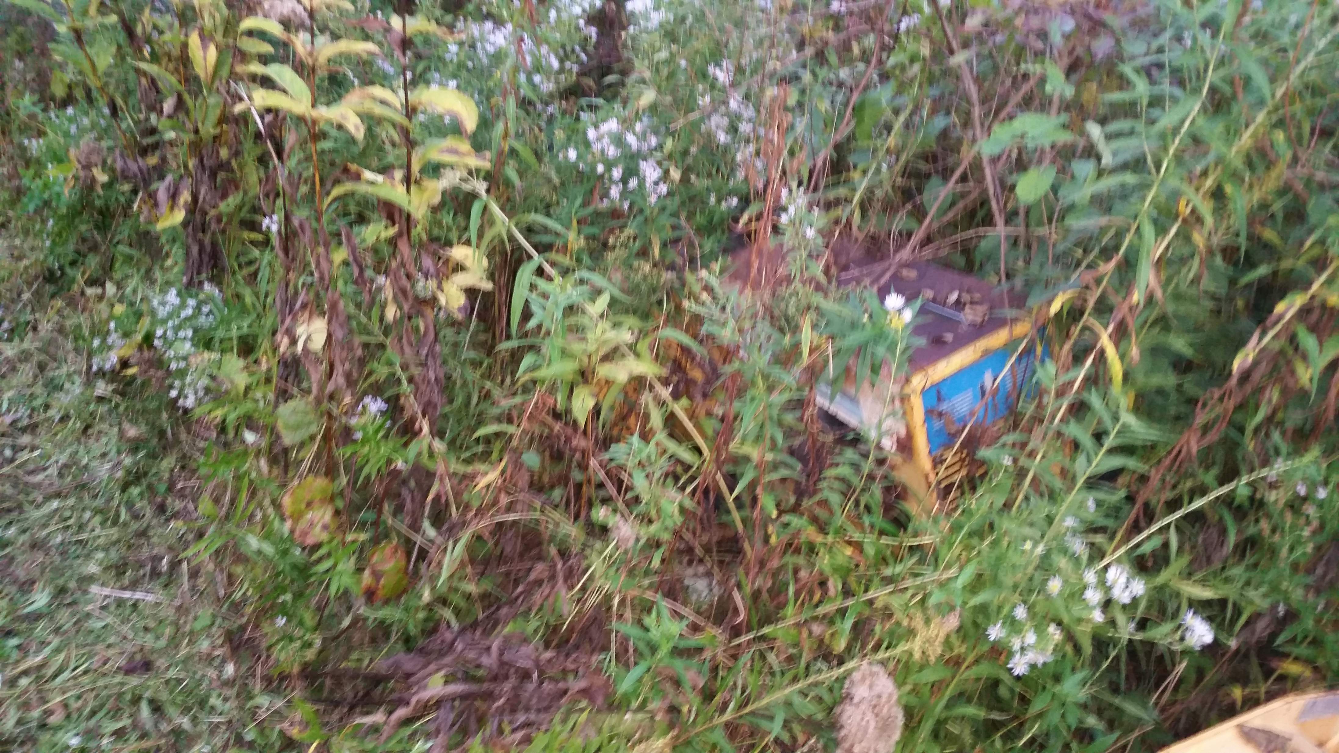

I even found the long-lost Cub Cadet 123, which I failed to locate a few weeks ago (couldn't even get close!) I'm lucky I didn't run right into it!
The tractor is awesome, and because the seller needed it for his harvest work longer than he expected, he ended up replacing the rear tire that still had tread, but was REALLY badly cracked and deteriorating on the sidewalls. Major bonus for waiting! This thing won't win any beauty contests, but to me it's gorgeous!
I've got some inexpensive LED lights I got on Amazon that I hope will do well for me (the YouTube video reviews I saw seemed very promising, they looked brighter than halogen car headlights) that draw 27W each, because when I'm working out in a field, I always push it until the very last glimmer of light, and then I still have to get back to the house. Tonight I did that with a pocket flashlight, and when I came upon a tree with low-hanging branches with thorns, AND a steep ditch nearby, with me a very new tractor operator, things got scary very quickly. I can see the wisdom in wearing leather gloves and a sturdy shirt, like denim, so that a sticker tree doesn't distract me right when I need to be most careful.
I can see that this machine is going to be able to help me do what needs to be done on my land. My wife recently became hopeful that the new tractor would be able to create a path through our 5 acre lot that she can walk the dogs on, and this tractor and flail (and a chainsaw or two) will definitely get it done, and much more. Maybe it won't be a golf course, but everyone knows you have to get a box blade before you can have your own golf course! (Heading to Craigslist to search for box blades...)

Looks like it did a GREAT job!!! I am currently looking for a similar Motts/Alamo mower for working around the house and am glad to see it worked so well for you.

Your excellent example porves once again that you can mow down
heavy brush even with a much smaller flail mower (36"-48") like we did when
we knocked down 12-15 foot golden rod and other brush like ragweed..
I love it when a plan comes together involving flail mowers.

That's what I'm talking about! A 135 is a good match for an SHD74. There was company here that had a fleet of SHD74's and MF245's which is basically a newer 135 with about 4 more HP. If you tried that with a 6' bush hog you wouldn't get far. An MF255 would run a SHD88 and a one sided 74 Interstater wing. Now imagine doing that with an Interstater with three 74" flails at the same time. That's similar conditions my dad demo'd the first Interstater in to the city of Edmonton except it was mostly tall grass and weeds. He said give me your worst field. Their jaws dropped! That's how my dad set a sales record for Interstaters. He sold over 40 of the first 100 made. I think it was 46 but not sure on the exact number. The city had no problem recommending them to other municipalities.
