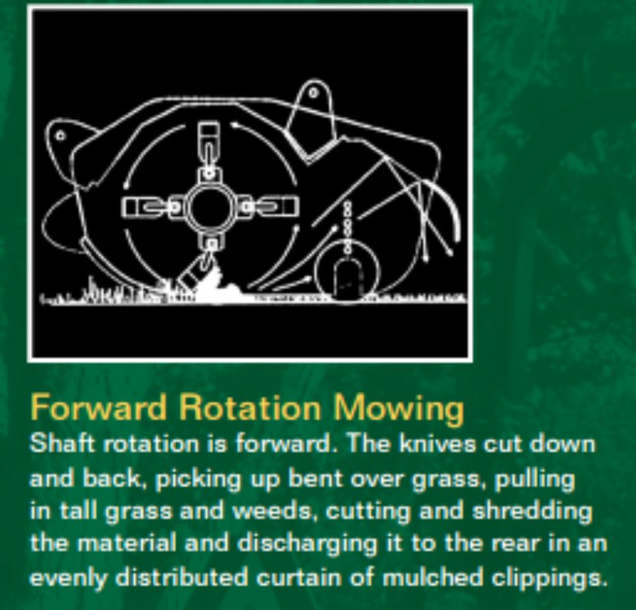

This is what Alamo calls Foward Rotation, leonz calls it ccw, would this be "forward down"? My front mount rotates the other way, opposite of tire rotation moving forward.
AS my power wigged out before I was able to finish this today GGGGGRRRRRR!!!!!!
I will start once more.
The way Alamo Industrial has configured these flailmowers allows them to be used
with hydraulic drive using PTO shaft mounted pumps and hydraulic motors for the
rotor drives for the wing mowers and or simply rear mounts and in some cases
allowing three flailmowers to be operated at one time with one or more flail mowers
in the raised position.
They advertise the same mowers for sale in Europe. I am unsure if they are built here
or in Europe but with MFN status "Most Favored Nation Status" between England and
the United States; they may be built here with metric parts anf then shipped simply using England for an finished inventory and parts depot.
NOW as you look at the sie view of the flail mower look closely at the mower shroud where
the pressure gradient is created by the high speed rotation of the flail mower rotor and the
free swinging flail knife pairs.
Follow the arc of the shroud to its end where it meets the rear apron where a portion of the
clippings hit the lower shroud and the balance of the clippings bounce out after hitting the rear roller.
NOW the mower will clog in Heavy and tall brush unless the mule is crawling on its first pass.

/ Let's talk flail mowers #2,448
No you are not wrong TSO it all depends on the design of the mower
shrouds discharge point as I mentioned in my last post.
