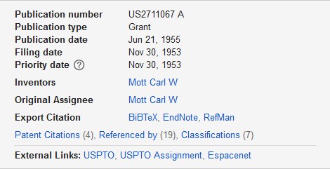

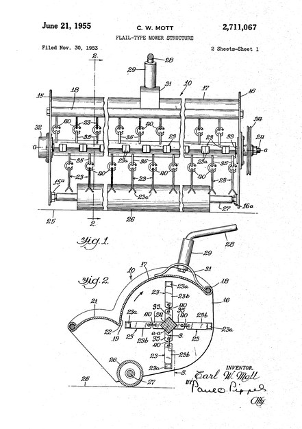

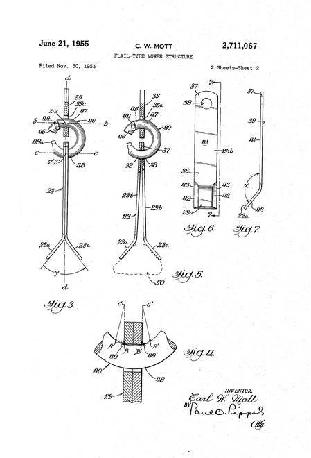

Just so we are all reading off the same page, here are the particulars of the original patent:

Thank you for that whirly. It also answers my question that Elmer Mott was the son that took over the company and was friends with my dad. Mott's have a dynamically balanced rotor like a drive shaft. If they're vibrating, something is not right. Knives missing, bad bearing, bent rotor from hitting a large object, etc. that would also explain why it would leave stripes. I know when I needed to get a bearing for a Mott, it used a Sealmaster which is considered a premium bearing. Mott uses individual knife hangers and the key to changing them quicker is using the special cotter pins with a flat side to go up against the hanger. Using standard cotter pins is a pain because you have stop them from turning. SHD Alamo's also use 1 15/16" bearings which are considerably beefier. I've always said there's other good flail mowers but Mott being the originator is the standard and they've stood the test of time longer than any others. That's got to be worth something.

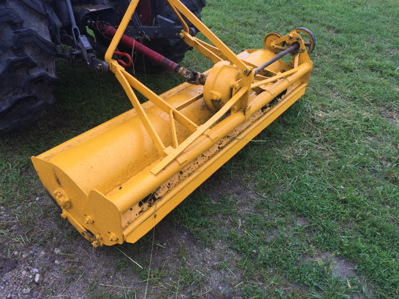

This is my mott
I wish is had cotter pins .... However, each one is bolted on. I had it at a very comfortable working level. Access was not the issue, just the process of removing them was a pain!!! And to this day, I've only taken 25% off because i know of I start it will be the rest of my evening and I won't finish.

It's an older model but can you show a picture of how the knives are attached? I'm wondering if someone changed it to nuts and bolts? Mott's take a while to change knives but if you don't use the special cotter pins with a flat side like Whirly posted, it is a royal PIA to keep the pin from turning. The flat sided cotter pins go against the hanger and you bend the long side of the cotter pin out about 30 deg's. Mott used to supply a simple tool for this with a box of knives but a pair of side cutters makes it really easy to do. I'm not sure if your model is the same as the later 72" Heavy Duty model with 2 1/2" cutter shaft but on those you could leave the knives off that are closest to the side plates of the mower so they don't rub on the side plates. You lose maybe a couple inches of cutting width is all.
