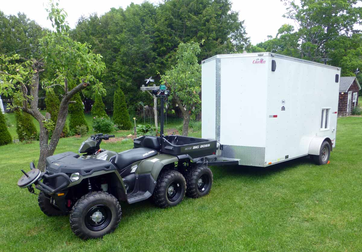

I haven’t run into anything because I forgot but I have been driving down the road and all the sudden remembered I have a trailer back there.
Don't feel alone. My little dump trailer is only 4 feet wide and pulls easily even when loaded. It doesn't show in the mirrors and is easy to forget about.
On the other hand I struggle backing it up. When I had a 16 foot tandem axle I could easily back it down my driveway or up through my field; all my little trailer wants to do is jackknife.
