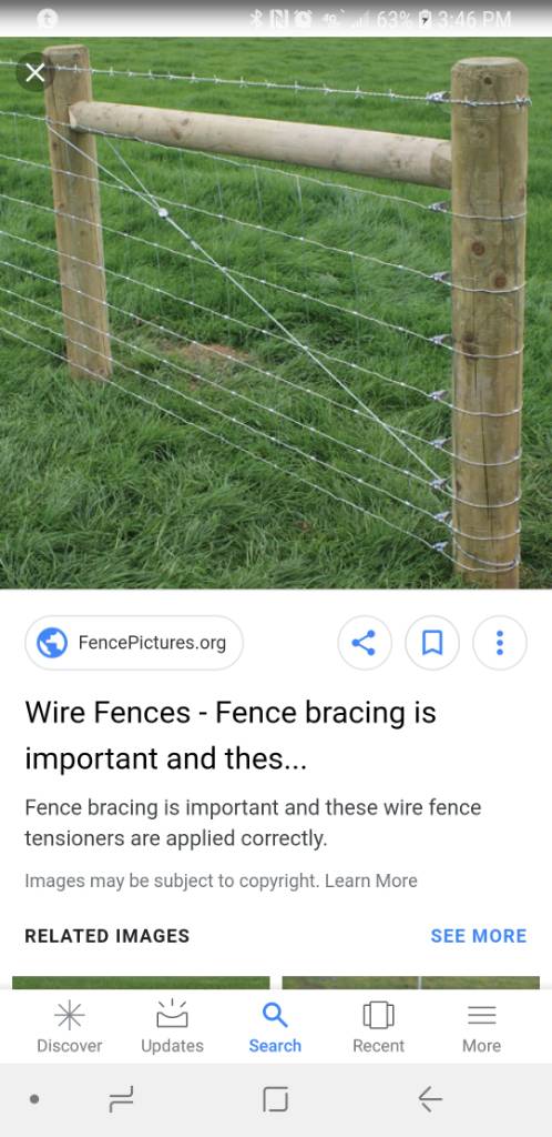

Are the corners braced or just a single post?
A single post will not withstand side tension for long.
/ Leaning Fence Post Remediation #8
One type.....note the diagonal tension wire also. Screenshot_20181019-154634_Google.jpeg
/ Leaning Fence Post Remediation #9
^^ True. Usually what I see on wire fences is three posts at each corner; a larger corner post, then one smaller line post in each direction spaced about 8 or 10 feet from the corner. Then a diagonal post from the top of the corner to the bottom of each line post.
/ Leaning Fence Post Remediation #10
Exactly, there are several ways to do it, and you can use wood diagonal supports or wire.
The key is having 2 parallel posts that support each other in each direction of pull. So for a 90 degree corner, 3 posts as you describe work perfectly.

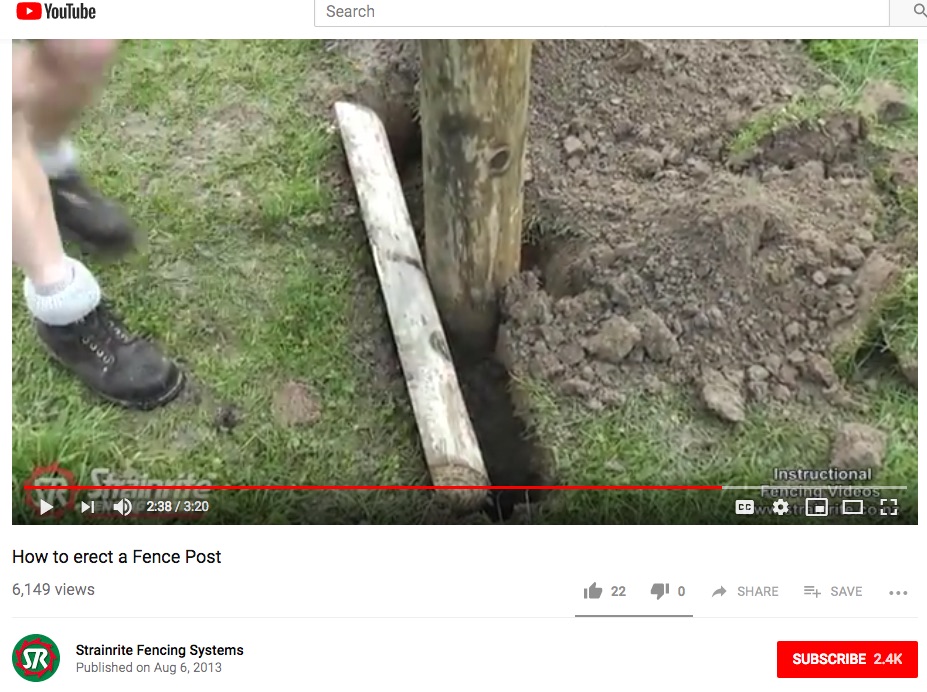

Maybe brace your corner brace posts and gate posts like this. Here is a screenshot of the partly finished installation.
Bruce
/ Leaning Fence Post Remediation #19
I installed some corner post today. I use 6x6x8' treated with about 3'ft in the ground. I don't wire brace. I install a short 4x4x4' post behind the 6x6x8 then install a 4x4x8' diagonal brace from the 4x4x4' to the 6x6x8' .
I pull the barbed wire as tight as I can get it with a hand held come along, and have never had an issue.
Only way I would know to make repairs would be to install a large post down the line. staple the wire to that. then repaid your corners. It should cause any issues with your wire doing this.
All You'll will just have to stretch the short section that you take down to repair your corner post
something like this
