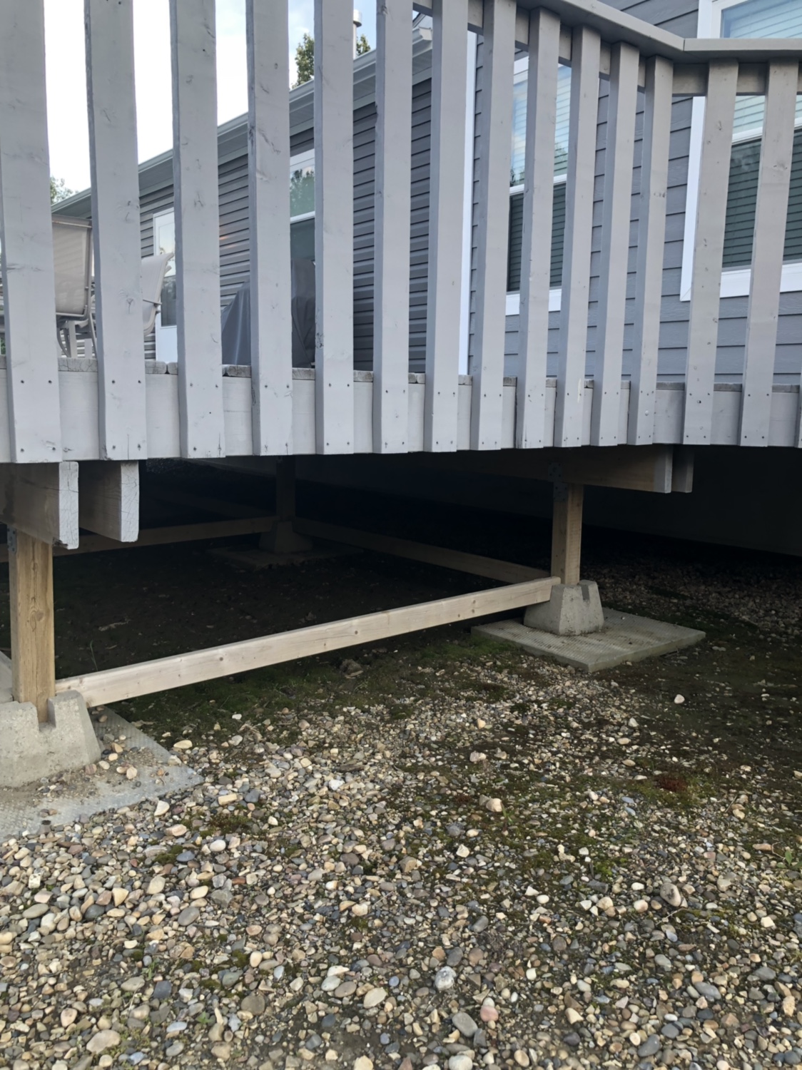

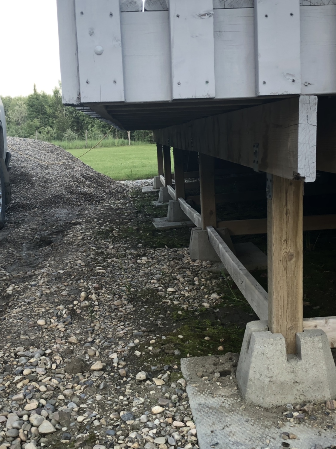

Hello I would like to install some lattice underneath my deck and I am wondering if you guys and gals have any pointers or ideas how to install it on this particular deck?
/ Lattice install under the deck? #2
The easiest way to make it look straight and smooth is to make (2x2) frames for each section that can be secured to the bottom of band boards at the top and at the concrete pads at the bottom...
/ Lattice install under the deck? #3
Is your goal decorative or critter/insect/debris control? I tried a few things and nothing kept stuff from getting under. Finally had to go with hardware cloth. If you want appearance, you could put lattice over the HC, using the 1x2 or 2x2 frames.
All I want it for is appearance to finish off the deck. What do you mean by HC?
/ Lattice install under the deck? #6
On a similar deck, I built panels that matched the railing structure above. It looked much better than the cross hatch lattice that was originally installed. I put netting on the backside to keep the leaves out.

The lattice makes excellent kindling. If fire is a concern, I'd suggest something else. When we redid our deck we replace the lattice with fiber cement boards.
/ Lattice install under the deck? #9
^^ OP isn't in Cinderfornia, but that's another reason to use wire mesh of some kind. There are some decorative versions available for not a large cost.
/ Lattice install under the deck? #10
Might consider putting heavy black plastic of sort just under dirt/gravel help keep grass weeds etc. from growing,also some sort wire fencing to keep critter out.
/ Lattice install under the deck? #11
Before installing lattice, I would install diagonal bracing to each outside corner going in both directions.

I use 5/8" redwood lattice sandwiched between 1x4 redwood on all four sides. So the panel is 1x4 - 5/8 - 1x4. very stiff and also looks nice. The panel needs to be fastened on top and both sides but not the bottom. Make the width line up with other elements of the deck structure for the best appearance.
/ Lattice install under the deck? #17
I have a deck that runs on 3 sides of the house. As someone mentioned above, I built a frame for each section to fasten the lattice to and strengthen it. This spring one of my projects was to take down all that lattice and install 4 mesh (1/4" opening) hardware cloth under the lattice, then put the lattice back up. That's because everything from snakes to skunks thought that under my deck was a fine place to hang out - they could get through the openings in the lattice just fine. The hardware cloth I installed has a black polyester coating on it, and once the lattice was back up it's pretty hard to tell the hardware cloth is even there without looking closely. Oh, and I dug a trench a good foot deep so the hardware cloth is that deep below ground level so the vermin can't easily dig down underneath it.
