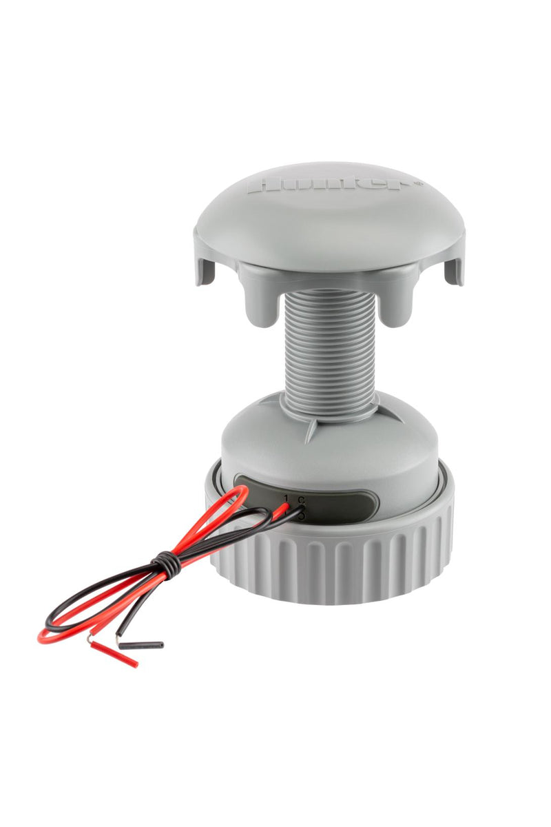

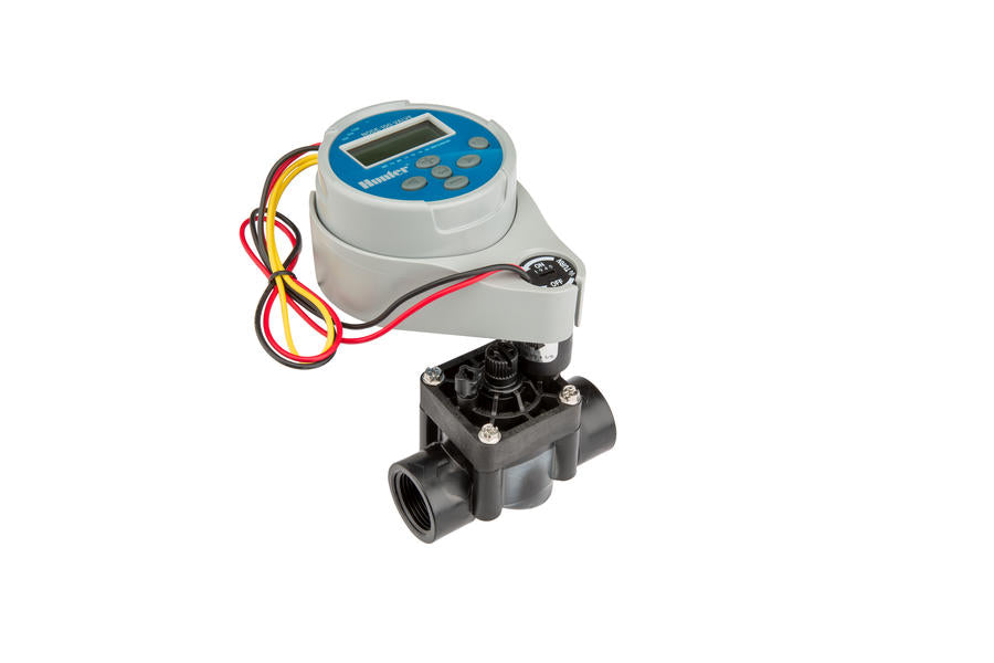

There are such a thing as wireless valves. They are battery powered and don't need wires. You just have to remember to change the battery every year.
You can buy these that will control 1 or 2 or 4 valves. With these, you will just need to connect to a water source.

The wireless valves are not WiFi. I think they are Bluetooth and you program them from your phone and not from a controller.
@WinterDeere it seems that what you are describing is a "2-wire" system, or a possible variation of it. A 2 wire system will control many valves at long distances from the controller with only 2 wires. Each valve has a "decoder" that is programmed to operate that valve.
I don't know of anything available that could be added to existing wire so that you could control 2 or more valves separately with one wire
If you were to develop something like that, I would think there would be a small market for it. Or, you could patent it and sell it to Rainbird or Hunter.
/ irrigation zone control #7
I apologize for the link I posted earlier. Those valve controllers are controlled by a RF (radio frequency) signal. They are good for up to about 1000' but you must be in 'line of sight'.
This is the valve controller I was thinking of. These are programed with your phone at close range. Sorry if I caused any confusion.

I have a Hunter Node that runs two Rainbird valves on a remote garden. Works fairly well. Don't have to open the valve box but need to be close to the Node to get Bluetooth to connect. I have used DIG timers before as well, and I think they now have a Bluetooth option. With multiple remote timers you just have to make sure they work at different times and when using a Cycle Stop Valve zone flow rates do not have to exactly match the output to keep from cycling the pump to death.
