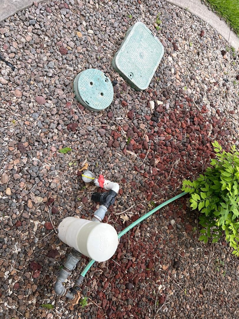

I have been using a 1/2HP submersible in this well since 1976 to irrigate our 1/2 acre of fescue and it has never failed to deliver at least ten GPM. We've had a couple years of drouth in NCKS and the well responds saying I can deliver the ten gallons but absolutely no more and the pump will start sucking air. The underground sprinkler system has six zones with four or five heads per zone so I've had to install 2.0 GPM nozzles and keep the pressure at no more than 40 PSI as a result.
The problem comes with the method of controlling the flow and I've been trying to do it with the 1" ball valve shown in the pic. A 1/2" ball valve would probably work better but I'm wondering if someone could recommend a better way of controlling the pressure and flow. The problem with the large 1" valve trying to control the 10 GPM is that it is just not precise enough and not enough pressure will let several of the six solenoid diaphragm valves to stay partially open resulting in some water exiting heads on several zones at once.
I'm guessing that there is a low cost pressure control valve that could be plumbed into the PVC plumbing shown and would be precise enough to maintain the 10 GPM in varying conditions such as night time as well as full sun daytime?
Edit: The black object is a canister type sand filter.

Simple, use a gate valve. Much easier to control.
More costly, use a pressure regulator such as a watts U5B.
Or, change nozzles so every zone uses the same amount of water.

I've tried using 1/2" gate valves over the years at each sprinkler head to control flow and found they have enough slack in them to sometimes not allow any flow the next time using after adjusting them down to, say, 2.0GPM. Ball valves actually work better as they don't have any slack like a gate valve.
I have changed nozzles in every zone in an attempt to maintain the 10GPM zone flow.
Forgot to mention that each of the six Hunter solenoid valves has an onboard flow control that can adjust the diaphragm opening but they aren't really precise enough either.
I wish it was simple.

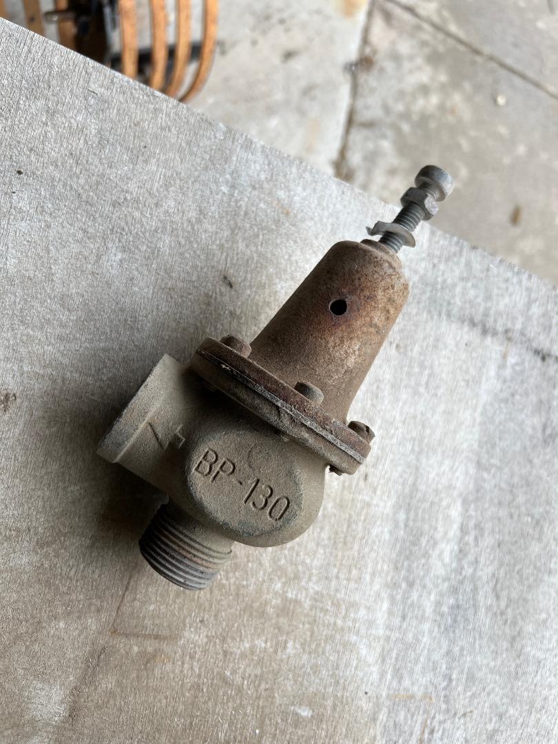

I tried this valve back in the 70's but could not control the flow as it was erratic. The 1" size is probably too large for 10GPM?

A pressure regulator will not control flow.

Yeah, a flow control is probably the answer and that is what I've been using, it's just not precise enough with the 1" ball valve. It gets a bit confusing thinking about how the number and nozzle sizes of the sprinklers on each zone and trying to regulate the flow. One of the zones has only two heads so I do run larger nozzles on them while the five head zones all run the 2.0 GPM nozzles.
I'm probably overthinking it, but almost seems like both a pressure and flow regulator are needed but I'm not sure which would be upstream and which downstream of each other.
/ Flow Control on Well Head #10
How about a flow control orifice before each zone and one pressure regulator feeding the whole system? That way each zone gets the same amount of flow to it no matter how many sprinklers. This assumes that each zone uses the same amount of water. I have done what you want but on a much much much smaller scale for lubricating a machine. I used constant pressure to the system and orifices at each lube point. This made it possible to deliver precise amounts of oil everywhere.

I'm beginning to think that my problem is that the six 1" zone valves are too large and that I should have gone with 3/4" or even 1/2" size. I say this because the 10GPM that I'm trying to achieve doesn't generate enough pressure to keep all the valves closed tightly except the one that is currently energized to run a zone. When that happens there are a couple dozen sprinkler heads trying to run on 10GPM resulting in not much more than a trickle from each.

Thinking about this some more and may have come up with a solution after remembering that there is a delay setting available in the Hunter controller software, called Hydrawise, that allows for a delay between the pump starting and a zone valve opening. I'm thinking that this might let the pump build up pressure against all the valves to keep them shut while the valve, that the controller calls for, gets opened by its solenoid.
The is no check valve on the pump so the water in the output line drains back into the well each time the pump shuts off.
This system was originally set up with the six zones but controlled with manual valves since 1976 until three years ago when we installed the controller. The last two years of drought have reduced the well output to where I have had to throttle the pump output pump down.
I will plan to add the time delay mentioned above and report back here to let you guys know how it works out. I very much appreciate all your feedback.

Pressure regulator first, flow control second.

Good advice. I'm always careful to not knowingly deadhead the pump for more than a few seconds but, between my wife and I, we have inadvertently left it running with no outlet flow for at least a few minutes on occasion over the last 48 years. The pump has been replaced once in that timespan. I've checked the amperage draw, out of curiosity, with the pump deadheaded and its interesting that the amperage drops way down.
I started this thread asking about a better method of controlling the flow and I still want to achieve that and certainly appreciate all the suggestions. After a lot of additional thought, however, I think that I need to solve the basic problem that being throttling the flow down low enough to not overload the well has resulted in not enough initial flow and resulting pressure to hold all six zone valves shut tightly until pressure builds up in the system.
To further explain, I can start the pump then pinch the flow down to the 10 GPM with the 1" ball valve and the pressure will hold the remaining five valves shut. But, when restarting the pump and opening one valve simultaneously, the 10 GPM can't overcome the leakage letting several more of the valves not completely shut. So I'm thinking that starting the pump and delaying the valve for a couple seconds may solve my problem.
