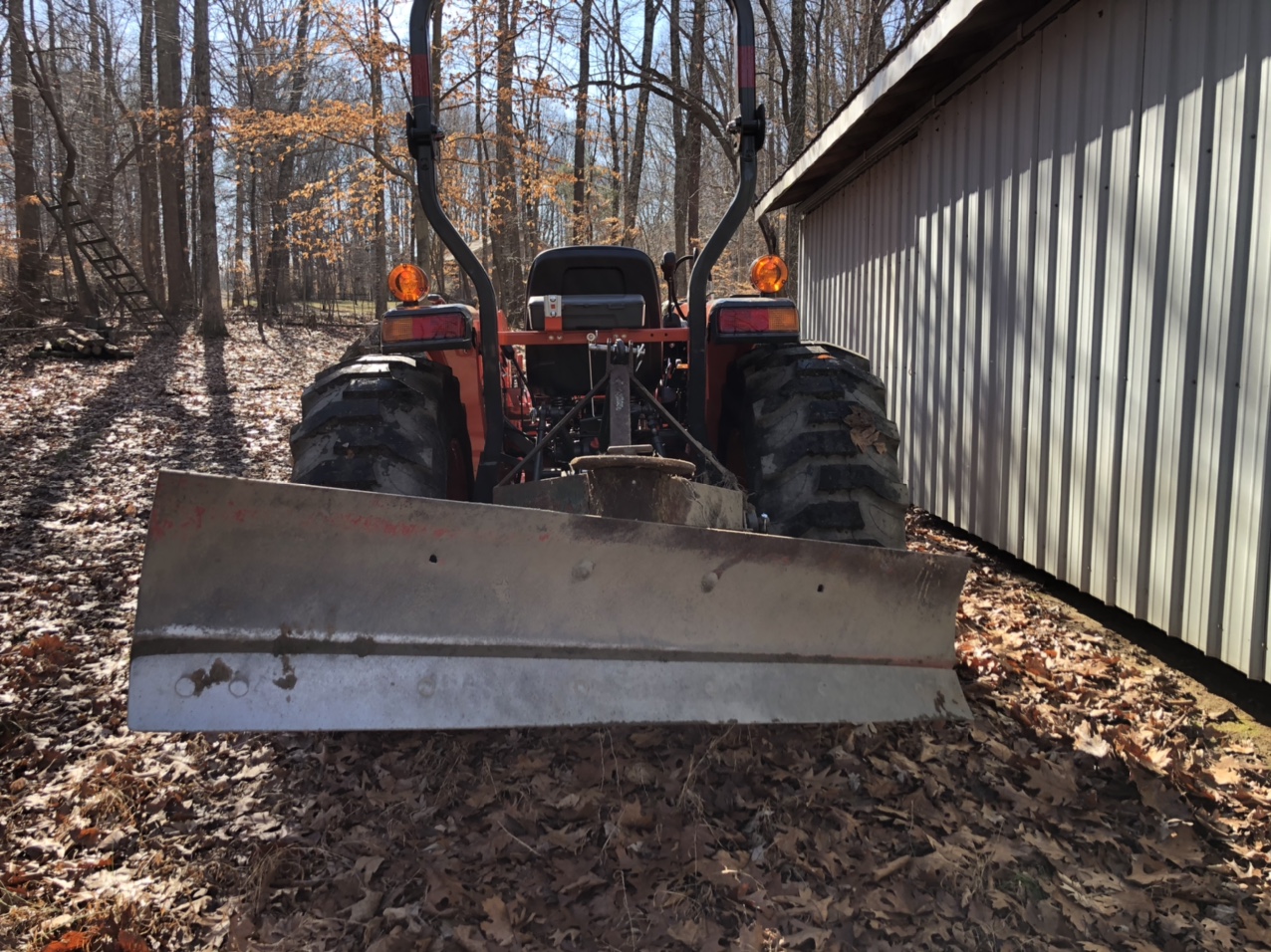

The current 6ft blade is an older Leinbach, just finally added a front stand to it a few weeks ago. It's been a good blade, had it for over 10years now. 20201228_165226.jpeg

The current 6ft blade is an older Leinbach, just finally added a front stand to it a few weeks ago. It's been a good blade, had it for over 10years now.View attachment 681482
Leinbachs: That’s a little bit of a blast from the past! They used to have a pretty decent business over in Pfafftown just north of Winston not far from us. I don’t know who made this one but it wouldn’t surprise me if Leinbachs made it, too.

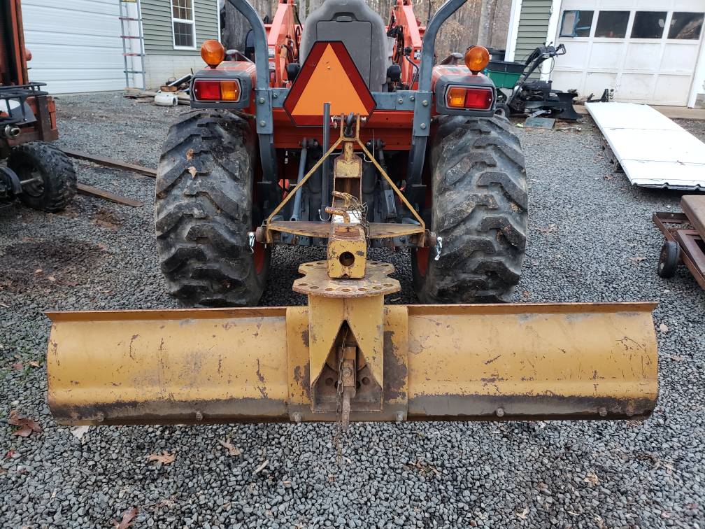

I will sometimes adjust the three point off center to put the blade closer to whichever side is in the ditch if cleaning ditches. IMG_5260.JPG

I will sometimes adjust the three point off center to put the blade closer to whichever side is in the ditch if cleaning ditches. View attachment 681725
Yup, really liked the Leinbach for the money back then. I bought all my stuff used but have 3 Leinbach implements, the rear blade, landscape rake, and post hole digger. I also have a United brand box blade that I understand was part of Leinbach also.
