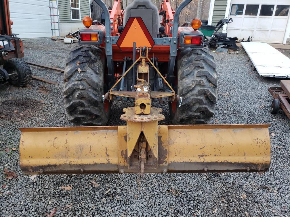

I just upgraded from a B2620 to a L3240 but because of the size jump a lot of my implements are now too small so I'm looking to upgrade those as well.
Mainly looking for a larger box blade and rear blade, I've looked at the "recommended" sizing in the manual but I know from experience that Kubota is very conservative on sizing and their recommendations won't cover my tire tracks. (~71in outside tire to tire)
Looking for some feedback from people that have used larger blades on this size tractor. I'm looking at a 72" box blade which I think it'll handle no problem for my needs based on how well it pulled my full 60" box up my steepest hill grading the road.
The problem is deciding on a rear blade, in order to cover my tracks when angled id have to go up to an 8ft blade, I don't mind doing that, but I'm just worried I'll run out of power/traction at that size with a 32hp 5800lb tractor.
I'm not looking to do a lot of earth moving with it, just some gravel road maintenance/ditching and occasional snow removal. I found a decent deal on a nice 8ft Rhino 950 with hydraulics, just worried it'll be overkill.
Right now I have a fairly heavy 6ft 3way adjustable that I was using on my B series, but once angled its narrower then my track width.
So has anyone ran something like a Rhino 950 on a L3240 before?

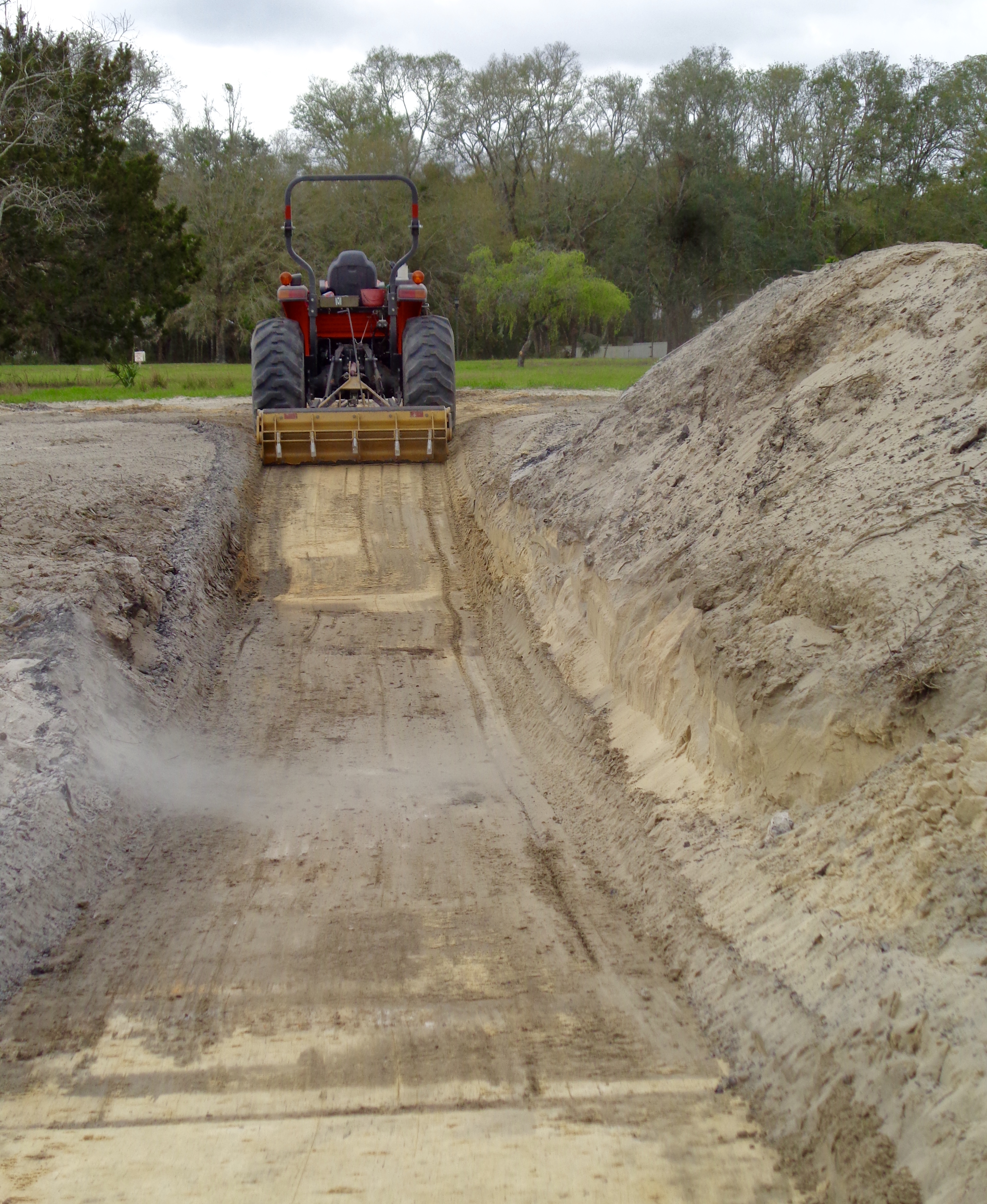

Rear Blade is normally used on an angle. Unlike a Box Blade, material spills off the end of the Rear Blade forming a windrow, so weight of the material is usually not that high when blade is angled.
You may find the Rear Blade satisfactory grading moist soil, unsatisfactory grading hard soil.
Close call.
Have you filled your turf tires with liquid? Unlikely to be necessary to maintain traction with a modest 32 horsepower driving the wheels. I have air in the R4/industrial tires on my L3560 and have always found air maintains traction pulling a filled 60" Rollover Box Blade up a slope.
Close call.

You will get 100 different answers as you all ready know.. If you get the 8 foot you take less of a cut if it starts to pull hard . I have a 72'' rear grader blade that I used once and some other attachments that I never use...

Yeah thats what I was thinking, we'll see if the one I'm looking at is still for sale. The Rhino is pricy but seems really well built.

Landpride RB3784 (7'). RB37 Series Rear Blades | Land Pride
My L4060 is about the same. 72" track, similar HP when you factor my lack of HP due to lack of Oxygen here in Colorado. don't. The same weight.. It's a hair narrow is some respects, but it can be offset. That way I can get extra pseudo width when I need it but without maneuverability problem when I dont. I'd like to get hydraulic angle & a diverter for offset, but can't justify it... yet.
A back blade isn't heavy enough to really anchor my machine, unlike my old heavy 74" Gannon box blade or 5' LPGS with a full load. But at higher angles it will start pushing you to the side.

Thanks, that's just what I was looking for. I really like my 6ft, it can also offset so I know I can get more to the side if need be.
I was thinking 7ft would be good, only reason I was looking at the 8ft is because I found a nice Rhino with hyd. on the tilt and angle for a good price.

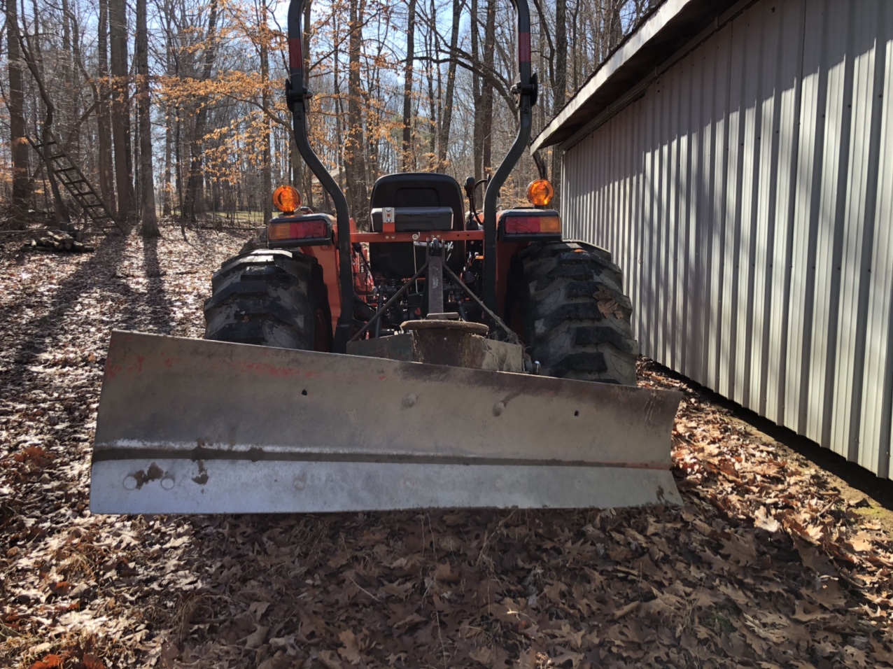

May depend to some degree what you’re doing with it. I have an old 6’ I run behind a L4701 that doesn’t cover the wheel tracks when angled. It does a better job redistributing the gravel on the road that migrates toward the ditch than the BB1572 box blade. For gravel I don’t really care if it covers the wheel tracks or not. Our dirt is primarily clay so if I’m grading something other than gravel I need the weight of the box blade (and often the rippers) to do anything much more than bounce on the surface anyway. Box blade weighs probably over twice what the backblade does. Last time I really had to do a major rehab on the road (totally neglected for about 15 years) I had to rip up the base and flatten it all with the box blade to get it loose enough to recrown with the backblade, then used the box blade to distribute the tailgate spread gravel for the top dressing, then back to the blade for a little fine tuning. If I’m just trying to flatten something (like some our trails), fill in pot holes, clean out turnouts and ditches, and cut out washboard those are more of a box blade thing.
Maybe I’m just not a very skilled operator but I need both for different operations (basically box blade for heavy stuff and backblade for fine tuning or wind rowing) and have never run across a situation where covering wheel tracks was a big deal with the backblade. Maybe plowing snow it would be important. Don’t know because I don’t do much of that.

Leinbachs: That’s a little bit of a blast from the past! They used to have a pretty decent business over in Pfafftown just north of Winston not far from us. I don’t know who made this one but it wouldn’t surprise me if Leinbachs made it, too.
I will sometimes adjust the three point off center to put the blade closer to whichever side is in the ditch if cleaning ditches. IMG_5260.JPG

I do like the Rhino, I haven't heard back on the one I was looking at anyway. Seemed to be a pretty good deal at $1600 for a 950 with tilt and angle hyd.
With loader and filled R4's the L weighs in about 5800lbs so I imagine the 8 footer could move me around a bit. The turfs aren't filled so I'd lose about 1000lbs switching to them.
I did find a decent priced Woods RB850, it weighs even more then the Rhino though! No hydraulics, but thats an easy fix.
If its still available next time I'm off work I might see if I can get it.
