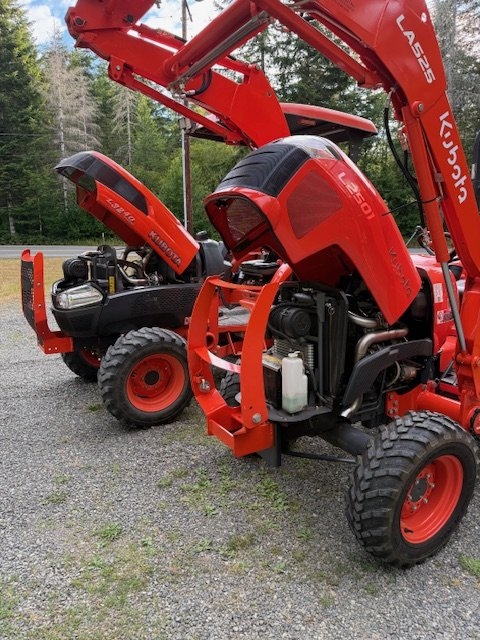

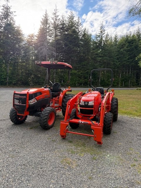

The newest Turbo Kit addition: The Kubota Grand L40 series L3240. This Turbo Kit will fit both open-station and Cab models with A/C.
Next will be the Kioti CK2610 / CK2620 (Bobcat CT2025).
Next will be the Kioti CK2610 / CK2620 (Bobcat CT2025). I still haven’t acquired one of these tractors. I’ve been looking for a used unit locally without much luck. So, I’ll likely purchase a new one in the next couple months and then we’ll get to work. Interesting enough, there’s also the SE model with Cab (and A/C) so we’d like to make one Turbo Kit for both models as we did with the L3240 but, we’ll have to see (we do know the air cleaner assembly is in different locations so there will be differences between the Kits but, we’d like to make minimal modifications between the two models to save costs).

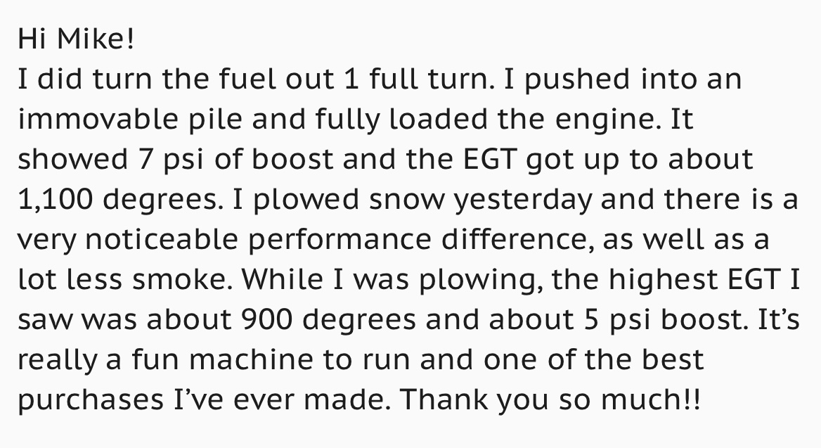

We had a successful day at the dyno with the L3240. The L3240 Turbo was able to match my L2501’s 44 HP / 35 PTO HP.
However, it is worth noting, the owner of the tractor wanted to keep EGT’s well below 1,100 degrees (1,041 degrees in this case) and settled on a fuel setting of 1 1/2 turns which produced 33 PTO HP.
During this testing session it was great to see how small incremental adjustments in the fuel settings affected performance while on the dyno.
Overall, the L3240 and S2T Turbo Kit performed flawlessly and provided incredibly consistent performance throughout the testing and dyno session. We’re very pleased with the results and the customer is extremely happy!
