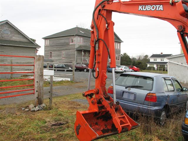

I finally went out this Fall and made my mechanical thumb hydraulic. What a treat it is to use and lots of power to boot.

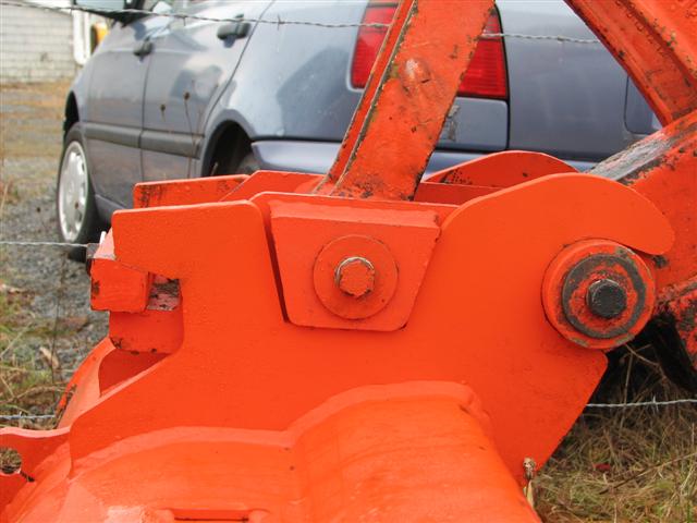

I also installed a quick attach and purchased a 36" ditching bucket and a 16" trenching to complement my 24" trenching bucket.
There was a little wear on the pin and bushings between the arm and boom. I don't like loose bushings as they will just accelerate wear and could get very costly to repair. I went out and bought a new pin and two bushings and all was tight again. With the quick attach I should not have to side swipe as much and hopefully not wear the pin and bushings near as fast.

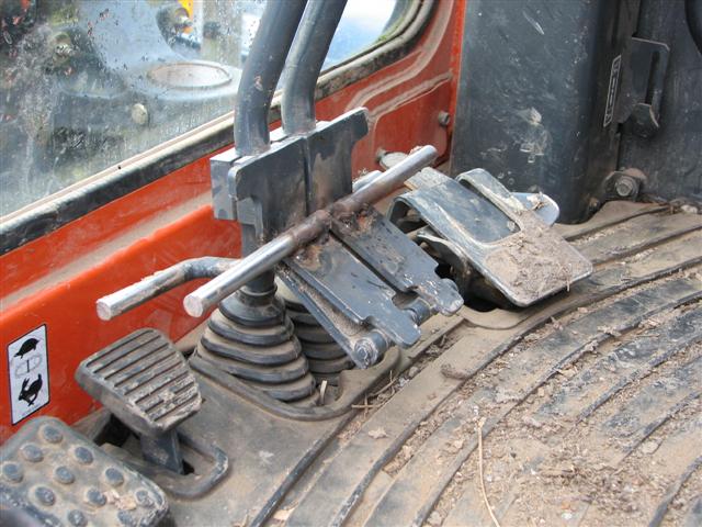

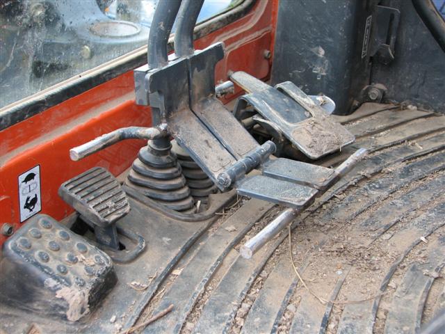

I finally got tired of trying to use them tiny foot pedals for track controls. After some thought we added a couple of 1/2" pins to the sides of the pedals. The pins were welded to the pedals and made a 3" extension to the pedal for your foot to rest, in a normal resting position.

How time flies. It is a year and a half later and I thought I would just post an update. Since the last post I have been doing very little excavating due to a variety of reasons. The main ones are the economy and the lack of time. Our chicken, beef farm business and firewood sales has continued to expand and it has me doing a lot more in that area instead of the fun stuff. The economy is "oh well" could be worse. So I have only put about 100+ hours on since last report and all is well as expected.
The concern about the quick attach is a non-issue and works great and is easy to change. The thumb works great and I feel like superman when I start crushing concrete between the thumb and bucket. I should have switched to a hydraulic thumb years ago. I am now using Schaeffer aluminium complex grease with moly as I found a reasonable price source in Canada. I believe it is a superior product if for no other reason then the bucket takes a lot longer to get noisy, has to be a good thing. I also have started using 0w40 shell oil in all my trucks and equipment. The oil is more money but the difference when starting in the winter is reason for anyone to want to change. They say it can be used in the summer and I have with no problems. The benefit is that I used to change oil spring and fall regardless of hours ( always way below the recommended hour change interval anyway) Now I change the oil in all but my truck once a year and save the labour and material cost and believe I have a superior product in my motors.
