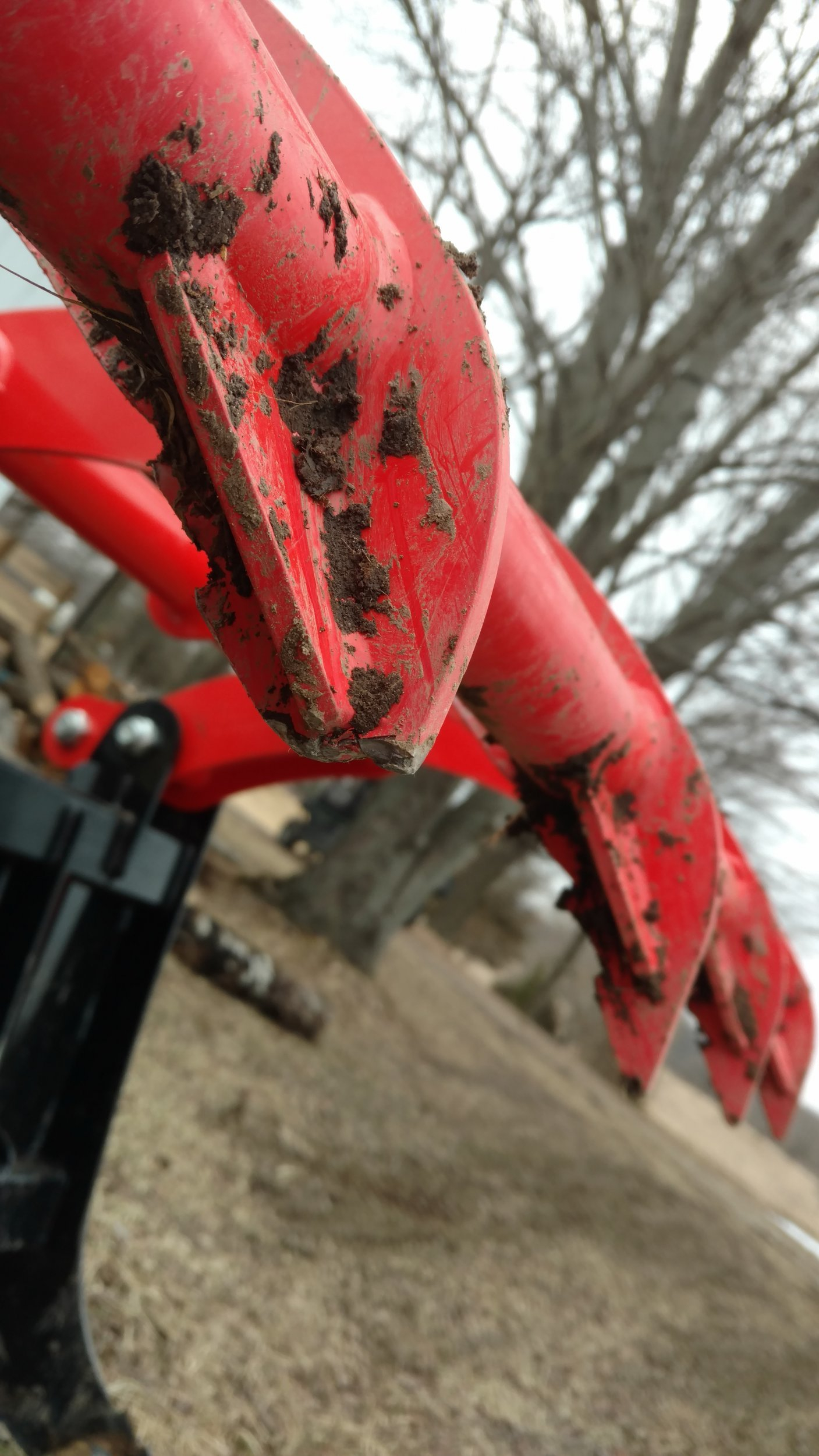

Ok So i just sent a nice message to customer service at Kioti. Saying how much i like the grapple and explained the same things i just laid out here. Wow was i really surprised at the response i got. i will share it. and some pictures i have of the grapple.

Looks like a weak spot from the design of the parts as they were cut. Likely the assembly welder was supposed to weld past that joint and didn't get the memo.
I'd forget about the dealer and just weld that piece back on. You will need to weld past that spot on all the other tines as well. That is a weak spot on all them.
Then maybe look over the rest of the design and see if there are any other similar issues.
Thats AR400, not sure if he'd have the experience to do it correctly.
/ Kioti Grapple Buyer beware!!!! #6
Who knows. I'd make sure what steel it was before any welding. If it is AR400 most any diy welding guy can easily weld that piece back on, weld the other tines and check for any other issues.
I'm a problem solver. This gets him back in business instead of fussing with an incompetent company.
Right off Lincoln's site:
AR400 is a quench and tempered steel and may be difficult to weld due its high strength and hardenability. The base steel around the weld rapidly heats and cools during welding, resulting in a heat affected zone (HAZ) with high hardness. Any hydrogen in the weld metal may diffuse into HAZ and may cause hydrogen embrittlement, resulting in delayed underbead or toe cracks outside of the weld. To minimize heat affected zone cracking:
  • Use a low hydrogen consumable with an -H4 or -H2 designation
  • Preheat to slow the cooling rate. Note that excessive preheat may anneal the base material
  • Slow cool. More time at elevated temperatures allows the dissolved hydrogen to escape
  • Peen the weld beads to minimize residual weld stresses
  • Use the lowest strength filler metal meeting design requirements. If making fillet welds, the weld can be oversized to give the specified strength
  • Minimize weld restraint

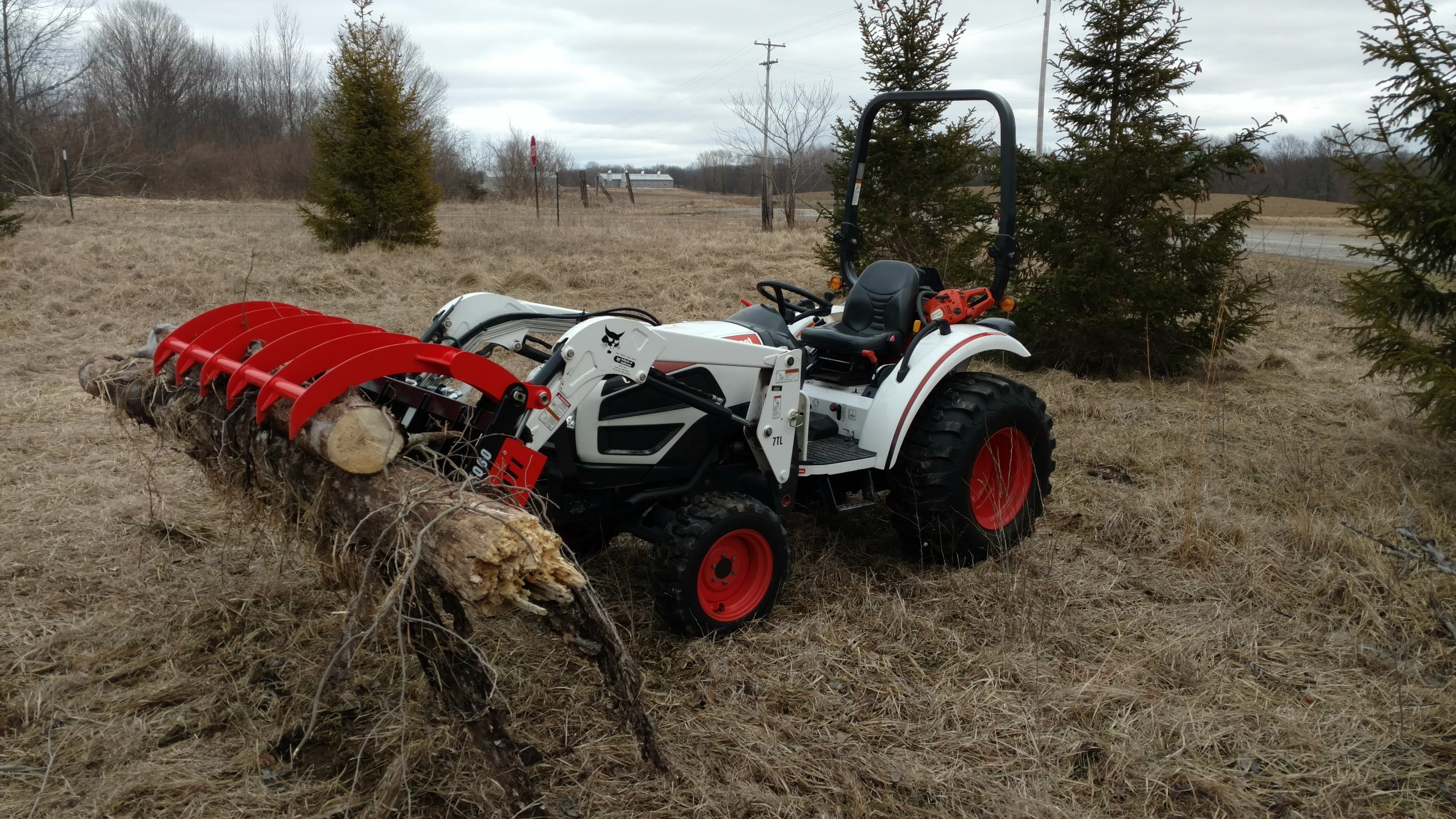

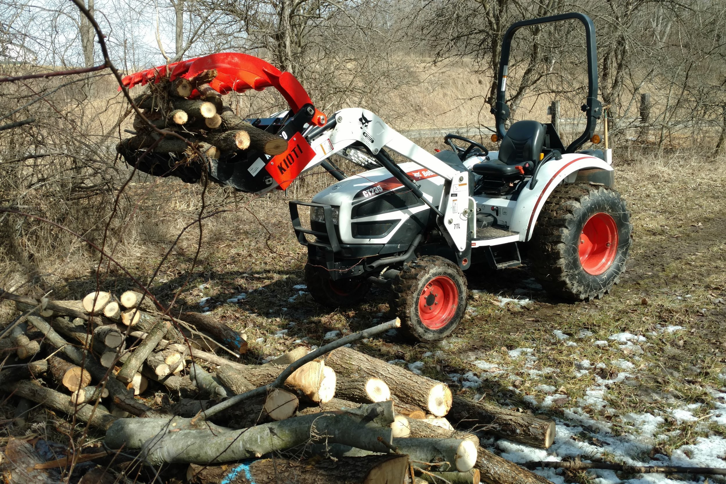

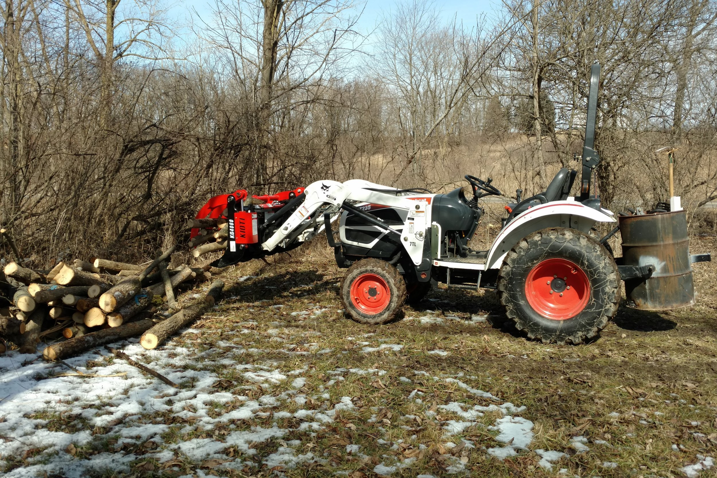

Other than some oversized brush this is what i have used the Grapple for. I did move some small rocks, but they fit inside were not on the tines.
