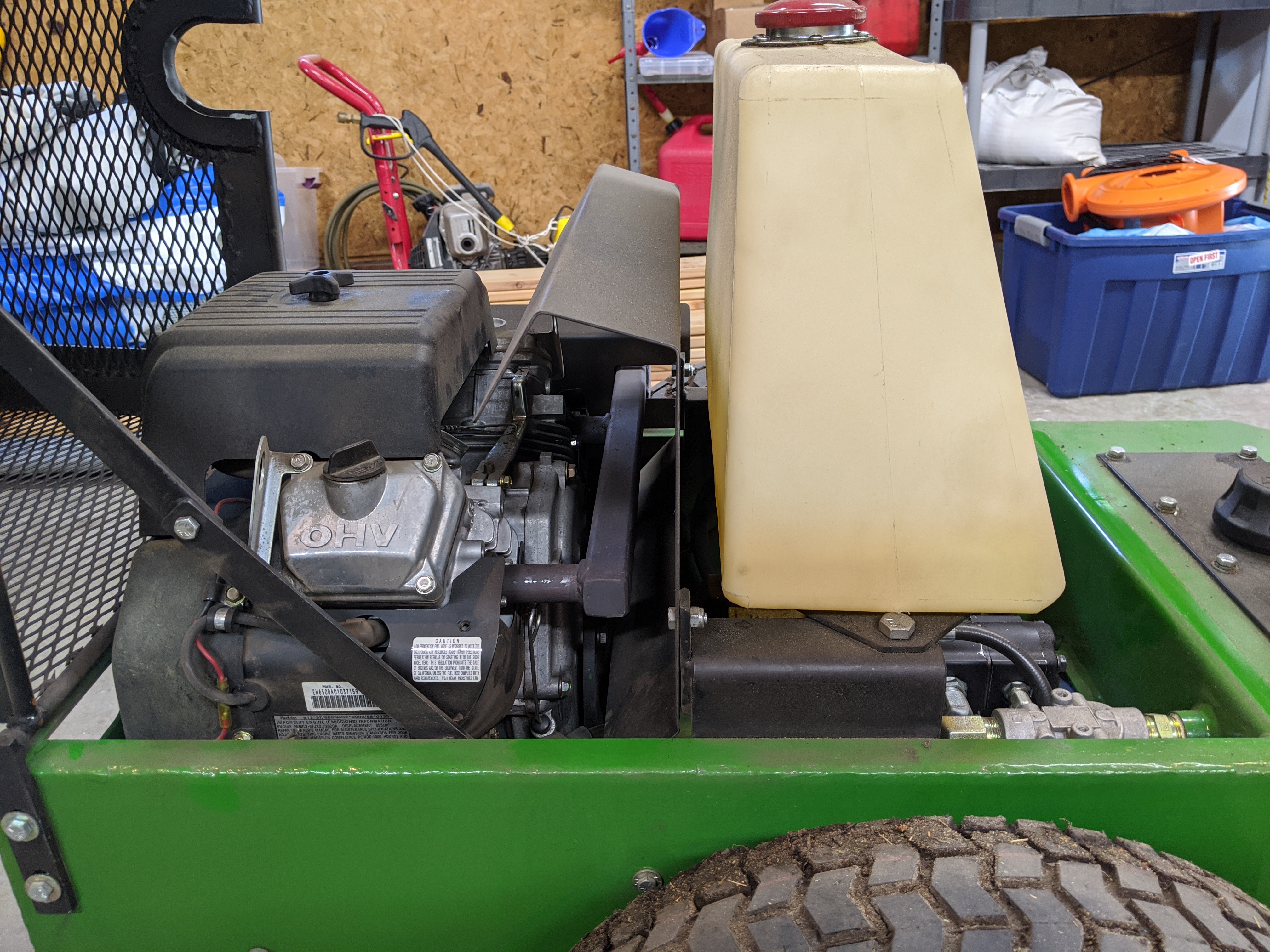

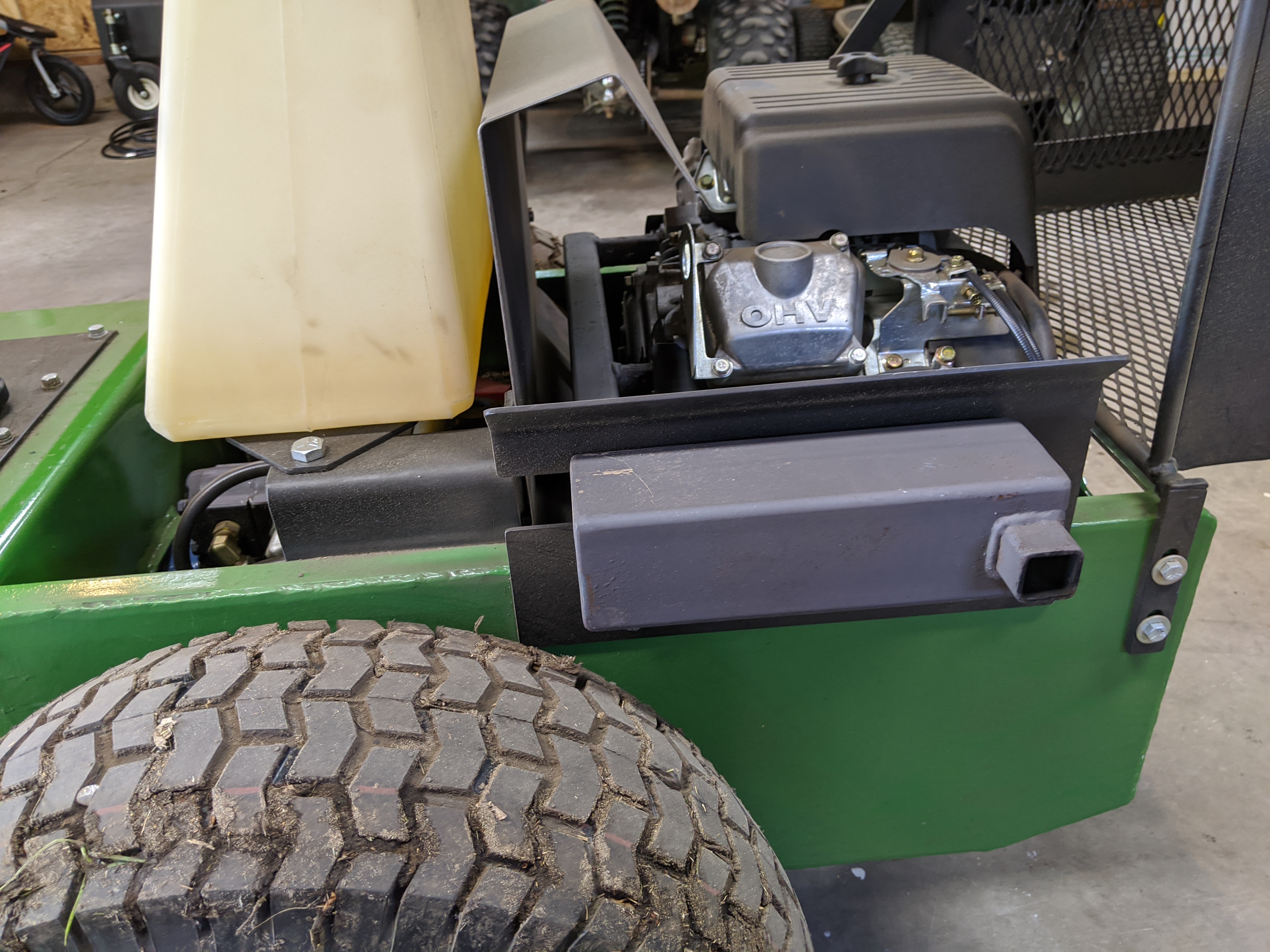

So finally got a chance to mow the entire lawn this weekend and really get a feel for it.
1. My serial number is like 20817 or 20819 (cant remember). But I am certain it was lower than 20822. So who knows what that means. The grippy tape on the foot pedal was just barely worn on the right side, perhaps this was a demo? I looked it over real good, if it was a demo I can't really tell.
2. Tightened that big center pivot nut with my pipe wrench. I wouldn't call it loose, but definitely turned a bit easier than I expected.
3. Using both feet on the pedals and it's much much better. Springs aren't necessary at this point.
4. Got the hour meter and magnetic temp sensor put on. Got an electrical fan, headlights and oil pressure warning light waiting in the garage. Going to just add a fuse block and some power upgrades for future expansion, so that will take some time. My dashboard is from a 422/425 with a plate over the Hour meter , lights and pto holes. I took that plate off and my hour meter fit right in the hole, and I need to bore slighly bigger holes for my fan and light switches.
I knew going into mowing that the PTO generates a lot of heat. I was watching my magnetic temp gauge and it hit 175 within ~45 mins of mowing. I feel like what I have read on here that 180 is really the max. So I just took a break and finished the rest the next morning. The steering is interesting, some parts of my yard require a lot of maneuvering. I tore up the grass in a few spots, but I think that was operator error. I also now see how you can get this thing wedged against a wall/fence/tree etc. as I came close to doing that a few times :). I'm curious how much a fan without a radiator will affect hydraulic temps. I'm also debating on the best placement of the fan. Current thought is on the right side, blowing air into the compartment and over the exhaust. Will be a bit of an experiment.
Ordered the wrong covers for my PTO quick connect, for some reason I thought it was 3/4 inch valves, but now I'm guessing its just 1/2. Going to measure next time I am there to be sure. Also bought some super-lube and a grease gun, as I am quickly approaching 8 hours. Overall I'm super happy. I keep asking my neighbors if they need anything moved around just come find me :).
