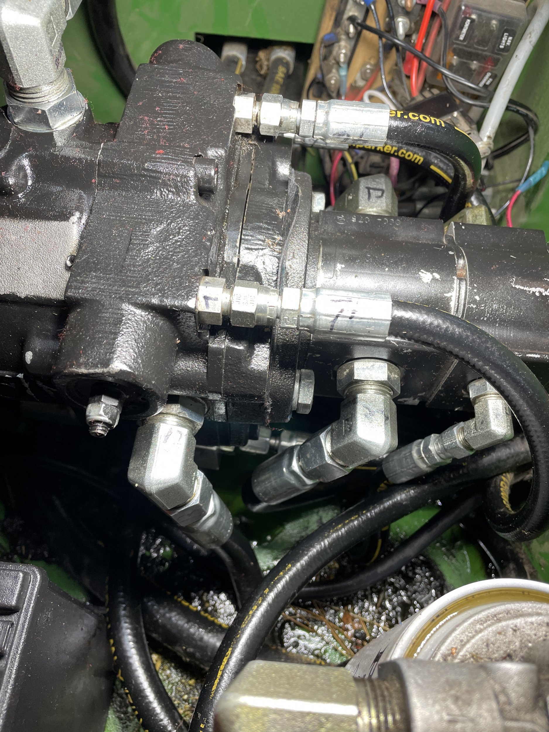

So some of you are aware that I have recently sent the Pump on my PT-180 back in to get serviced.
I got it back and was finally able to get up to my property this weekend to put the reman pump back in.
A couple hours later and I'm having some issues.
  • Pump is back in, all hoses are connected correctly.
  • Pump won't bleed (cranking and cranking, only air)
  • Bleeder hose has no pressure (stick my thumb on it, nothing....)
  • Decide to start engine. All hydraulics but Tram pump work fine. So pump shaft is turning.
  • when you hit the treadle, nothing happens, no nudges, no change in engine rpm, its like its disconnected.
  • Lots of cursing, kicking,swearing and inspecting the pump, I *think* the problem is uncovered.
I have a strong guess at what my issue is. I will be calling Terry in the morning here to have a discussion.

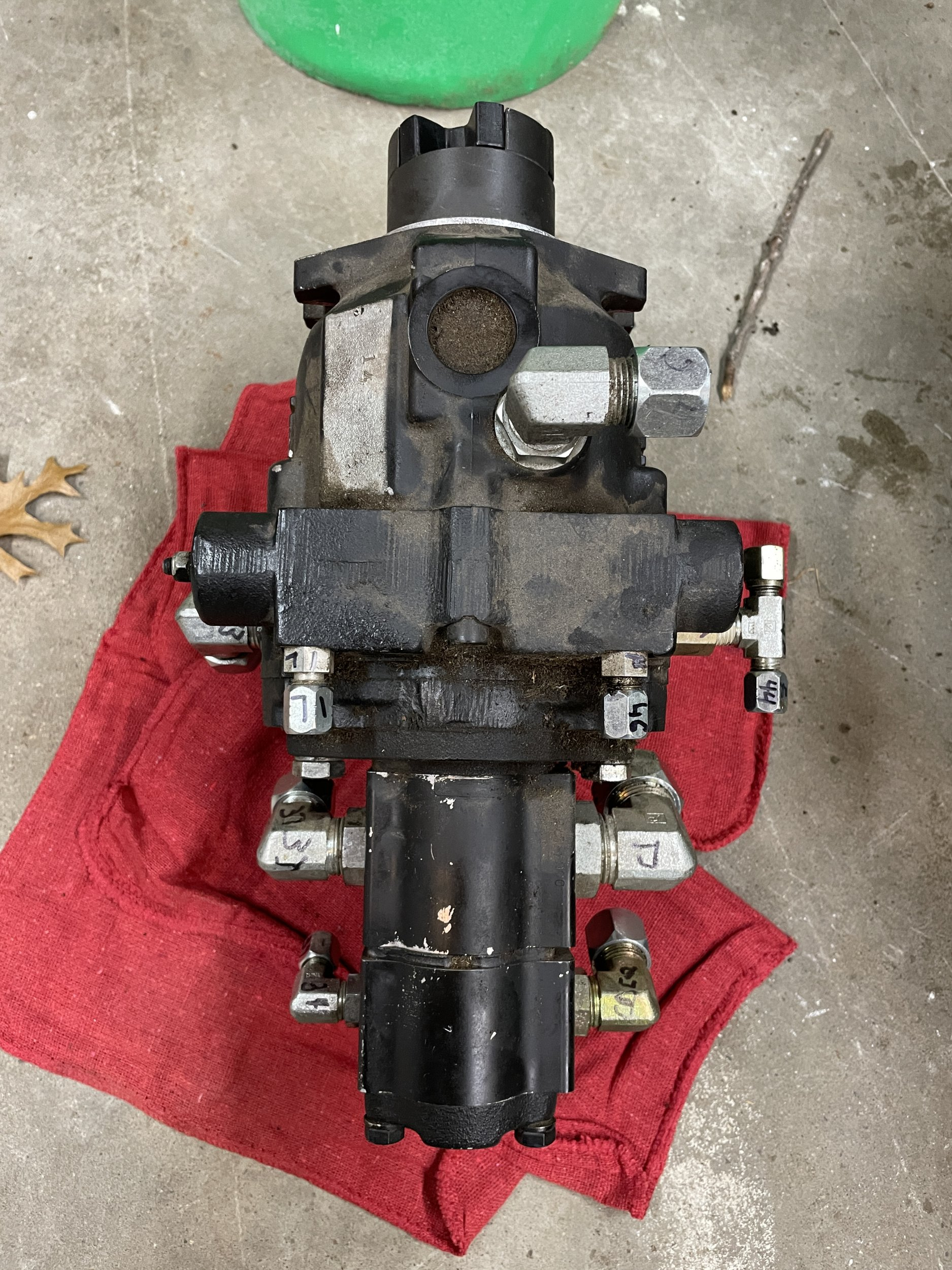

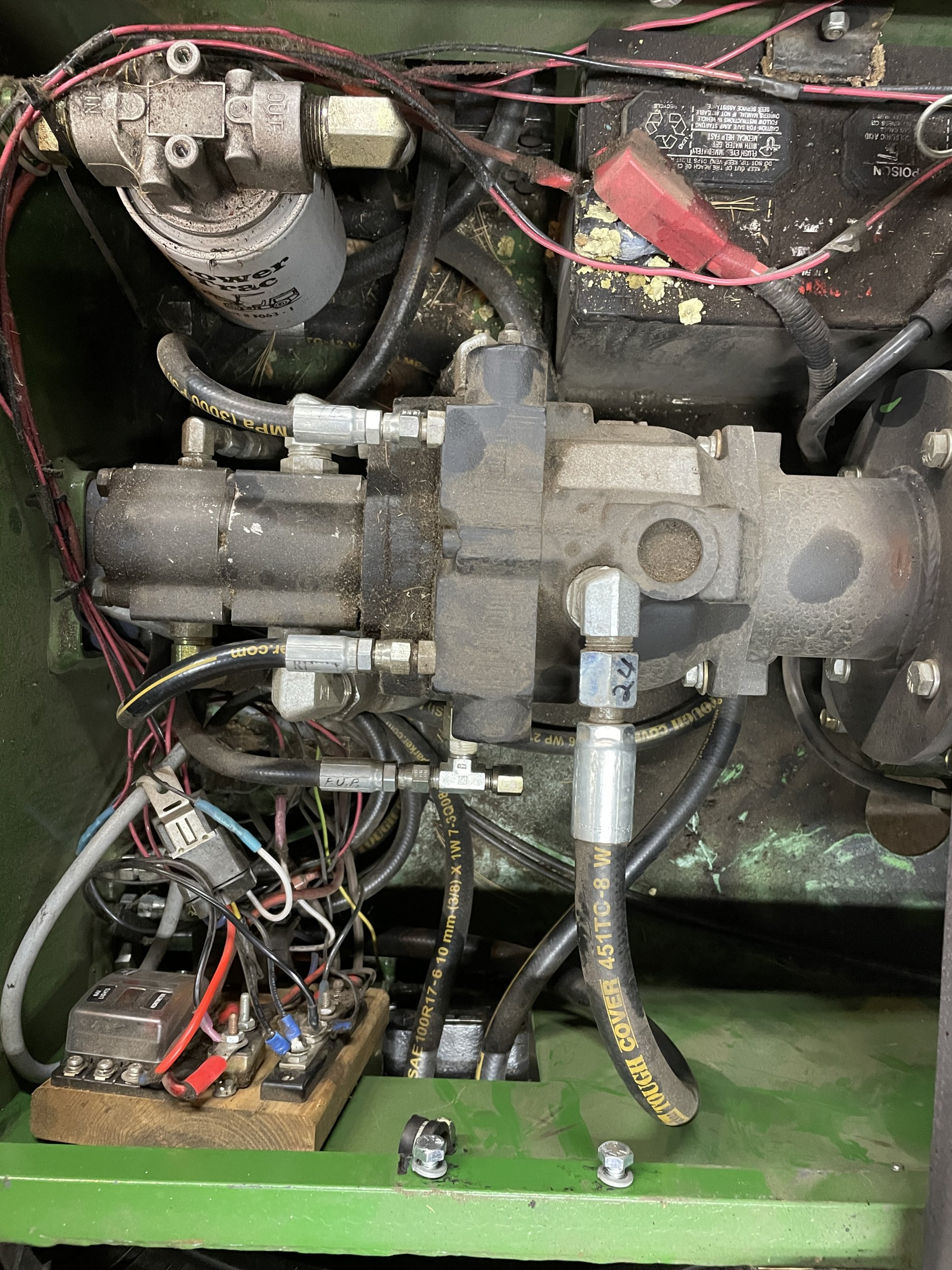

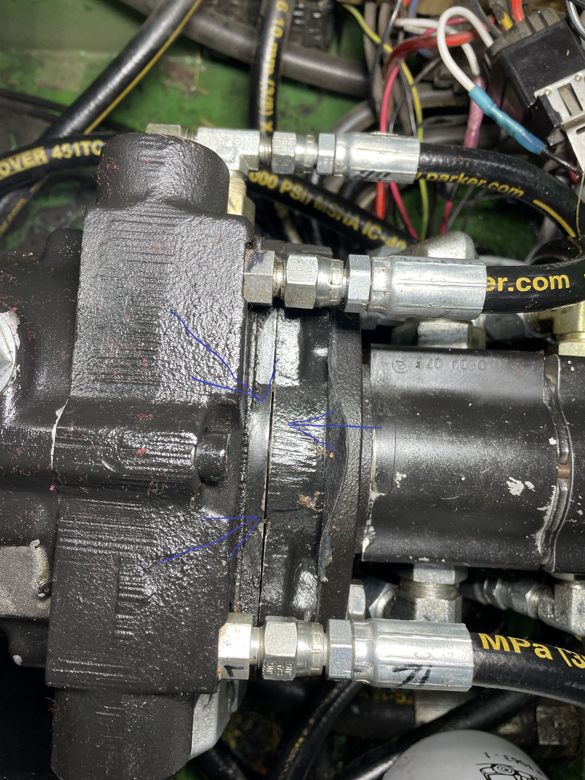

I have attached pictures of my pump before it left my garage and after it was re manufactured.
Anyone see any problems!??? (I am pretty sure I see the issue, but for fun lets see what you all come up with.)

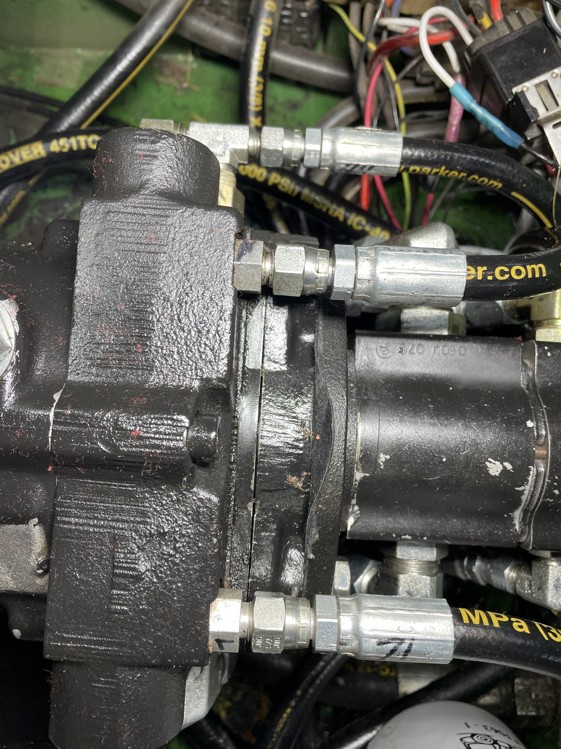

Do you see the open gap at the top of the "after" pictures. Notice how at corner the gap closes, but on both sides of it, the gap is open?
I believe that gap is showing me the internals of the pump. AKA that gap is not supposed to be there and beyond being totally screwed up, is not allowing the pump to develop suction. Sort of like how an engine can't develop compression if there is a large hole in the combustion chamber.
Can you edit the photo and put an arrow to where the area of concern is? I may just be looking in the wrong area, but in the four photos I am not picking up on a problem gap.

I just added a new photo. If you click then click again (to zoom) I think it becomes more obvious...
ahhh, I see. That's a part of the tram pump, not the space between the tram pump and the piggy backed PTO pumps, correct?
/ PT-180 Tram pump issues
#15
Yes, to me that is part of the tram pump. Now I feel like that should all be sealed up, but I'm not entirely certain.....
The smaller pumps connected further back (that each have a hose on the left and the right) are working fine.

In your fifth picture, I now see your area of concern. It does seem like you can see into it which seems...not right. I notice that there is a seal on the engine side of that gap, which leads me to believe that the area you pointed out should also have a seal, and in your great photo, you can see some ways into that gap.
If it were me, I would email Terry that photo, and explain your concerns.
If you are up for some non-destructive testing, I would pour some oil into the suction filter hose, and see if any comes out your gap.
